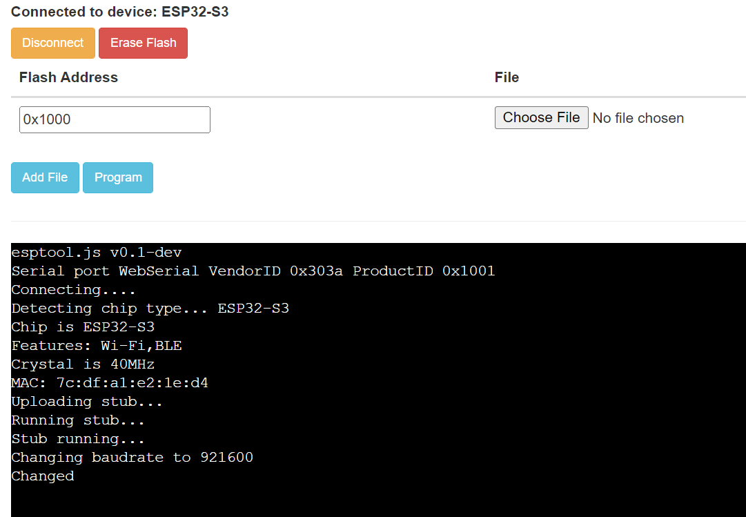

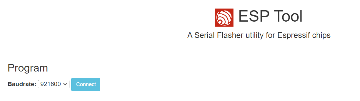

Under the PROGRAM heading, click Connect. Then click the dialog box that lets you connect over COMxx.
You should see some output in the virtual console which describes the ESP32. You’ll also see the option to add a file.

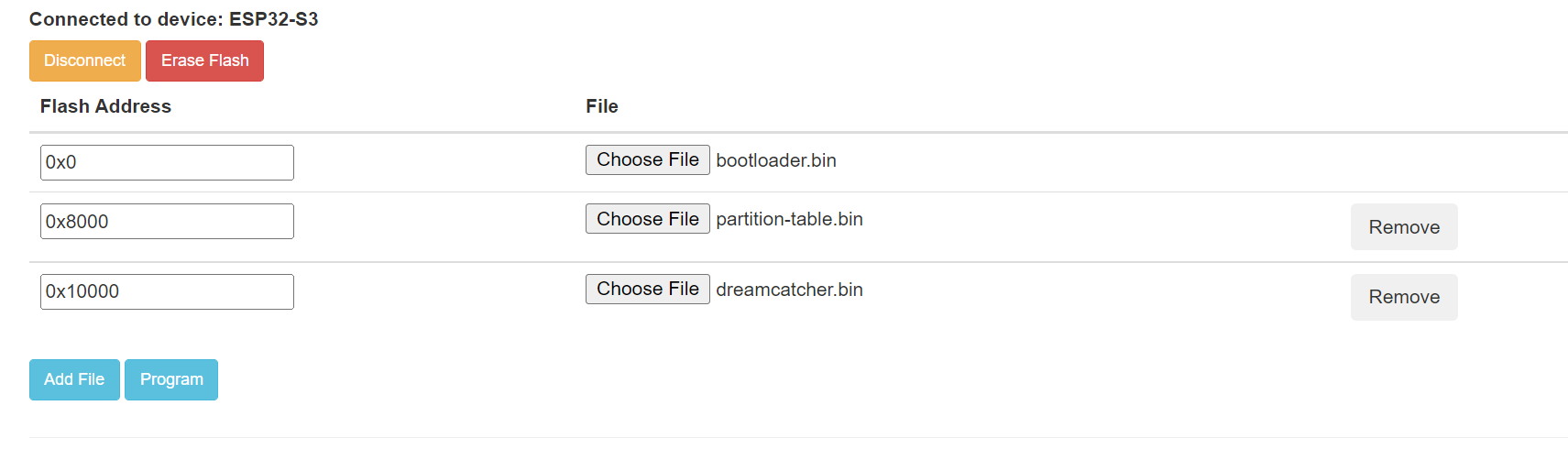

Click the add file button twice because you need to upload three files. The order of adding the files and changing the corresponding flash address. Then click Program.
It only takes ten seconds to flash the ESP32. Then just power cycle and you’re all set.

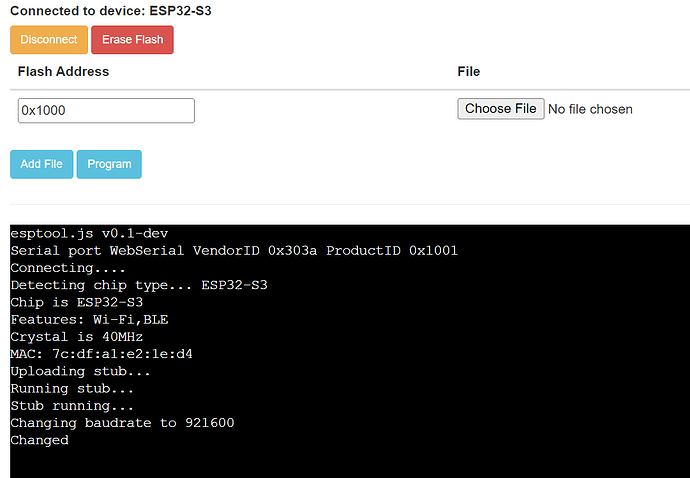

It almost worked. Here’s what I got: Now both lights are stuck on.
esptool.js v0.1-dev
Serial port WebSerial VendorID 0x303a ProductID 0x1001
Connecting…
Detecting chip type… ESP32-S3
Chip is ESP32-S3
Features: Wi-Fi,BLE
Crystal is 40MHz
MAC: f4:12:fa:dc:73:70
Uploading stub…
Running stub…
Stub running…
Changing baudrate to 921600
Changed
Compressed 145648 bytes to 26384…
Writing at 0x0… (50%)
Writing at 0x4000… (100%)
Wrote 145648 bytes (26384 compressed) at 0x0 in 1.077 seconds.
Hash of data verified.
Compressed 145914 bytes to 26385…
Writing at 0x8000… (50%)
Writing at 0xc000… (100%)
Wrote 145914 bytes (26385 compressed) at 0x8000 in 1.484 seconds.
File md5: 3d772ad6bb3960a5dd128ec4b24725e3
Flash md5: b22c9e14c79decd81bc351861c3a071e
Error: MD5 of file does not match data in flash!
I tried it again. Bootloader and partition load OK, but it gacks on dreamcatcher.bin.
Wrote 145850 bytes (26437 compressed) at 0x10000 in 1.013 seconds.
File md5: fc8bcab8ea86c3216bc82e4ad4544376
Flash md5: 0af43cd27fc9fe7a45d60a5dca1ce72d
I GOT IT TO WORK!
Somehow I had a bad/wrong version of the .bin Back to reset now. Thanks!

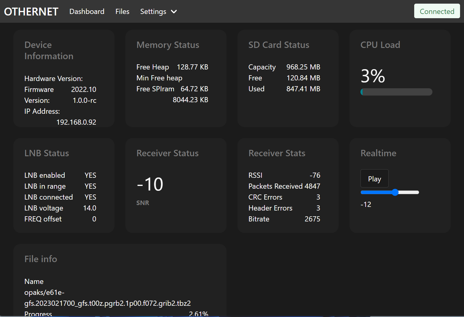

- connect Dreamcatcher (hardware 2022.10, software 1.0.0-rc) to the green port of Bullseye LNB (now shows “LNB connected: YES” in the interface).

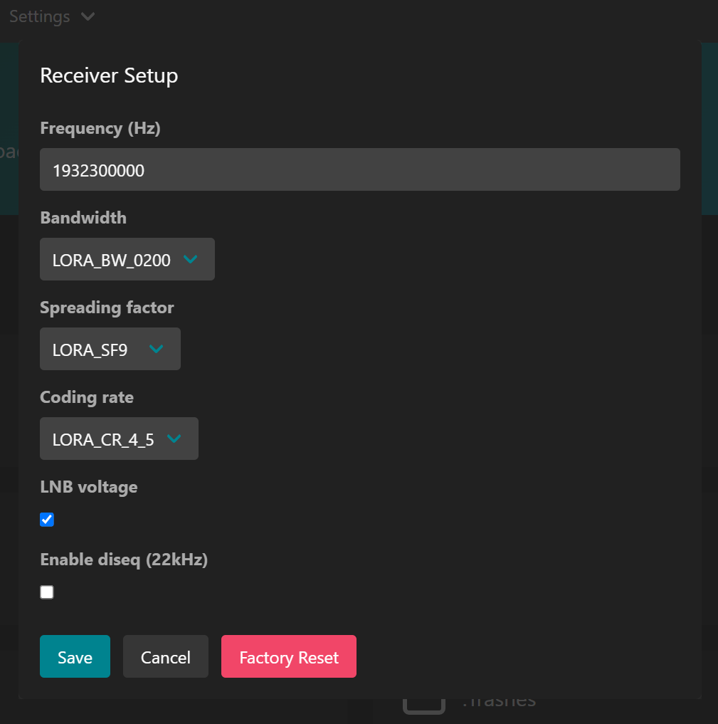

- in Europe: change frequency to Astra 3B beam (11 682 300 000 carrier - LO freq (9750 MHz) = 1 932 300 000 Hz).
- use dishpointer.com to find proper azimuth (I got it completely wrong the first time somehow - either smartphone compass was way off or aiming at the old satellite).
Just “aim between those two houses about 35 degrees up” worked well.
Started seeing SNR on the order of -15 to -11 and “packets received” was counting, little CRC errors. No files received though. - put a micro SD card in. Only then did it start receiving files. (“File info” box showing name and progress, CPU usage went above 3%). SNR was about -11.

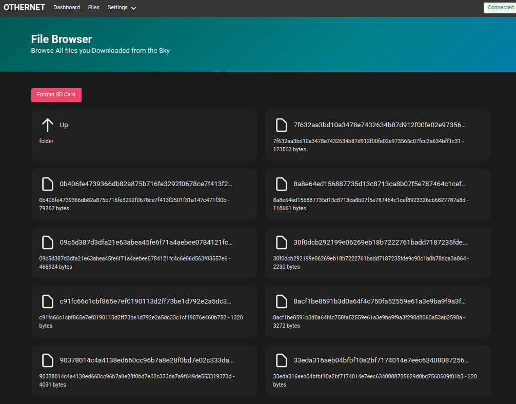

Files seen as hashes under “Files” tab (hashes instead of filenames, 404 on clicking on them, looks same as iw0hjz’s comment above).

Nah, my Files tab looks like this.

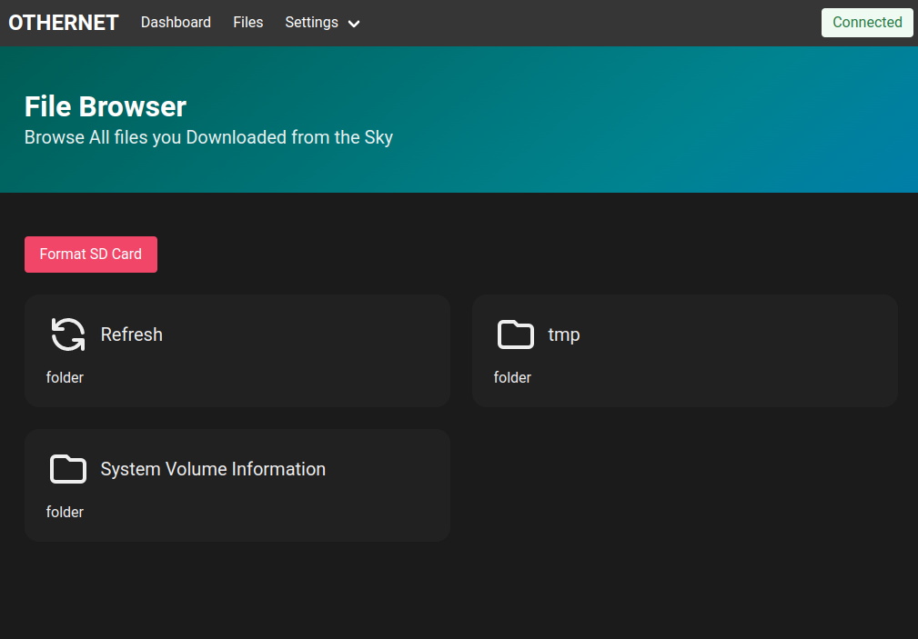

Got 350 files (and counting) in tmp folder:
I took out the microSD card and tried file and then bzip2 on a linux laptop, it says the files are broken.
user:/media/user/0021-0000/tmp$ bzip2 -t *
bzip2: e23b142f7fb621490be44bcdac6acb6e9601fb7618b2d3caa228328611210781: data integrity (CRC) error in data
bzip2: e25b768ad57367675fbae60d7871d4e3f65c57dc31f7515d1785edbf45331d46: bad magic number (file not created by bzip2)
Clicking “Format SD card” had no effect.

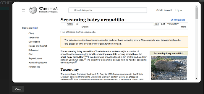

Got something working! News folder appeared and there are a couple of files. (Still some files seemingly stuck in tmp).
The one with a name in Arabic doesn’t open (“Filename too long”), but files in English work!
URL that produces “Filename too long” is http://192.168.0.92/files/News/2023-02-16.عربي21.زلزال%20تركيا%20يحدث%20حفرة%20بطول%20300%20متر%20في%20ولاية%20هاتاي%20(شاهد).html
I figured that URLs shorter than 268 bytes produce http 404, while longer ones return error 500 with “Filename too long” in the body.

Do my receiver settings look right? (I’m in Europe, using Bullseye LNB).
Yes, that looks fine. What is your current SNR and how many CRC failures do you get?
SNR around -11, few CRC and header errors.
I’ve gotten 15 news html files overnight (all smaller than 7kbytes) and about 130 new files in tmp (some as big as 300k). Is it working as intended for now? Do grib files stay in tmp for now?
