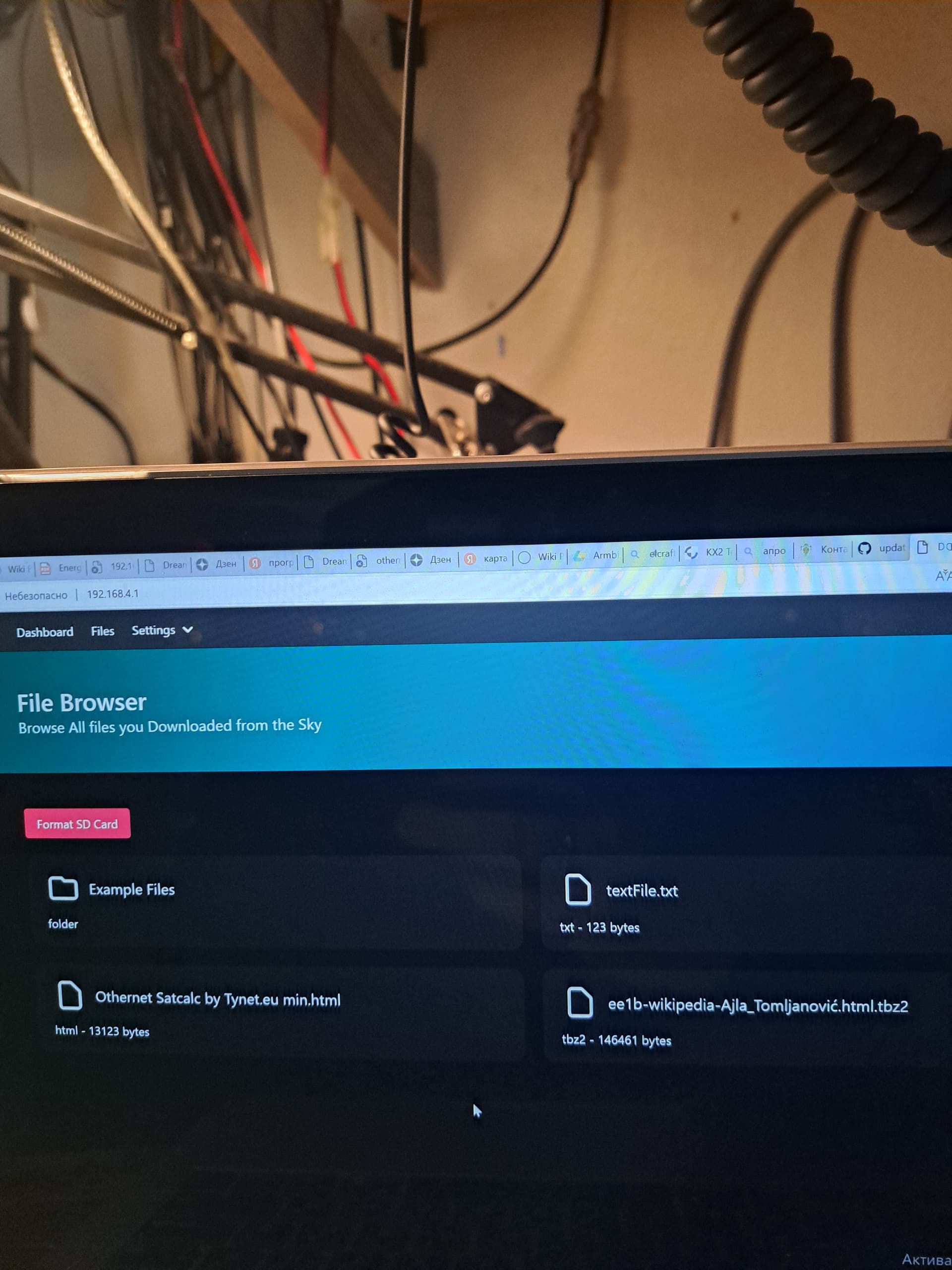

ok, just update… lot of files in SD storage and now?
how can I open them?
ok,I see that is the temp folder…so going up there is a news folder… with html page , one for each news… good for now…hope in a html link page for all the news.

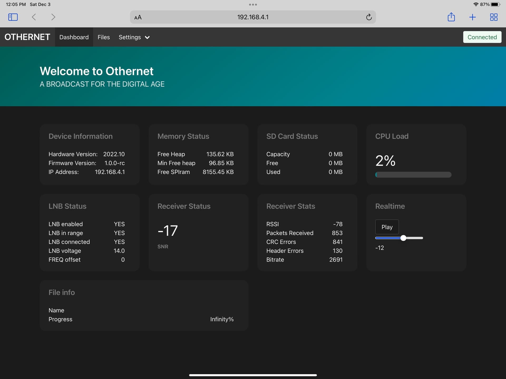

I tried with the 33 degree Elevation, but it is not receiving any data. I would like to know how to debug this and make it to receive the data.
Here is the screenshot:
Thank you

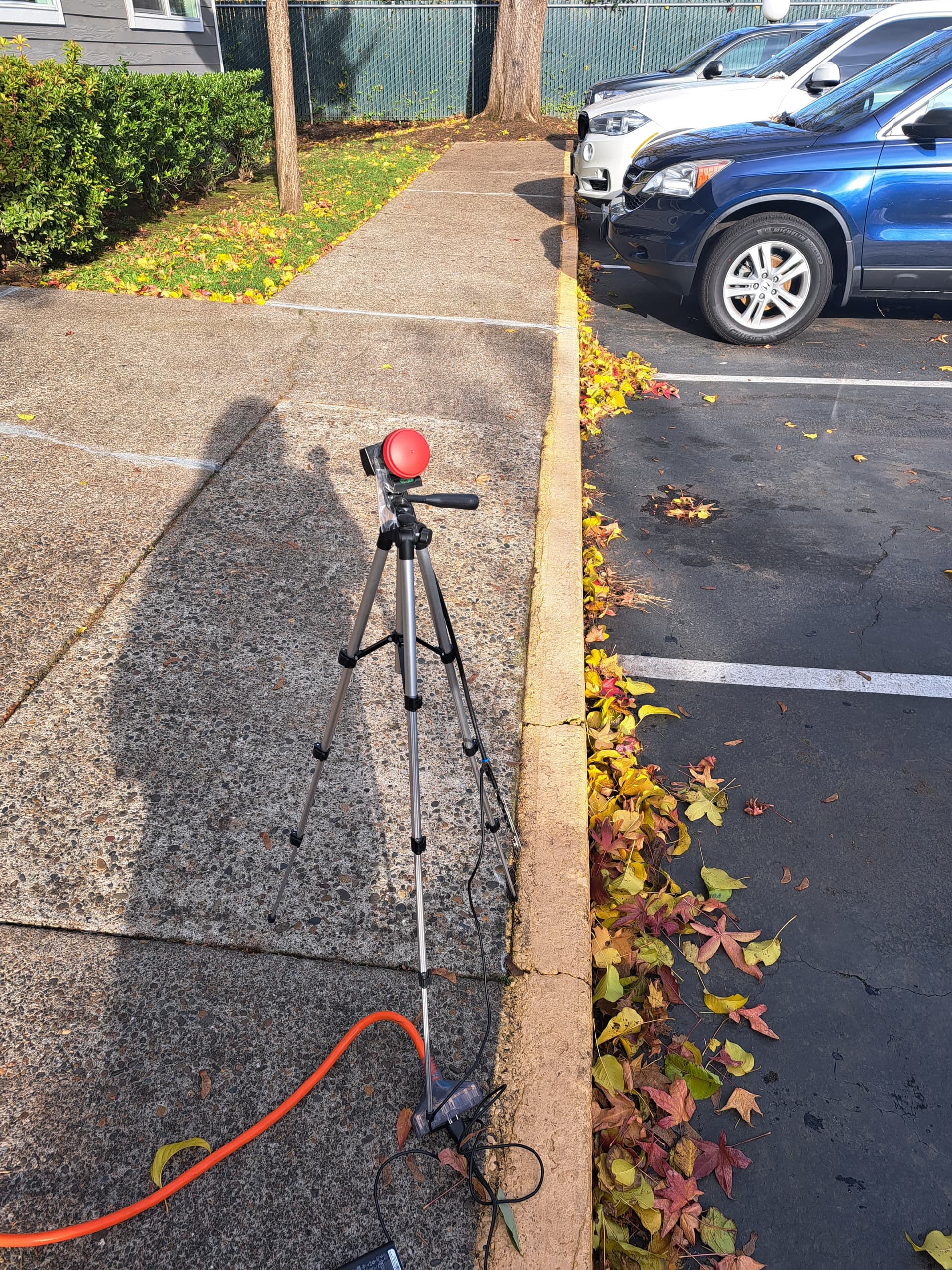

Based on the maps at Satbeams, your received signal strength is about 4 dB worse than mine in Chicago. You may need to fabricate a little horn to grab a few more dB, but let’s learn more about what you are doing first.

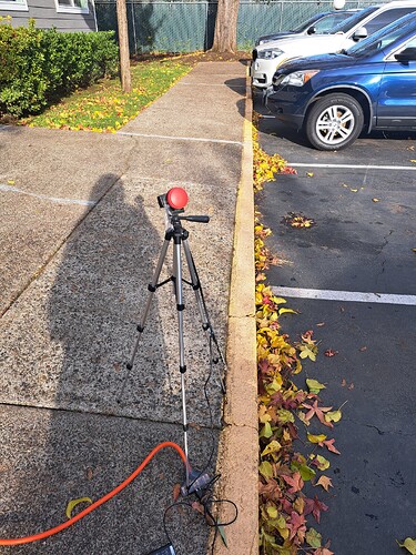

Can you post a picture of how the LNB is being held in place?
-33 degrees is just a small turn to the left. You should be able to eyeball the elevation angle, as the beam width of the LNB’s horn is pretty wide. Your bearing should be southeast. Is that how you have it lined up?
Is there anything blocking your view of the clear sky?

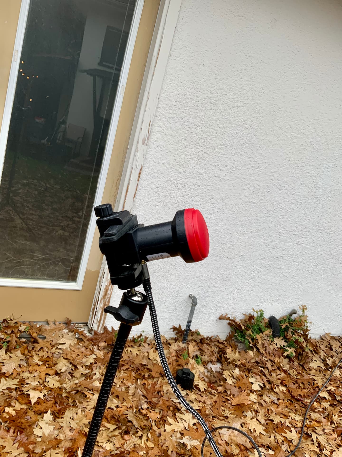

@6lat2012 - Thank you for posting your LNB pictures and screenshots, appreciate it.
Just a quick question on the Skew angle, did you happen to rotate the LNB’s head to the desired Skew or did you leave it as it was?
Thank you
Mallik
There appears to be a misunderstanding about the skew adjustment. It is not made by rotating the red cap, which is merely a cover. The LNB should be held by something clamped around the 40mm barrel between the head and the connector housing. To set skew, one must rotate the entire LNB by loosening the device that holds the barrel and by turning the entire LNB slightly as Syed stated.
To set the Heading (Mag), you need to use a magnetic compass and point the body (red end) of the LNB in the direction indicated, as example, 117.9 degrees.

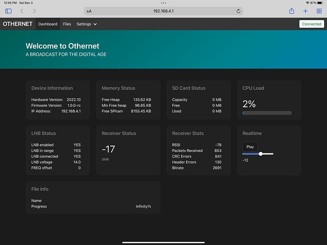

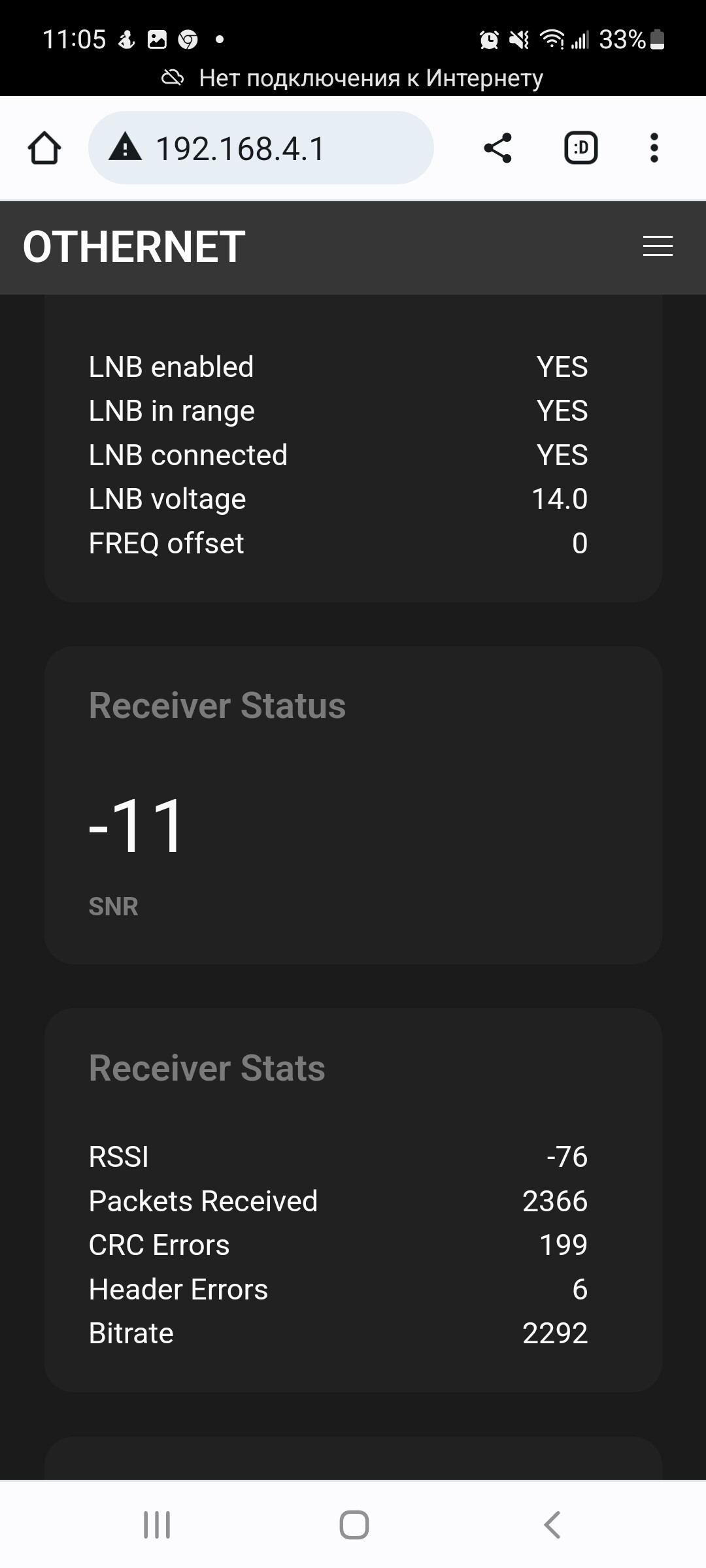

The below screen shots are with an elevation of approximately 35 degrees and facing the LNB towards SouthEast.
The Dreamcatcher started to receive data, but it showed lots of “CRC Errors” and “Header Errors”.
Note that it was raining when I did this experiment.
I am waiting for the rain to stop and sky to clear then I will try again by setting the LNB set to right heading, skew and elevation and will post the results soon.
Here are the screenshots:
It works! The rest is just a matter of adjusting the pointing or adding a horn/waveguide extension.

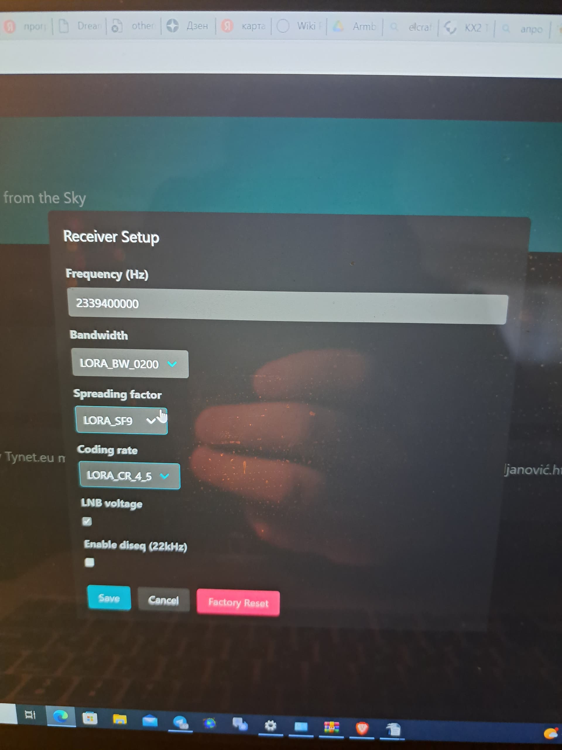

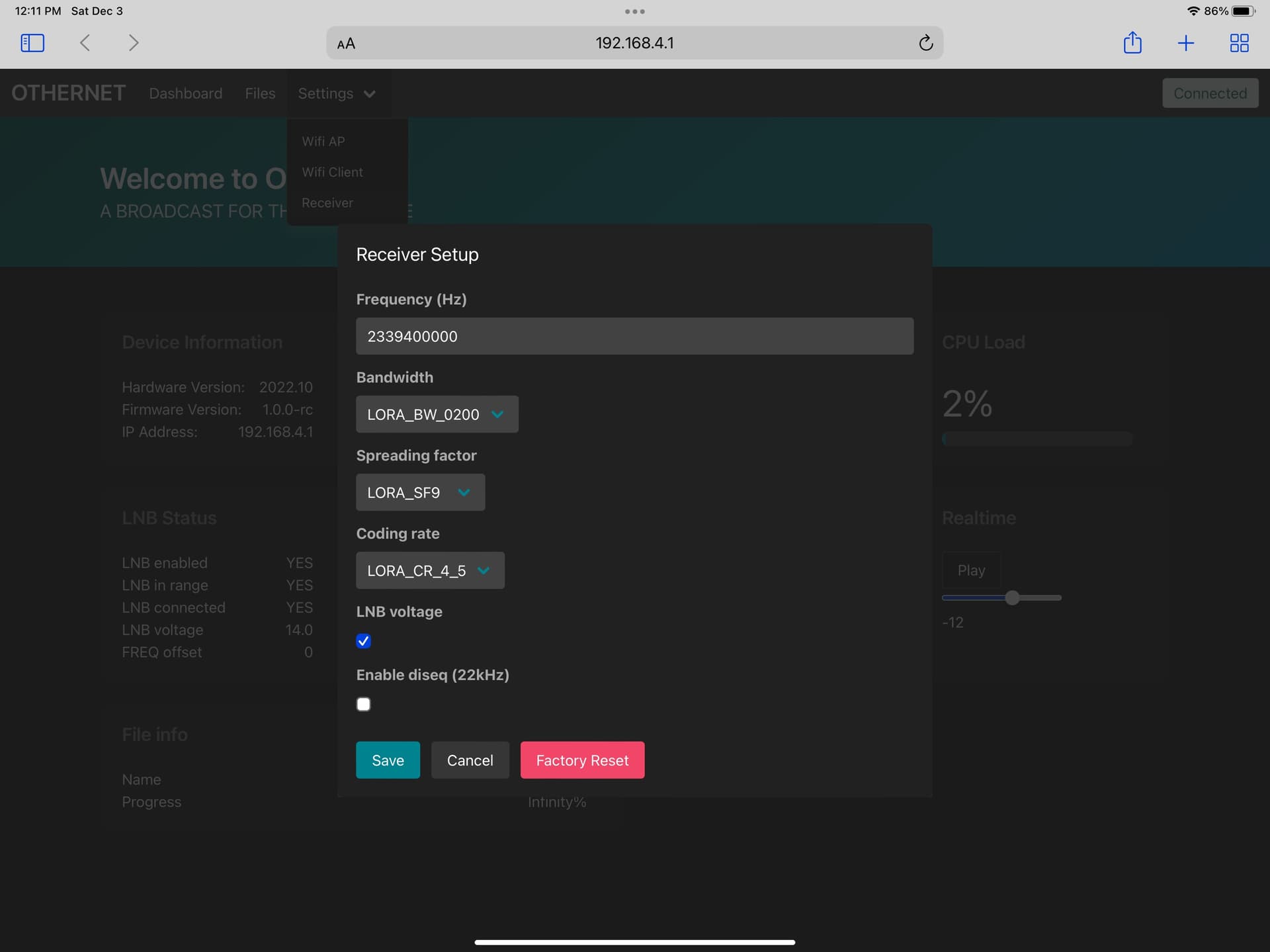

Is there an easy way to factory reset the 2206? I think I typed the password wrong when I joined my network and now I can’t get back to AP mode.
