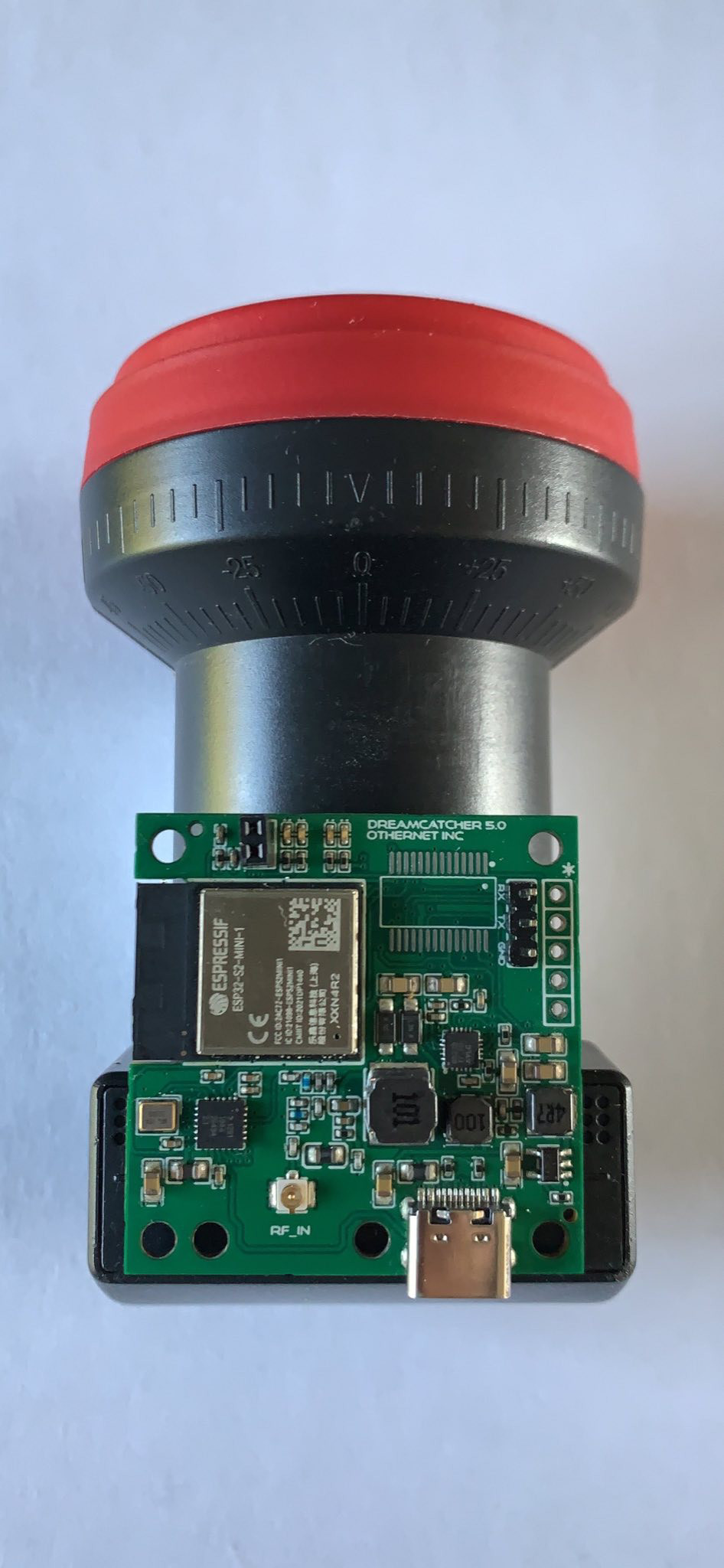

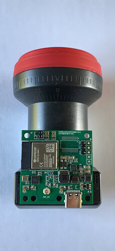

Does the pcb placement still allow for a standard 40mm lnbf bracket ?
i think the image with the pcb on the LNB is only to show the size of the board in comparision to the LNB
And here I thought the DC4 Protoype was small⦠

Progress is slow. Here is the latest schematic. There are a couple of serious flaws in it, but those have been corrected (a misplaced resistor off of the USB-C and the lack of 3.3V going to VBAT_RF).
We think the source of the problems is related to the TCXO. Thatās getting swapped out pretty soon. The LoRa device is responding to the ESP32, but we arenāt able to receive with it. This isnāt a show stopper. Itās just time and work to solve the problem.

I forgot to update this thread! The problem was completely related to a poor quality TCXO. An Epson TCXO was swapped out and everything works as it should. Now time to update some software and wait for the new leases to get signed.
