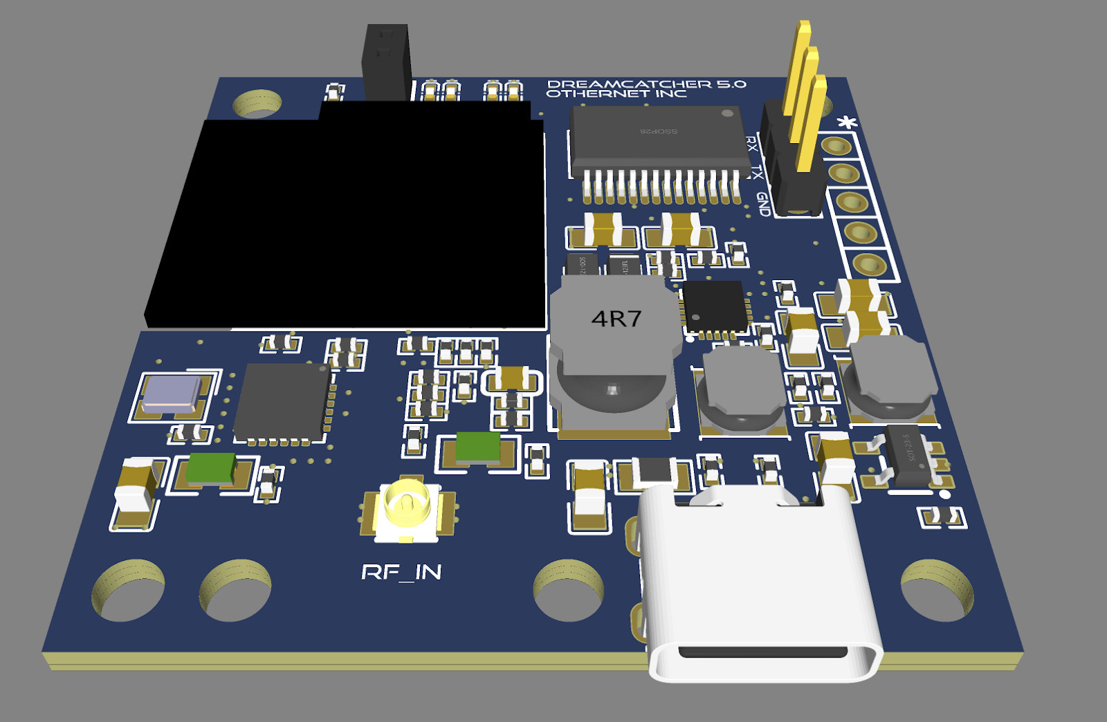

Dreamcatcher 4 was a failure. Fortunately, @MWAVE_JON had pity on us and took over on the redesign, which is Dreamcatcher 5. The board is 40mm x 40mm and is intended for use with a dCSS LNB, which will be provided in the kit. For Lantern, the dCSS LNB and Dreamcatcher will be integrated into a single enclosure. We’ve already confirmed reception with a dCSS LNB, which allows removal of the mixer and LO that was on Dreamcatcher 4. The new board is much simpler, since it’s just an ESP32-S2-MINI and Semtech SX1280. There is nothing in between the RF connector and the SX1280.
Another change is that USB-C (over a USB 2.0 interface) will be used instead of a microUSB connector.
Prototypes are being ordered today.

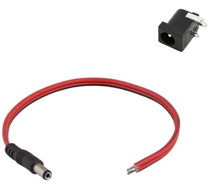

I think this is similar to the answer we received when we asked, “why micro USB instead of coaxial (round) power plugs”. Coaxial power connectors still will carry more current than either USB micro or USB-C, remain the industry standard (in the last year, I have purchased at least six NEW items that use them). Not fighting progress here, but if all we are doing with the connector is supplying power, it seems a little silly to step backwards to connectors and cabling that aren’t capable of carrying the load, remembering all the charging cable problems we have encountered. Is using USB-C a guarantee that we will no longer have the problem of cables from the connector that won’t carry enough power to operate the equipment?
You are correct about the simplicity and power handling capabilities of standard RG6 cable. But the downside to that option is that there is no wired, data interface to the board. Although only a small minority of users will have any interest in modifying the firmware running on the Dreamcatcher, offering USB greatly simplifies flashing. It (USB) also allows the Dreamcatcher to become a USB peripheral to a PC.

Will this new board be less costly after fully developed and ready to purchase? Current draw? What is 4R7 on the board?

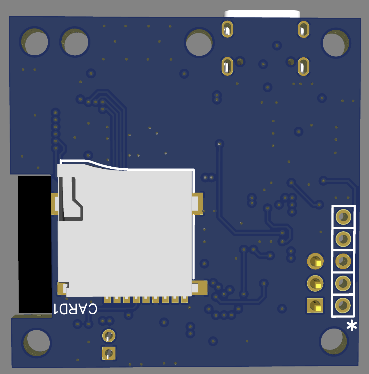

Is there going to be a micro SD card slot on the board for extra storage?
Yes, it’s on the bottom of the board.

4R7 is a Power choke but is actually 100uH as it forms a master impedance for Diseqc comms to the new DCSS.
Power consumption will be more than the older units as the DCSS has a beast of a SOC inside and isnt a simple universal, that said its stuffed with DC_DC converters and has active power management features. At the moment we are still discussing the setup of the LNB and the power management/comms to the LNB. We have added a 5V to 3.2V DC-DC (Pushing the Vmin of the IC’s to save power) plus enabled the SX DC-DC to reduce the power. LNB’s are being shipped to me in the UK for primary configuration and then Ill post them to Syed, once we are happy we can flash the product in China. The Boost for the LNB still exists and does not require the voltage to be changed for the DCSS, Bullseye still needs the 13/17 to switch polarity.
