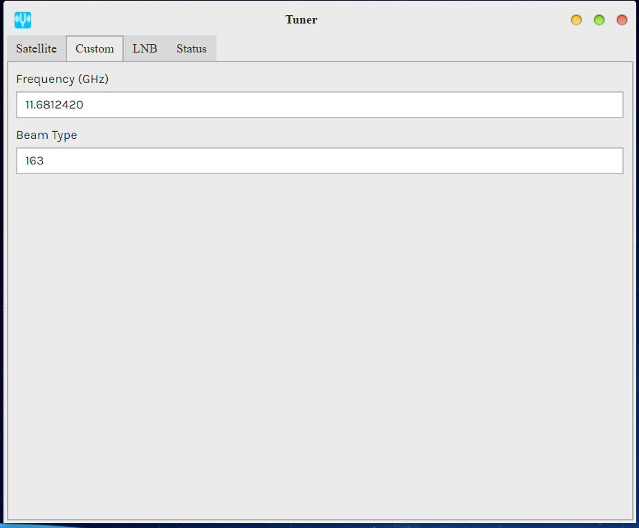

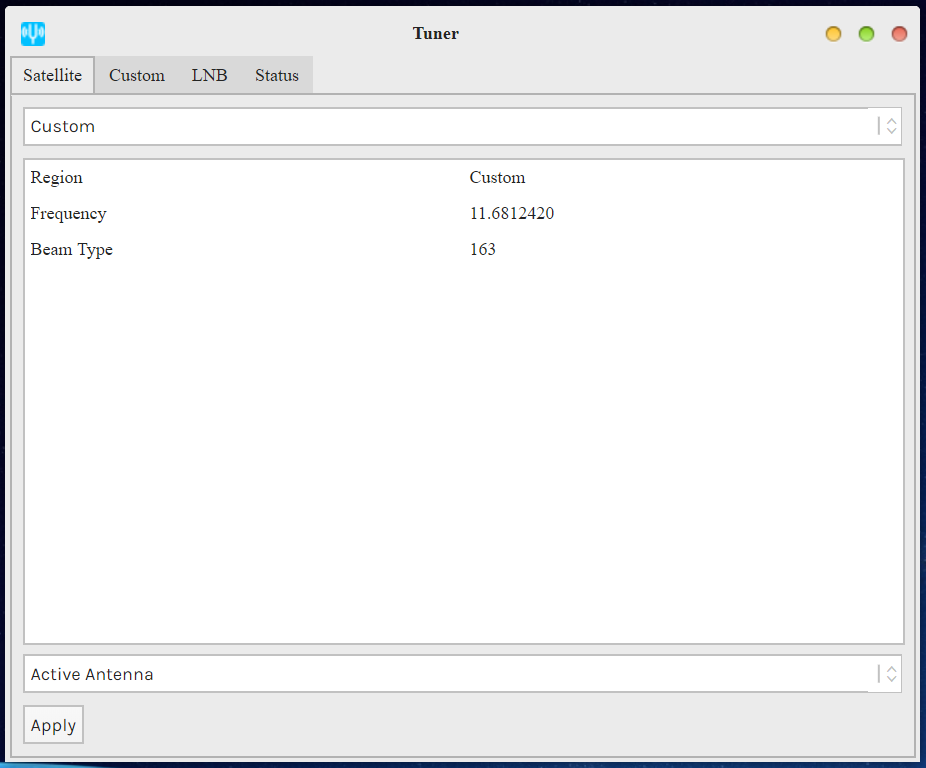

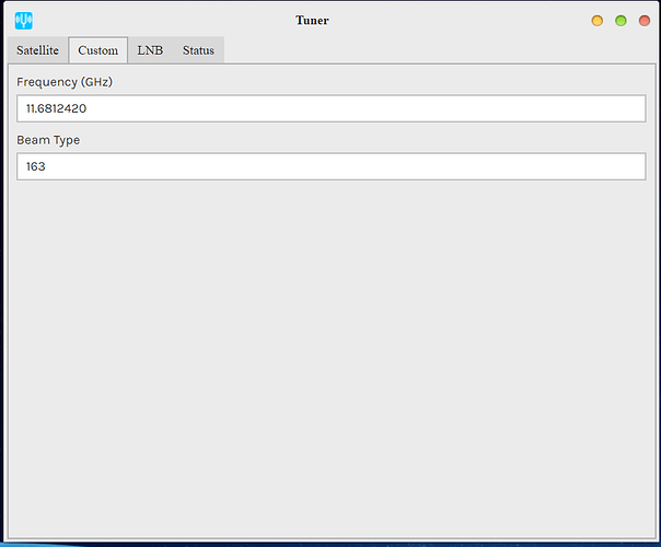

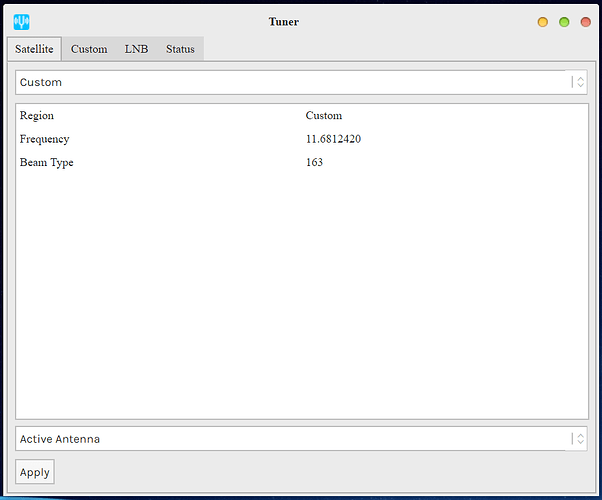

@Tysonpower Thank you so much for this tipp! I changed the frequency and now I finally have a signal. Seems I made the same mistake.

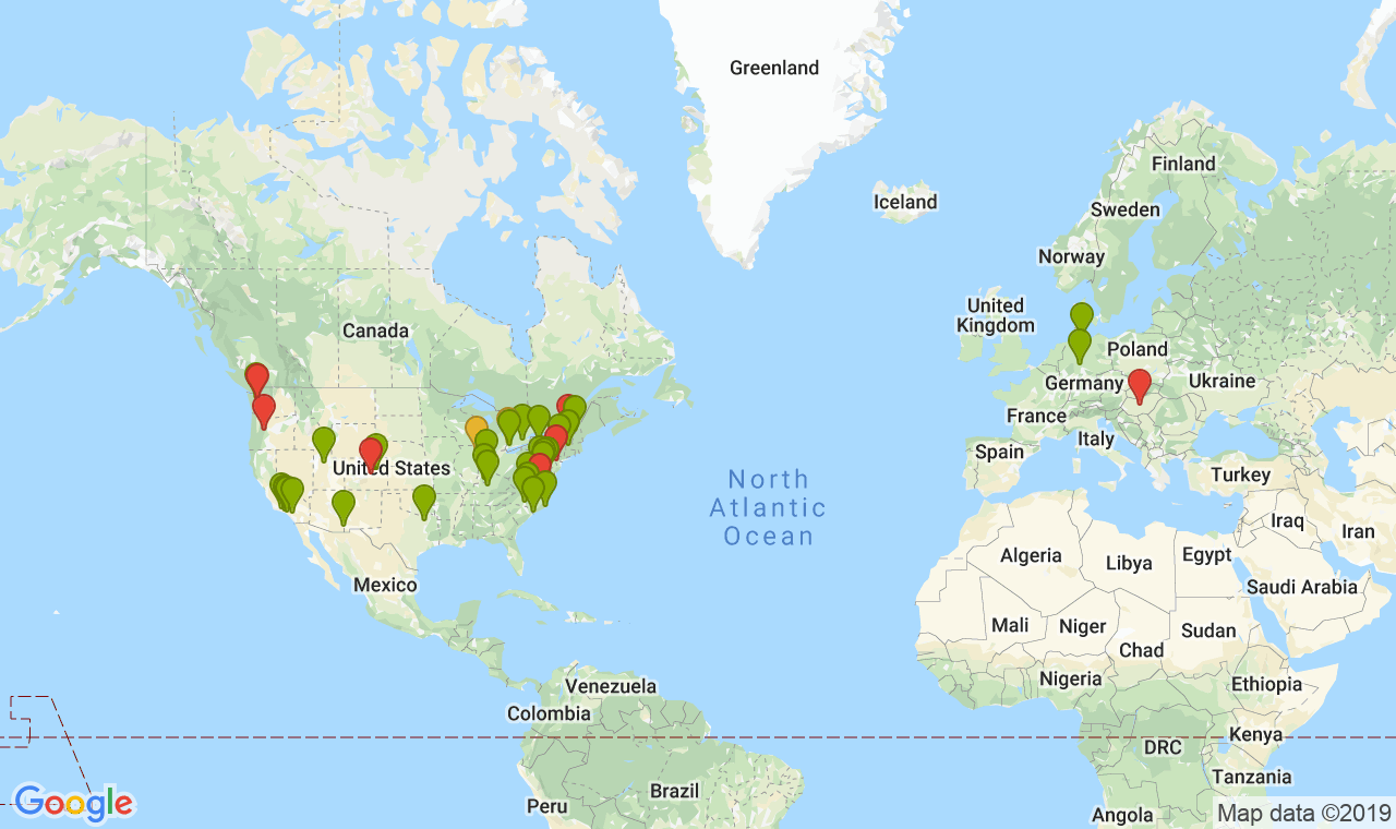

three green status balloons in europe on http://status.othernet.is/
13:30 edt 7/15/2019
at least on the snr map
good job
hahaha it’s such a stupid mistake, but you just don’t realise it xD Happy it helped!

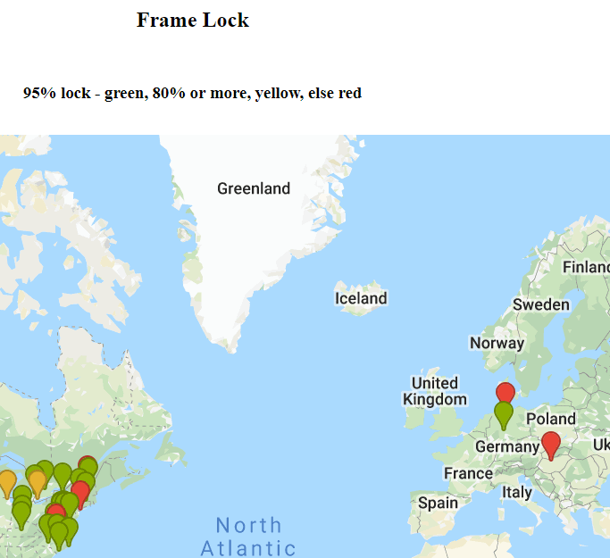

I’m the only one with a green frame lock in the EU, feeling a bit lonely :stuck_out_tongue:

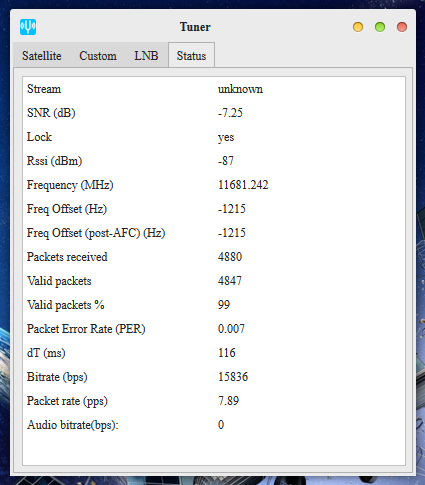

I just dug out the very first LNB I bought as a template for the design of my tracking device and it works much better than the Maverick and my new Octagon. Seems I have a stable lock with it now.
SNRs of -7.25 dB sound low, but really are not a problem. The threshold of lock is around -13 dB of SNR.
Parabolic dishes and cones improve the SNR, but still values around -10 dB work fine. With a -7.25 dB, you’ll be well locked! Ken
Note: Higher SNR’s (above -6) won’t increase bitrate. We are broadcasting at 16kbps.

I also tried 3 different LNBs with very different results. With the one that came with the Dreamcatcfher I had no signal at all. A new one I specially bought was very bad and the best results and a 100 % lock I had with the cheapest one I could find. It is a SatConn High Performence SHQ-101 Single LNB, which is available on ebay for 5,55 €. And at the beginning I set the frequeny wrong. When I couldn’t get a signal I also startet wondering if my Dreamcatcher was faulty, but it really took me some time and a tip from Tysonpower to figure out how to set it up properly.

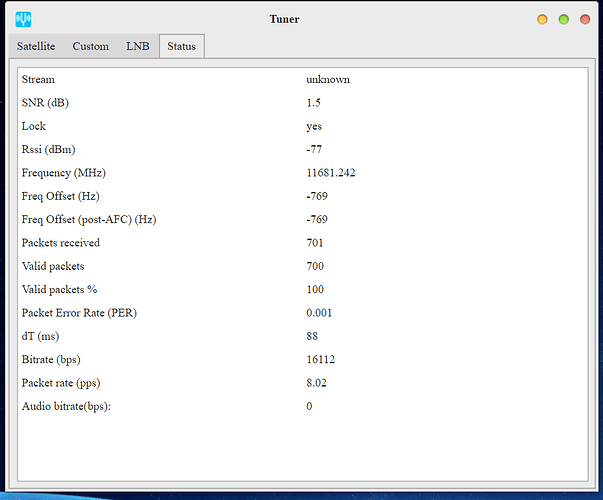

Fixed !!!
So slowly i went back on roof for the dish , and i took a direct line to one stb tuner on 23.5 to be sure.
Then i swapped with the DC , and no signal , seems there is bad contact with the LF->LNA adapter…
I make a cable by my own LF - > LNA and now i have signal …

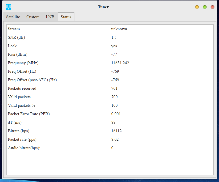

SNR : 1.25 db
RSSI : -77 db
:slight_smile:

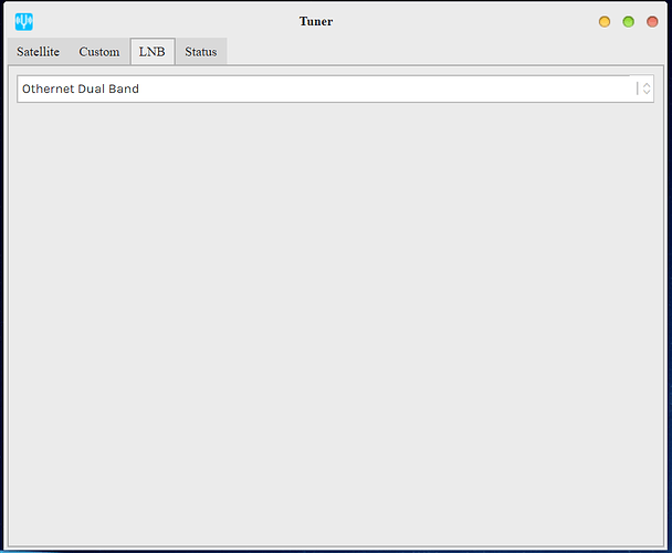

Here is my setup & signal debug info.
I use LNB universal ( not the MK1 shipped with the Dreamcatcher ).

Nice! So it was a cable/connector failure. Well that happens :slight_smile:

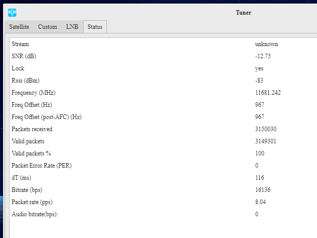

Decoded over 3 Million packtes with the LNB indoors :slight_smile:
