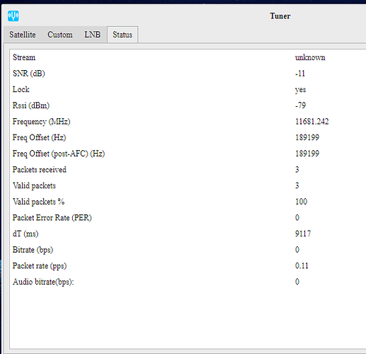

I’m not getting anything in the status window (Tuner settings are OK)…according to the logs though it’s detecting the LNB and the voltage is about 14v - I have got it on a 5M USB lead…i’ll go and tweak that for now.
I’ve even tried with the LNB outside the window.

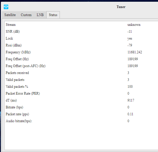

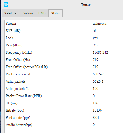

The maverick is worse then the Octagon OSLO, but it works. Still inside, looking trough a window.
OSLO:
Maverick:
The offset on the Maverick is quite large and it could be that the receiver is completely missing the carrier. That’s one of the reasons for the Othernet LNB (and a TCXO LNB we are coming out with, but that’s a different story).
Got a lock!..had to dangle the LNB out of the window!..WOuld like to head outside but it’s chucking it down in NW england at the moment!

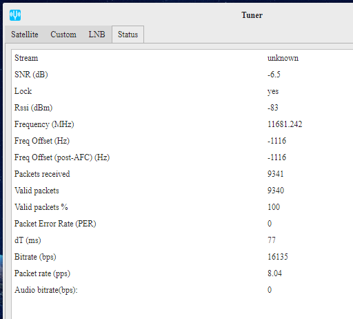

After a few Hours (over night) all is fine with the Signal. 100% valid packets (over 230000 decocded), just with the LNB indoors as before.
Status Update: Still all fine, almost 700k packets received, 100% valid packets only with the LNB.

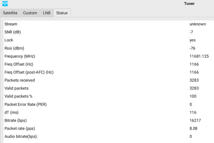

Made some trails yesterday to lock into Astra 3, 23.5 E at 11.681 GHz vertical with the Dreamcatcher. With a well positioned 40 cm dish and “tuning” between 11681.100 MHz and 11681.500 MHz I could lock with the Othernet LNB as well as with some standard TV LNBs and the Maverick too. Problem is the LOF accuracy and stability. Once there is a lock the signals are heavy: SNR 9 dB and 16.136 bps. Removing the LNBs from the dish the SNR drops to - 7 dB up to - 9.5 dB with 10 to 16 kbps depending on LNB.

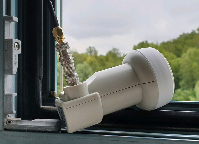

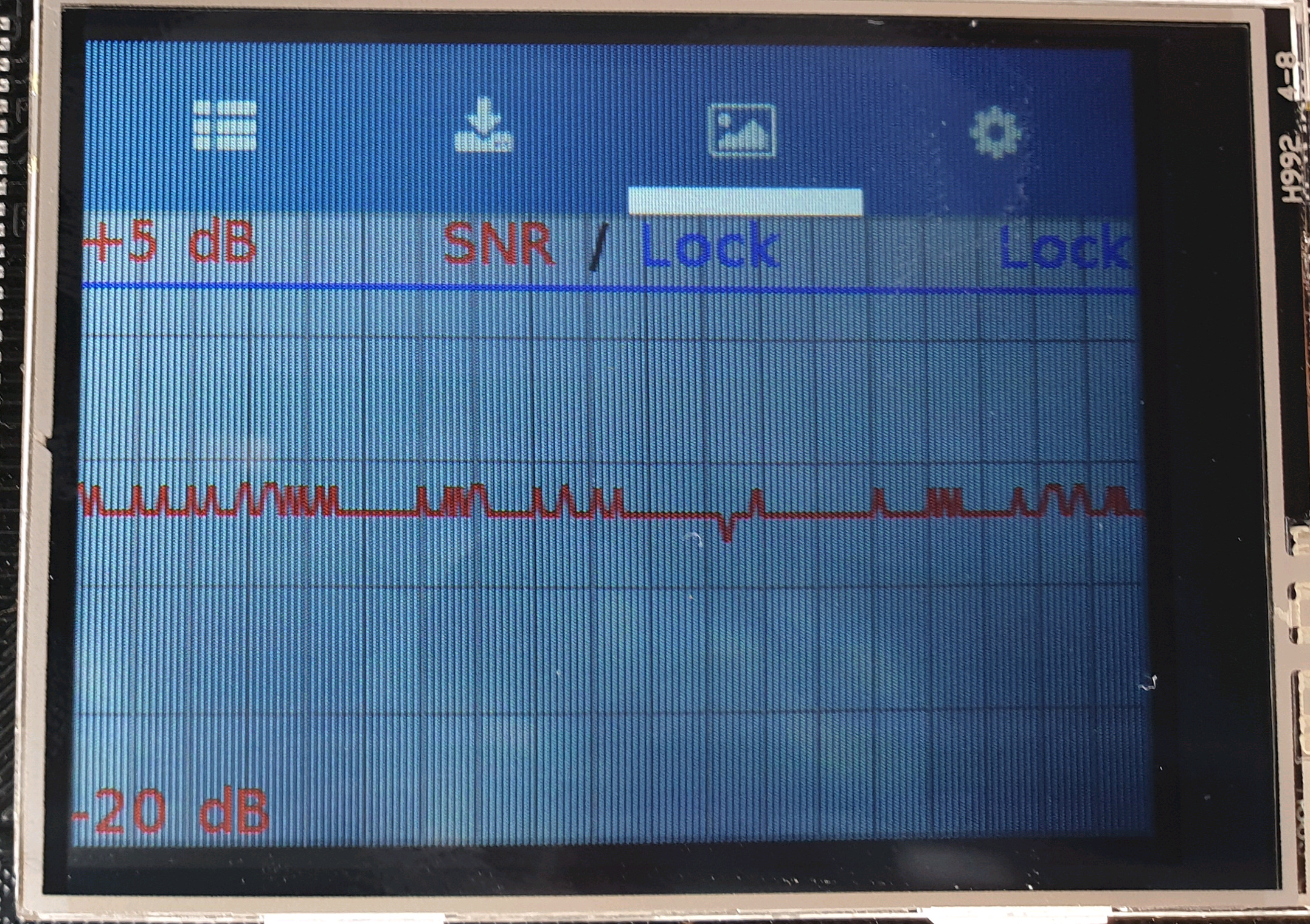

Today I took the board with the Maverick LNB in my office. The LNB is pointed out of the (open!) window, the SNR is at - 7 dB and it runs stable with 16 kbps:
Location is at 13.4 E and 51 N just in the centre of the beam…
