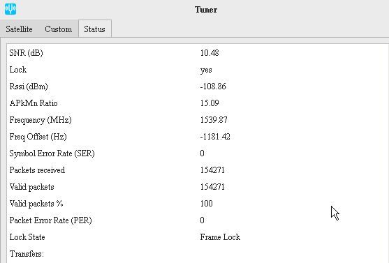

At this time 1704 EST, in Annapolis, MD, Lat 39 deg North, I’m getting hi SNR levels and Rssi’s.
Thanks. I’ll try again when I get home in a few hours. It stopped working Saturday evening and I wasn’t able to connect on Monday either.
the Rssi of -108 is impressive, what antenna are you playing with?
-C

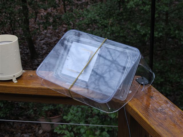

It’s the Alpha Lantern PATCH antenna operating under the new Outernet clear cover. Ever since I got the RTL-SDR and Outernet LNA to replace the originally shipped SDR and LNA, my signal levels have been consistently high. As I mentioned in other posts, after I put a slopping protective cover over my Lantern (which sits out in the weather) to prevent water pooling, I have improved my rain performance by 4 dB. Ken
I love the precision engineering in the clear cover BTW

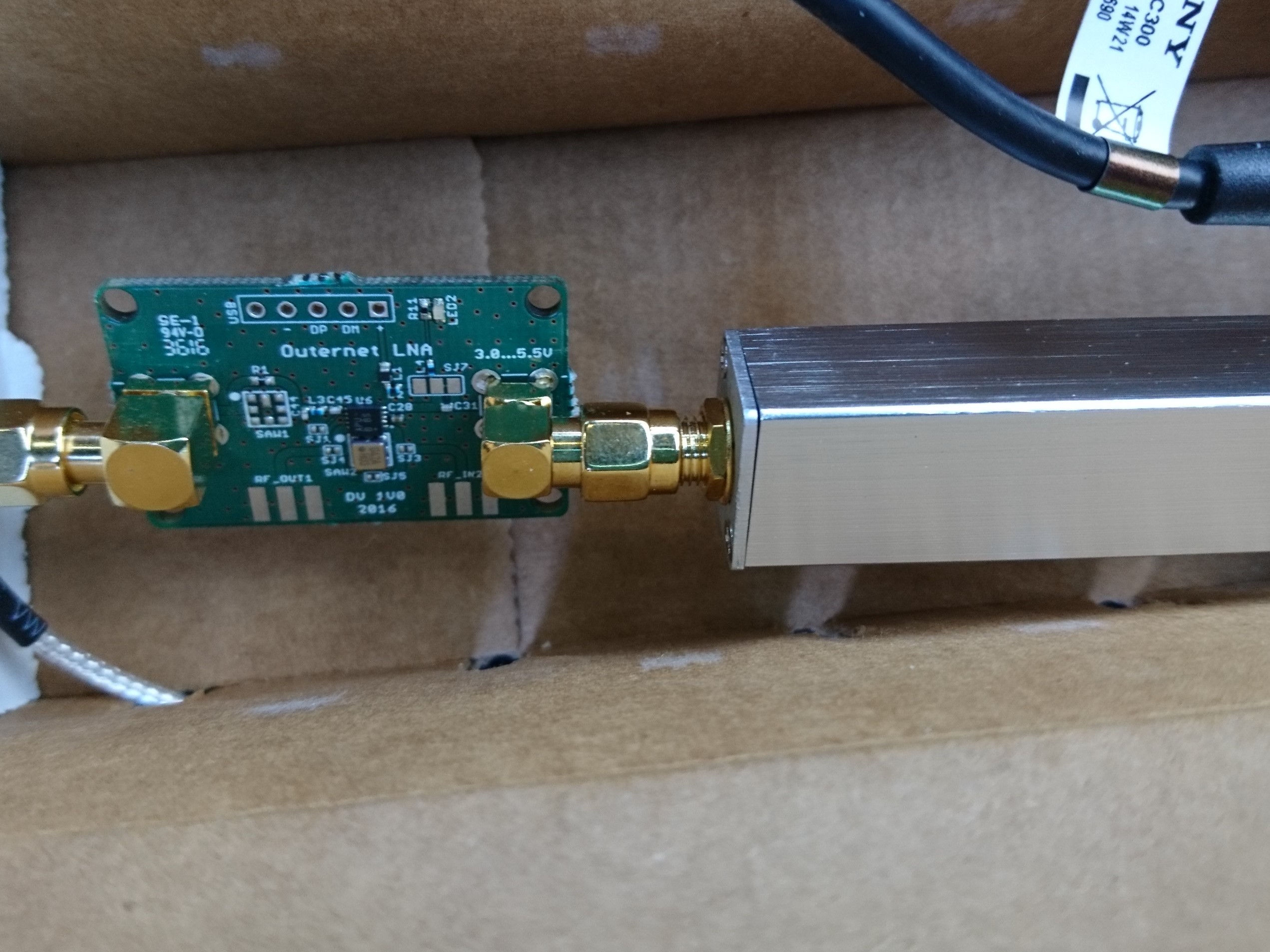

Could it be that the LNA is damaged by a static discharge when handling it?
Or is it well protected against that?
I wonder why the LNA is delivered as an open PCB now instead of the shielded design
that it was before.
