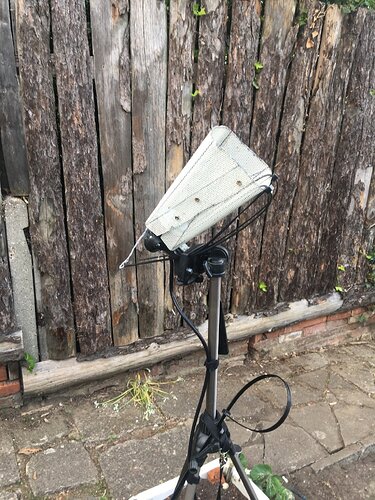

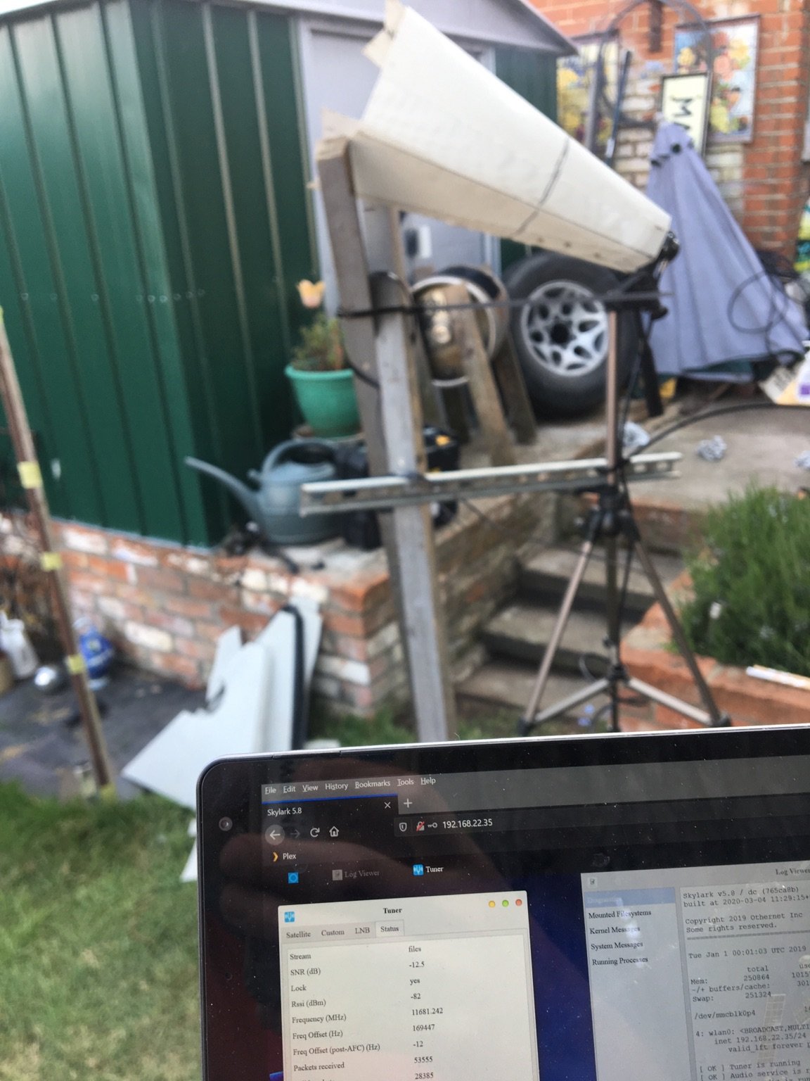

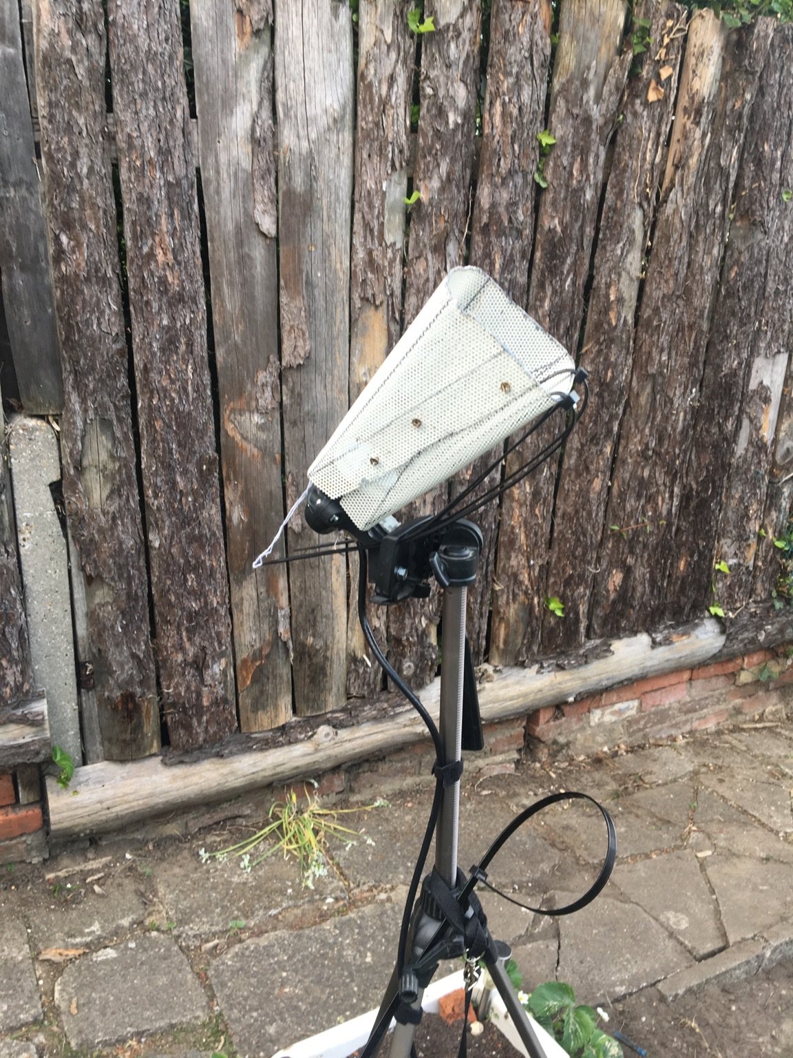

I grabbed a couple Dreamcatchers to fiddle around with (one currently based in Suffolk, UK), I’ve finally got my prototype antenna up and working, it’s given me a boost of about +4db, I plan to cut the cone down and shorten it, for now though it all seems to be working. Nominally I’m seeing about -11.5-12.5db SNR.
I’ve established a lock and am successfully downloading files, all of this has been completed without any precision aiming of the antennna with the use of a camera tripod and bits of wood & metal laying about.
