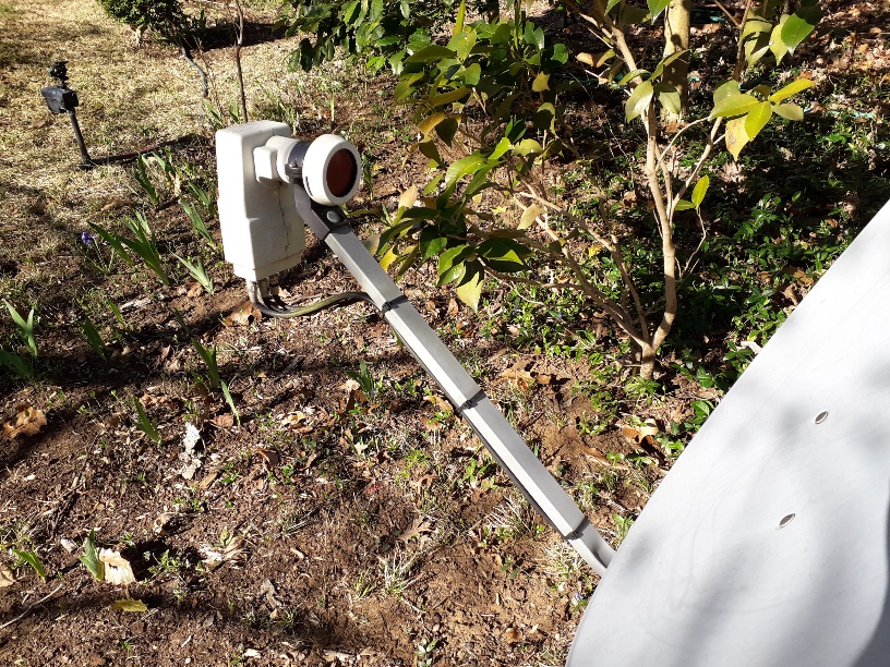

I have the 18" directV common offset dish. It originally had a circular lnbf … I have it, but found a linear one that fit in the retangular support arm and kept everything at the focal point…
I could swap back in the circular one… it uses the same offset:

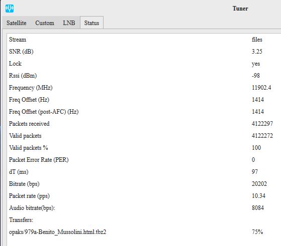

Here is the tuner report on the linear non-pll lnbf

got several packets… this is using the 18" dish directv LNB-18 lnbf
the diagnostic say normal lnb current flow 0x23 and voltage 14.2
but … not happy… after 7 packets it has stopped flashing on the DC board
update: after 21 packets it stopped receiving

ok with a dc un-plug - restart… it is now receiving well … yes with the 18 dish just for consistancy with
early post in the thread showing my 'linear lnb.
A 4db decrease in SNR but it is decoding well…
using the circular lnb 18
https://www.ebay.com/itm/Directv-DUAL-LNB-18-Single-Output-Satellite-Dish-lnbf-18-Circular-FTA-OTA-DTV-/173391316390
tuner report:

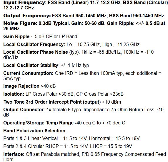

Looking through the manual for the Sony SAN-18D1/SAN-18S1 (intended for use with the Sony SAT-A1 and SAT-B1 DSS receivers), this antenna/LNB has the following specifications:
Input Frequency: 12.2-12.7 GHz
Output Frequency: 950-1450 MHz
Output Connector: F-type
Power Consumption: 3 W Max
Supply Voltage: DC +11.5-14.0 V for RHCP, DC +16.0-19.0 V for LHCP
If you want to see a copy of the manual, search for L0409644.pdf and see page 50 (PDF page and original document page numbers are identical). A lot of these are probably gathering dust in various places.
