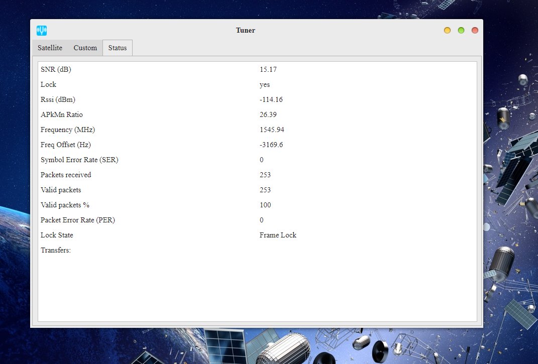

I also had some fun with a Dish(80cm) with a LBand feed I build for something else recently.
I got a SNR of over 15db from Alphasat (weakest sat of the three) with the old Outernet LNA and the Dreamcatcher.
The Dish was not pointed directly at the sat (about 5° off) because there was a house in the way.
The normal SNR of my Setup at my window is around 2.5-4.5db when pointed at the sat, without any obstruction in the way.
