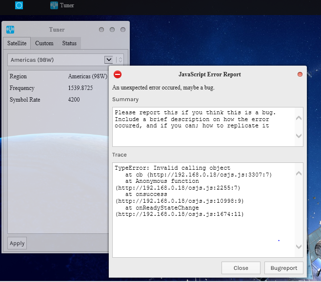

Now I get the below as I apply the change satellite.
I may have gotten the same message the first time… don’t remember.
but after I close this box… the status is
And – news still fails as I reported yesterday

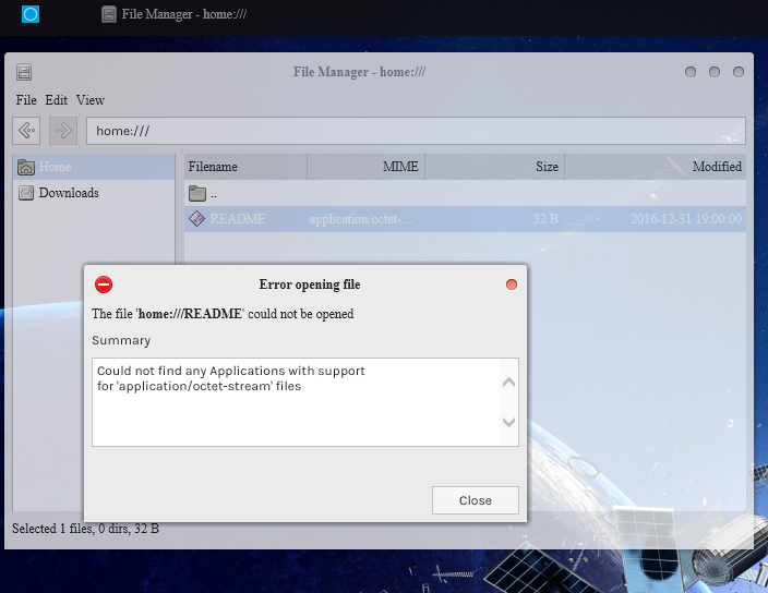

I ran across a non java script error, trying to open file manager home:/// README
logged in as user: outernet
It may not be related
This looks like a file-association issue, I see this as well when opening certain file types. Shouldn’t be related.

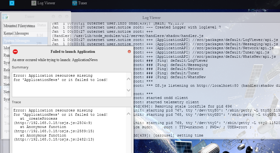

Here is a snipet as I try to start News
In the background is log viewer of system messages… I couldn’t find api News
I don’t know what info would be helpful

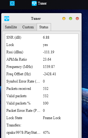

Maybe another clue. I weather It is stuck on weather date June 26 0000 utc. If I advance to +1 it says no data. even though in the file manager there are folders/files with data for 24,25,26,28,29,30. They seem to imply no-data.
–correction: there is weather data for june 25 0000 and 26 0000 in the graphic
