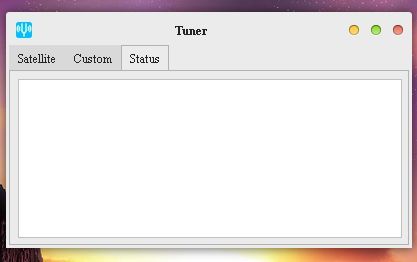

Not a hang but a power off on the CHIP and tuner/LNA. The reboot I did was a standard push of the CHIP power button for a few seconds until the CHIP started. At first I thought my USB power wall wart went bad, and the CHIP was running on the battery until it ran down - - but that’s not what happened. I checked that angle because I had a wall wart go bad once before and the system shut down after the battery discharged.
As to the data signal, on the third day of power downing, my SNR would lock at some high level like 6.5 dB and stay there. Normally, the SNR flutters around some central level. I took the unit indoors out of satellite site, and the SNR remained locked, Then more reboots with similar results. Interesting point was with no signal my SNR fluttered around neg 0.5 or so, and when I brought it out to see the satellite, SNR immediately went up to a high level and locked there.

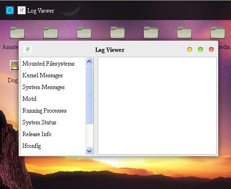

Well, after half a day of this fooling around, and all of a sudden, my Tuner tab only showed my satellite pick, and the Status tab was blank. I even tried re Applying my satellite selection, but no luck there either.
More rebooting finished out the day - - then both tabs became totally empty. I even tried swapping out LNAs and SDRs during all the above tests (as I have both kinds) and it made no difference. This pointed to the CHIP as the culprit.
A simple reflash fixed everything. So I will continue my watch.
Next time, which Logs should I copy out? Ken

Skylark Failed Again
My Alpha Lantern failed again after being up about 48 hours in exactly the same way.

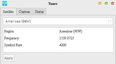

Just before the Tuner status stopped reporting anything looking like this:
It got locked up with a reported SNR of 4.4. I did a reboot, by the way, to get the above screen. My Lantern is reporting in on the overall status with red balloons as I would expect.
I am e mailing the logs to @Abhishek for a look. One thing I did note was the System logs only store system information from the last reboot. Seems like before with the rxOS, they kept a running account.

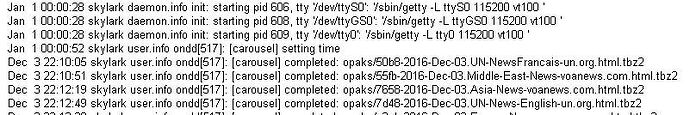

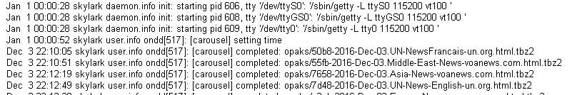

In a normal boot up process after all the modules are loaded, the system time changes when you get a connection as shown here:
Now I do not set a current system time:
I’ll standby, @Abhishek before I do anything else. The CHIP I’m using is the original CHIP that came with the Alpha Lantern. I have not used the replacement CHIP yet, although I have flashed Skylark to it. Ken
Ok. I think i might have a good lead on this.
Thanks Ken, this was a good observation, and very helpful.
Could you also email me the complete outputs of (each of) the following commands (in putty):
top
df
cat /var/log/messages
dmesg
ifconfig
After that, reflash this CHIP (leave your replacement as is, I don’t think this is related to the specific CHIP at all, its definitely a bug).
Once reflashed, put it in operation, but leave off your external USB stick/drive. See if that changes the situation any over the next few days.
Also, ensure that the radio is plugged in securely - if there is any play/movement in the usb connection, it will cause the tuner status to hang, so thats one possibility (separate from the earlier mentioned bug in skylark).
Thanks again.
OK - - PUTTY results are e mailed. I am reflashing the CHIP and putting it back in service WITHOUT my USB memory stick. Ken

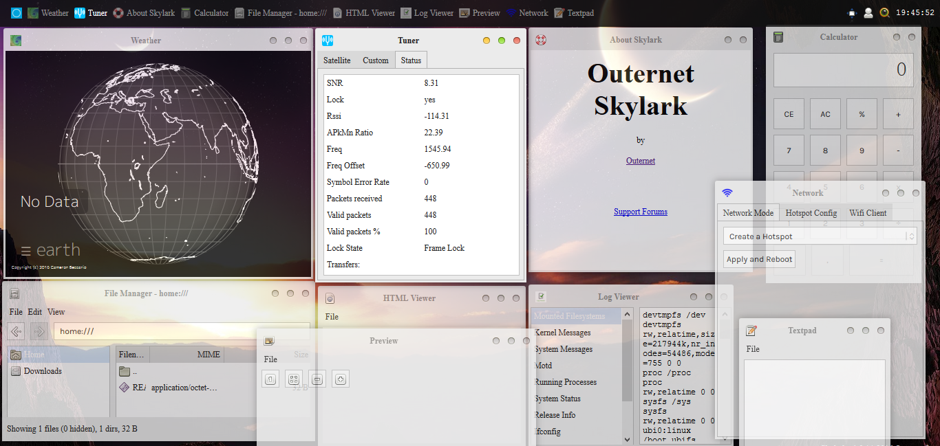

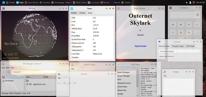

Otherwise, everything is good just waiting for a file from outernet satellite now. Here is a screenshot of skylark 1.0 with all windows opened.
The upgrade was a success. Just wait few more minutes, unplug the chip from computer, then power it up. It will blink once and turn off. Hold the reset button on the chip for about 3 seconds, the chip will boot normally. After that, just use it as usual.
