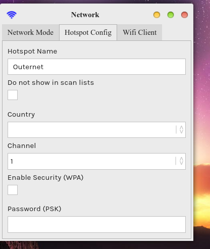

At the moment I seem to be unable to access it at all. It no longer provides a ā€˜outernet’ wifi connection, nor can I access it over USB/Ethernet.
I guess I may have to re-flash it?
when you connect it to your PCs USB port, what(if anything) shows up in lsusb?
Ah just tried again with a new USB and I’m in again… I’ve set it to ā€˜hotspot’ but even after a boot no wifi is visible
Kernel messages: http://pastebin.ca/3742317
Log viewer > Network messages:
wlan0: <NO-CARRIER,BROADCAST,MULTICAST,UP> mtu 1500 qdisc mq state DOWN group default qlen 1000
link/ether 7c:c7:09:e0:5d:91 brd ff:ff:ff:ff:ff:ff
inet 10.0.0.1/24 brd 10.0.0.255 scope global wlan0
valid_lft forever preferred_lft forever
ifconfig
wlan0 Link encap:Ethernet HWaddr 7C:C7:09:E0:5D:91
inet addr:10.0.0.1 Bcast:10.0.0.255 Mask:255.255.255.0
UP BROADCAST MULTICAST MTU:1500 Metric:1
RX packets:0 errors:0 dropped:0 overruns:0 frame:0
TX packets:0 errors:0 dropped:0 overruns:0 carrier:0
collisions:0 txqueuelen:1000
RX bytes:0 (0.0 B) TX bytes:0 (0.0 B)
the ifconfig seems to show it did go into hotspot mode. are you close enough to it?
Yes sat right next to it.
sudo iwlist wlan1 scan from my laptop less than a meter away shows other networks but not outernet.
Where are these settings saved? They must survive a reboot?
Could you try changing the channel to 6, then apply, reboot?
Settings are in /mnt/conf/etc/rxos_config.json. best not change them manually.
there are getconf and setconf commands you can use on the command line
for example
getconf .netConf.mode
should say ā€œapā€
I strongly advise not doing this though.
Oh: one thing you can try is to remove the /mnt/conf/etc/rxos_config.json file and reboot. that should reset all your configuration.
The kernel messages shows sth wrong with your wifi.
It might be best to reflash and start from scratch.
OK thanks i’ll try in the morning.
