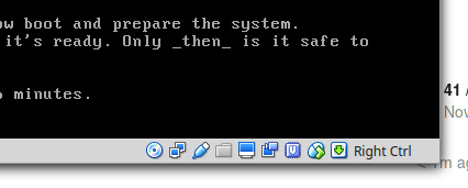

Also, can you check lsusb and see if the fel mode actually kicked in? You should see a device with deviceid: vendorid = 1f3a:efe8
if thats there, on the virtualbox UI, at the bottom, there are a bunch of icons, including the ‘usb’ icon. Could you right click that and see if you see the “Onda” device in the menu that popsup?
In the shot, its the third icon from left.
Ha of course it worked now… Maybe my jumper was bad.

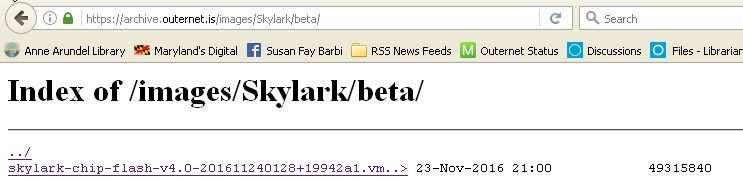

I plan to use a Windows 10 Platform, and want to be very clear on this process before I pull the trigger:
First, download Virtual Box 5.1.10 for Windows 10 from Downloads – Oracle VirtualBox
Second, download VirtualBox 5.1.10 Oracle VM VirtualBox Extension Pack from Downloads – Oracle VirtualBox
Third, download Skylark-Chip-Flash from We Moved!
Are these the three correct files to use in the flash process (along with my clip
@kenbarbi Yes, those are all of the items you need.

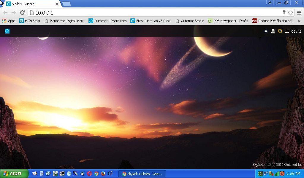

Running the new Skylark 1.0beta here, and it is working well

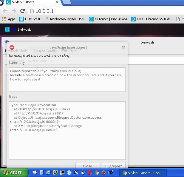

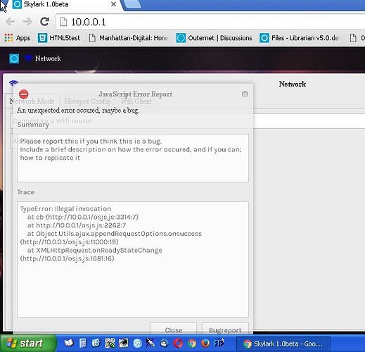

I had some difficulty connecting the Lantern to my router getting a Java bug report:
but ultimately it worked fine.

when did that error message show up? on clicking “save and apply”?
was it a one time thing or is it repeatable?
