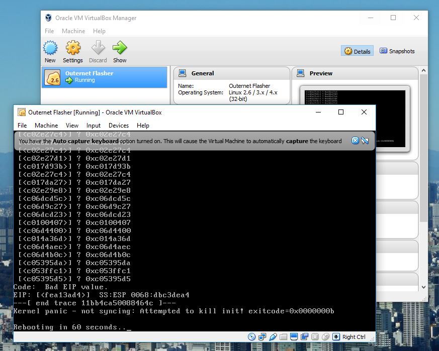

Is hardware virtualization (VT-x/AMD-v) required for this to work? Because I don’t have a working computer with vt-x support.
For the VM flasher to work, yes VT-x is required.

ok I guess I will have to find a computer with vt-x support. I might be able to use a computer at the local computer repair shop.
Never mind I just realized that my compute stick has an intel z3537f processor in it, that has vt-x support. This is going to be interesting.

your computer either doesn’t have hardware virtualization, or it is disabled in BIOS.

Mine seems to be doing this as well. Is thee anything I can try?
If you are seeing an ERROR -7, then I have no solution. Did we sell that CHIP to you?
Yes you did. I managed to get it working. I don’t think it is the CHIP. I was able to flash a Next Thing image on it using Chrome. I realize that method is totally different but it is was a flaky chip I bet is would have failed
After using the Chrome flasher, are you now able to use the Skylark flasher?
