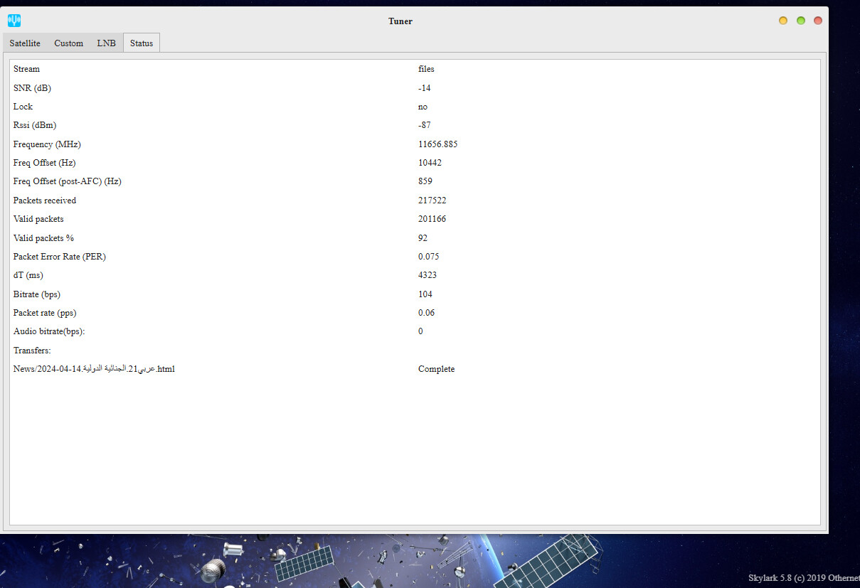

Poor reception skills : I’ve been using a Bullseye LNB and a coax cable of less than 5m with a Dreamcatcher 2301 orientated to Astra 3B (I am leaving in EU) at the default frequency of 1907 MHz. The best RSSI I’ve managed was between 100-99 and the SNR was around -12/-13, but I haven’t been able to reproduce these results consistently.
I’m considering whether using a 35cm camping dish could potentially improve my reception or assist with better orientation. Currently, I’m using a satellite app finder for alignment. Has anyone had experience with a setup similar to this, and could a smaller dish be effective?
Today, I’ve tried to download files, especially during better weather conditions (it was mildly cloudy today), but with no success. Is there a specific time that broadcasts of new files occur, or should I be able to receive data any time? Also, how frequently are the news or files refreshed? During my first attempt I was able to download 1 week old news.
