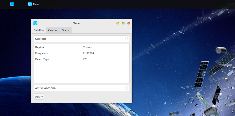

One of the first applications you should know about is the Tuner
As part of the basic setup, you will have used it to align your antenna.

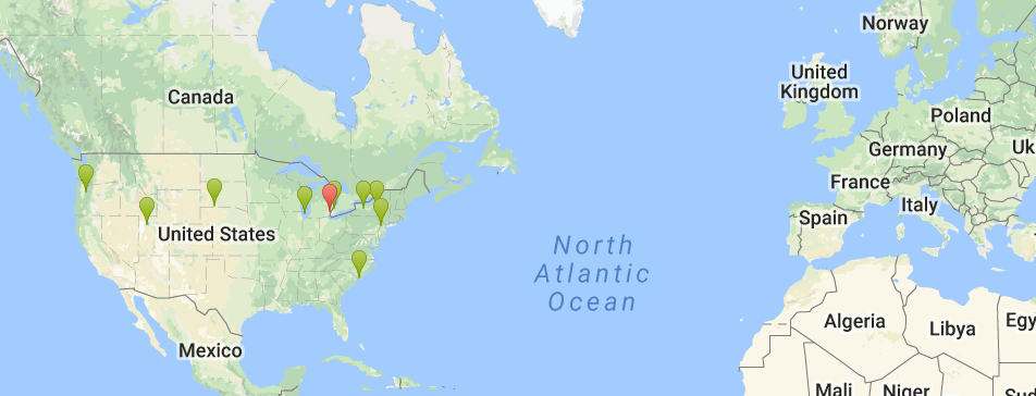

Some Internet connected stations are reporting their status on this status map

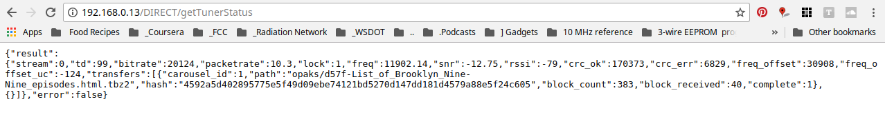

You can read your own DreamCatcher’s status by opening up a web browser to http://(Your DreamCatcher’s IP here)/DIRECT/getTunerStatus
It replies in a JSON format like this:
Admittedly, it’s not very pretty, but everything you see in the status app is there - your SNR, lock status, RSSI, files you are transferring, etc.

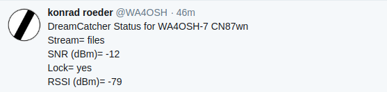

I built a very simple twitter bot that takes this information and posts it on twitter @WA4OSH.
Here’s what it’s posting:

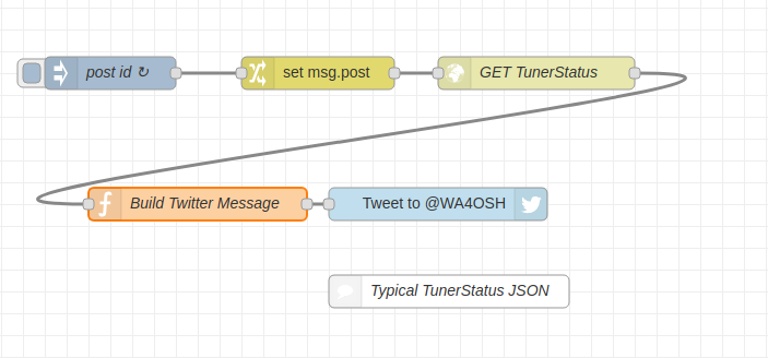

Here’s what the Node-RED application looks like:
Node-RED can run on Windows, Mac, Linux, and small computers like Raspberry Pi.
It’s very easy to install and get working. You can customize it to do all sorts of things quickly.

@Clavo @Ken I posted the get tuner twitter bot flow for Node-RED:
https://flows.nodered.org/flow/0f0000c1f2788ffa171000c0497417e2

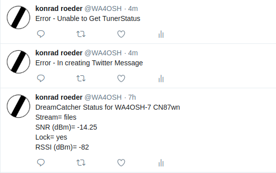

I’m trying to catch errors in the script. For example what happens when the computer querying the DreamCatcher can’t connect? What if there’s an internal bug of some sort that prevents a good message from being built?
