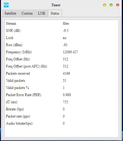

I seems that my old Dreamcatcher 3.03 has finally stopped working after all these years. I was showing a little over 20,000,000 valid packets received since last reboot before this happened! It is now receiving packets, but only occasionally gets a lock and downloads a valid packet. I’ve tried a new image/sd card with no improvement. I guess I’ll try again when the Dreamcatcher 5 is available.

Thanks for the suggestion. But my SNR and Rssi are as good or better than they have ever been. I’m still receiving packets continuously, just not valid packets with a lock. I may do some more troubleshooting when I have time.

I’m up and running again. The problem appears to have been interference from nearby WiFi routers, possibly. It’s strange that it worked fine in the same spot for years before it lost lock and stopped decoding packets. I tried a different coax cable, power supply, and even a different Dreamcatcher. Then found it worked outdoors when connected directly to the LNB with a short cable. I moved it about six feet away from the original location, used a different power receptacle, and now it’s doing great.
