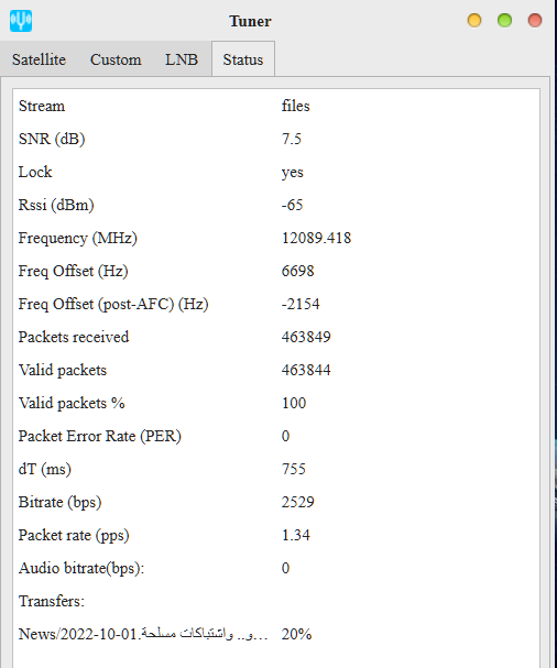

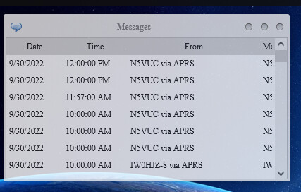

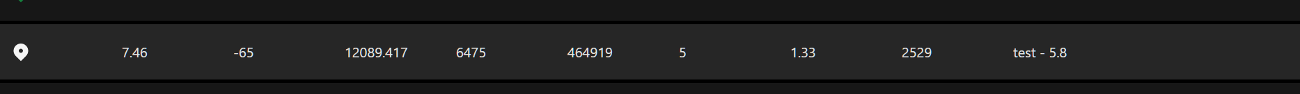

My unit is receiving, slowly. According to the Othernet Status page, it is not. It appears that the unit receiving the telemetry from the receivers via the internet is not decoding all the information being sent to it. I have noticed several times lately that it is not reporting accurately.
These screen shots were taken a minute or so ago, 10:25 AM MDT October 1, 2022
Some time ago, Manuel marked my unit “test” so that we could find it easily while we were doing other testing.

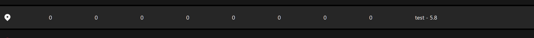

currently it shows online fine on the status page, maybe some timing/network issues to the telemetry server from your DC.
I refreshed the status page just before taking the screen shot. I don’t know why the status page would look any different and showing it online, coming off the internet, not the receiver, either at your location or mine.
I just refreshed it again, and now it does show online. This is what I mean, it is reading erratically and not accurately reporting.
This unit is online at aeroute.ddns.net
thats exactly what i was thinking about, i think we will need to delay the “mark as offline” thing, noted, don’t know when i get around changing it tho.
