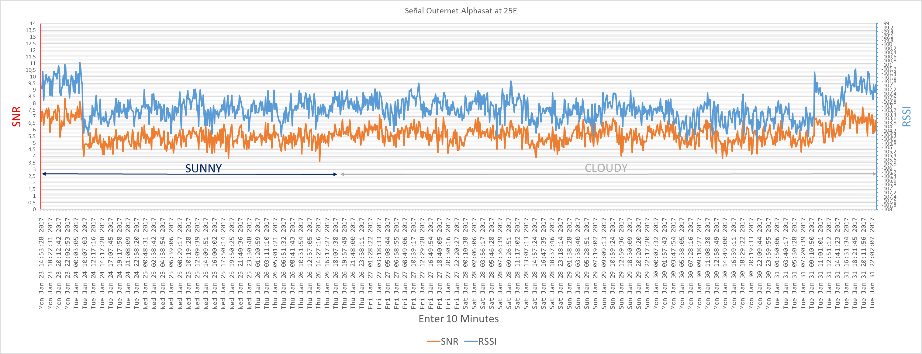

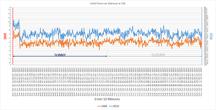

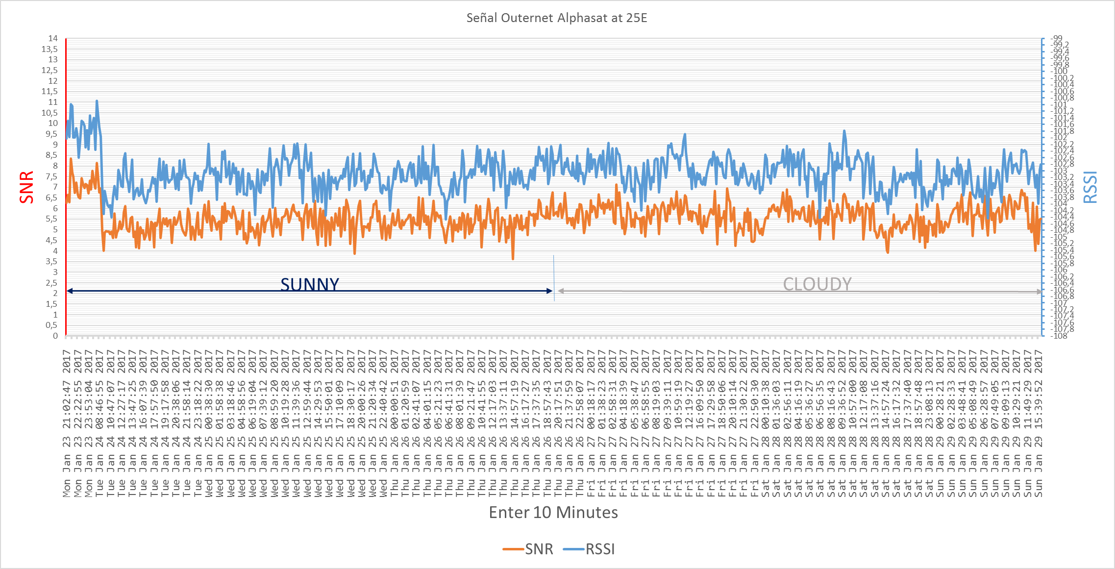

Grafica de la señal en Alphasat 25E, desde el día del fallo de la señal hasta hoy, el intervalo de captura de los datos es de 10 minutos, también indico el cambio de soleado a nublado (con algo de lluvia), la instalación no se ha tocado ni cambiado nada, el único cambio es el del clima.
Salu2 y suerte.
Translation:
Whatever may interest you.
Graph of the signal in Alphasat 25E, from the day of the signal failure to today, the data capture interval is 10 minutes, also indicated the change from sunny to cloudy (with some rain), the installation is not Has touched or changed anything, the only change is the weather.

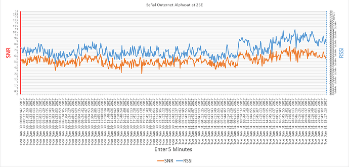

Yo le he eliminado el “+125” al script, y he creado un eje secundario con los datos del RSSI, así evitamos hacer cuentas, y un problema que yo he tenido al importar el txt, en las opciones avanzadas hay que decirle que el separador decimal es el punto ”.”, quizás a otros no le haga falta hacer esto, pero por si acaso lo digo, que a mí me ha tenido liado días…
Translation:
What has cost me! I have had to learn from scratch Excel and graphs.
I have deleted the “+125” to the script, and I created a secondary axis with the RSSI data, so we avoided to do accounts, and a problem that I had when importing the txt, in the advanced options we have to say that the Decimal separator is the point “.”, Maybe others do not need to do this, but just in case I say it, I have had me bundled days …

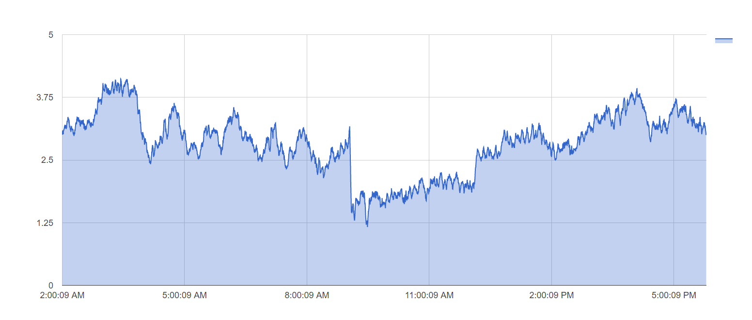

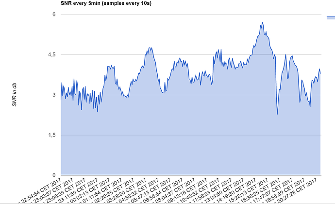

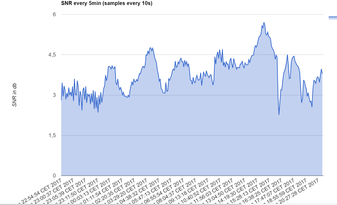

This example above logs the 192.168.1.5 Skylark device SNR into a text file (in every 15 sec, you can change that from script). This can be run on Linux computer, I’m using my RPi 2 mostly with Raspbian Jessie.
Also here is a small google sheet for chart visualization, the trick here using moving average of 10 to smooth the glitches.

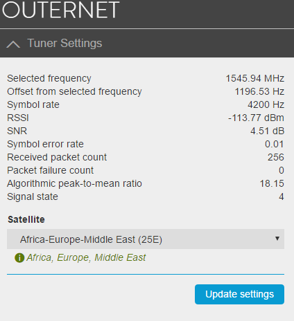

Just as a status from my receiver, its around 3db SNR at the moment. (VPN FTW )

When you look at my stats from yesterday, there is a repeating pattern like a wave.
That could be a rotation of the satellite would be my guess. I wonder if the statistics of today will show the same pattern, that would strenghten my presumption of a unwanted Rotation.
The weather here is still very cloudy, just like yesterday, so the Signallevel should be similar.
I’am very interested in the Response from Inmarsat

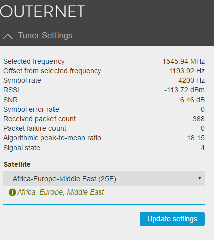

Whilst I don’t have logging running ( I have not had time whilst i am near the CHIP to fiddle) I can confirm that my SNR is up around 7 - 8 now (as opposed to 5-6) at 51Deg N , with nothing changed or touched at all .
I actually wonder if there has been something in a lower orbit (not geostationary, but possibly elliptical) “eclipsing” the Bird, moving slowly, The drop came suddenly, but it has come back a lot more gradually…

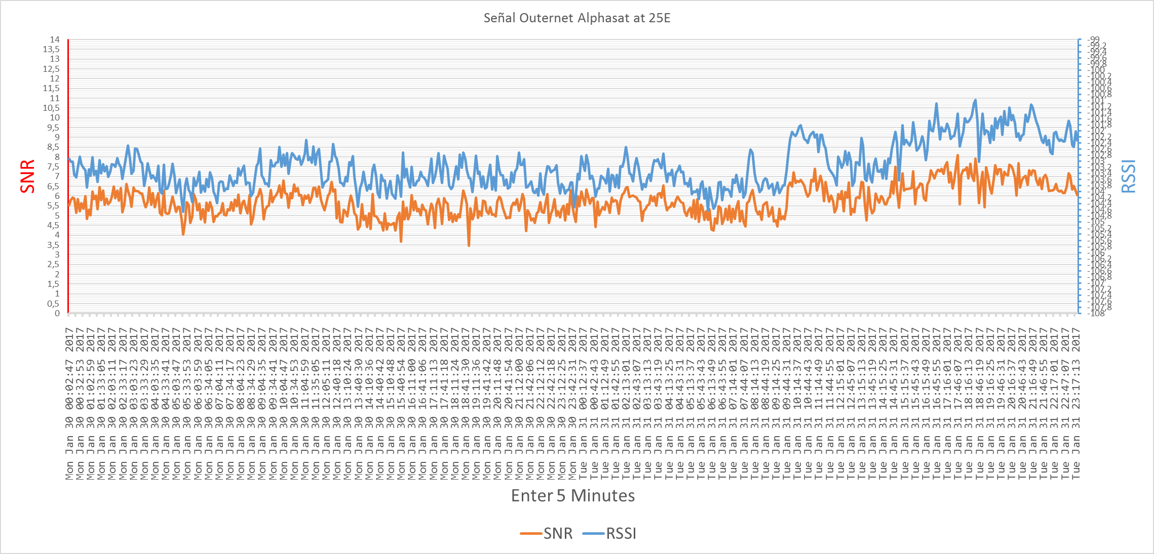

.Ahora la señal es alta, con picos de 8, como antes del fallo, cielo bastante despejado, he creado una tarea para capturar cada 1 minuto, para ver mejor la evolución de la señal.
Translation:
Now the signal is high, with peaks of 8, like before the fault, clear sky, I have created a task to capture every 1 minute, to better see the evolution of the signal.
