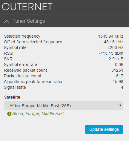

I agree with that. My RSSI is around -119 dBm with an SNR of >3dB.
He is getting 6dB more signal and has no SNR. So there must be noise or other disturbances.

@neil Thats very strange…i have a Signal but not much with a SNR of 2,5-3,5 db and RSSI of around -114.

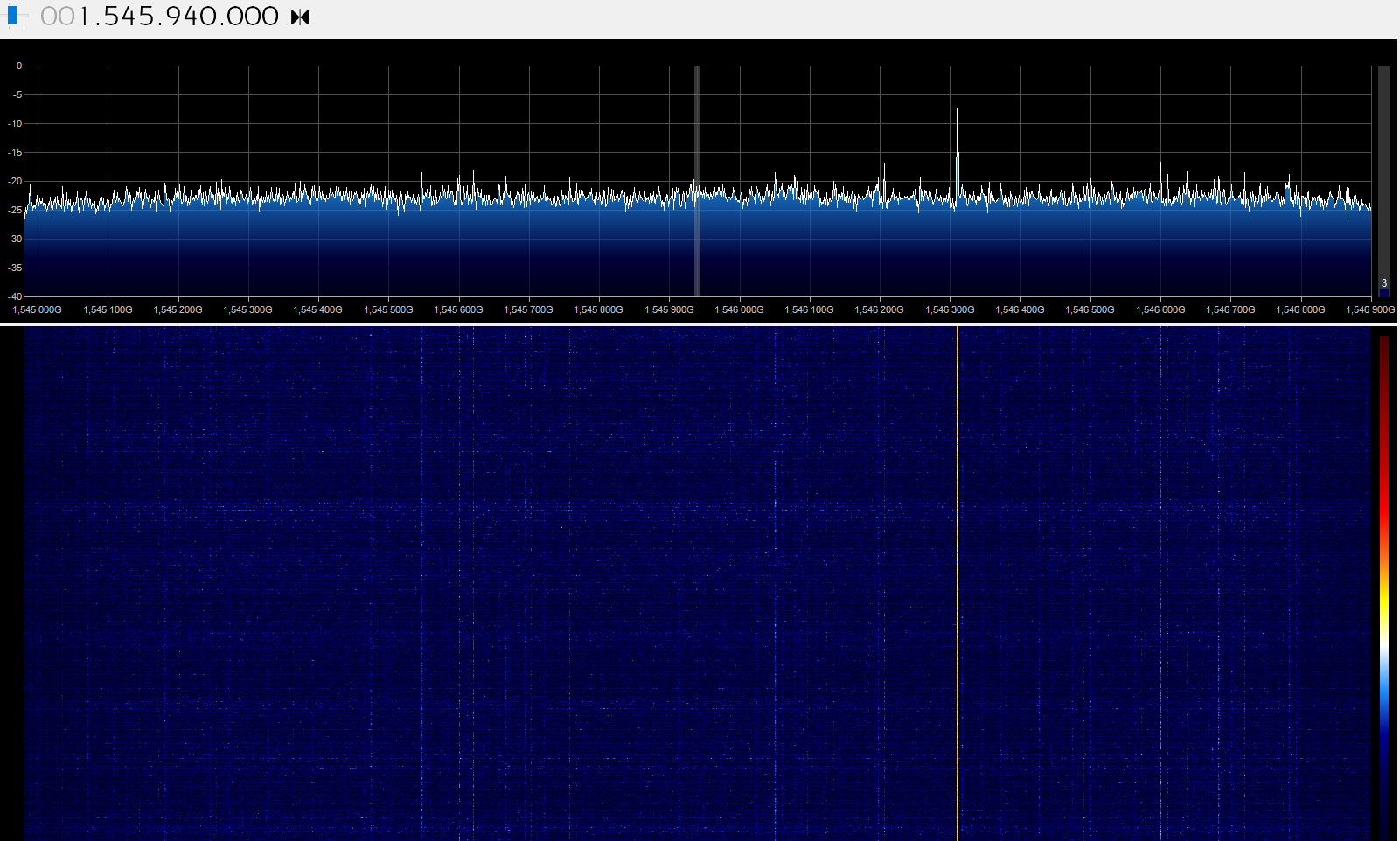

Here is an screenshot of the spectrum around the Alphasat frequency. I used another RTL_SDR.com V3 and a LNA4ALL for that. You can see that there is only one strong Signal at 1546.35.
LNA4ALL is not good for you as that’s a wideband LNA, really easily blindend by EMI… Use the Outernet LNA and turn on the bias tee power in the RTL-SDR V3 dongle manually before starting SDR# (this way you can power the LNA from the rtl-sdr dongle)
Your spectrum plot looks like bunch of noise, at least I cannot identify any satellite carrier there…

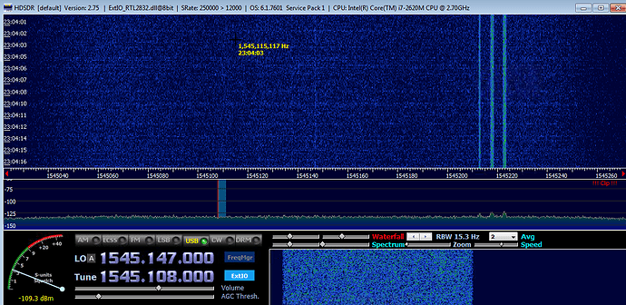

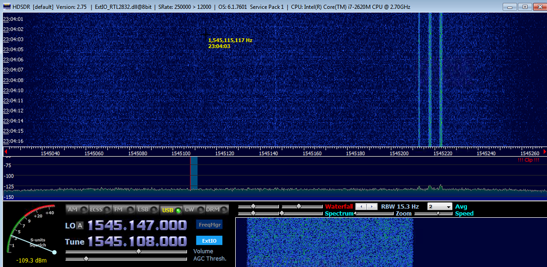

@Tysonpower Have a look & see what you can see around 1545118.5 with the setup & see of you can see the 3 peaks of the Aero signals
(you can decode them with jaero . the narrow one is 600baud & the wide ones are 1200 baud)
Just interested if you can see then with the LNA4ALL

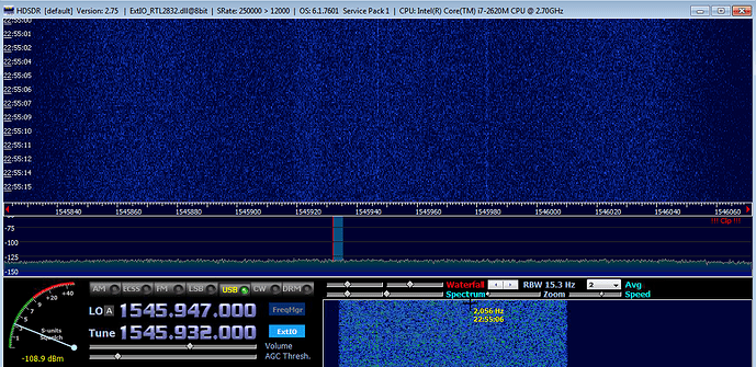

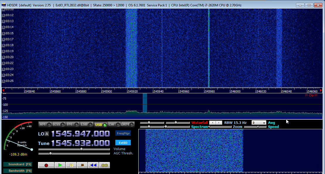

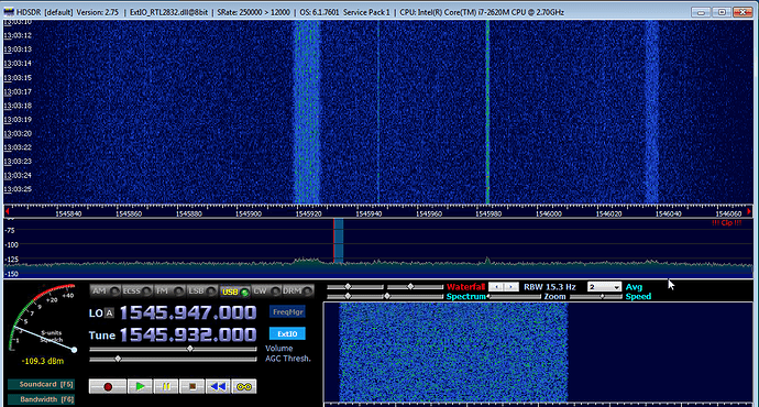

With the Outernet LNA and the supplied v3 RTL-SDR ( with the Bias-T turned on ) I am seeing this with HDSDR
(note frequency calib & Smeter is not set for this SDR - that is prob your signal up at 1545980 )
You can see just “shadows” of signals - this is worse that the “barefoot” SDRplay
Also here is the Aero signals though it … I am getting mostly CRC errors when i try to decode it though this setup - may not be a fair test due to your narrow LNA though

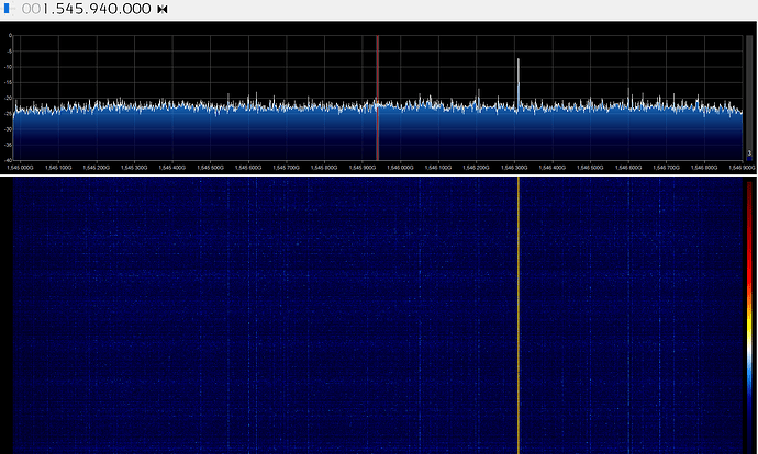

I connected it to my PC again and thats my spectrum with Outernet LNA etc. and i only get around 2-3db SNR:

I have a Signal, but its not strong at all with 2-3 db SNR. I’m near Cologne, Germany.
regards, Manuel
What SNR is “normal” for you there in Cologne, do you know?
I realy dont know, but with my indoor Antenna i got up to 7,5 db SNR last week.
When the sat is working correctly, for some hours, i get around 4-5db SNR.
As you can see i am still using Librarian, is there a script to monitor the SNR and RSSI?

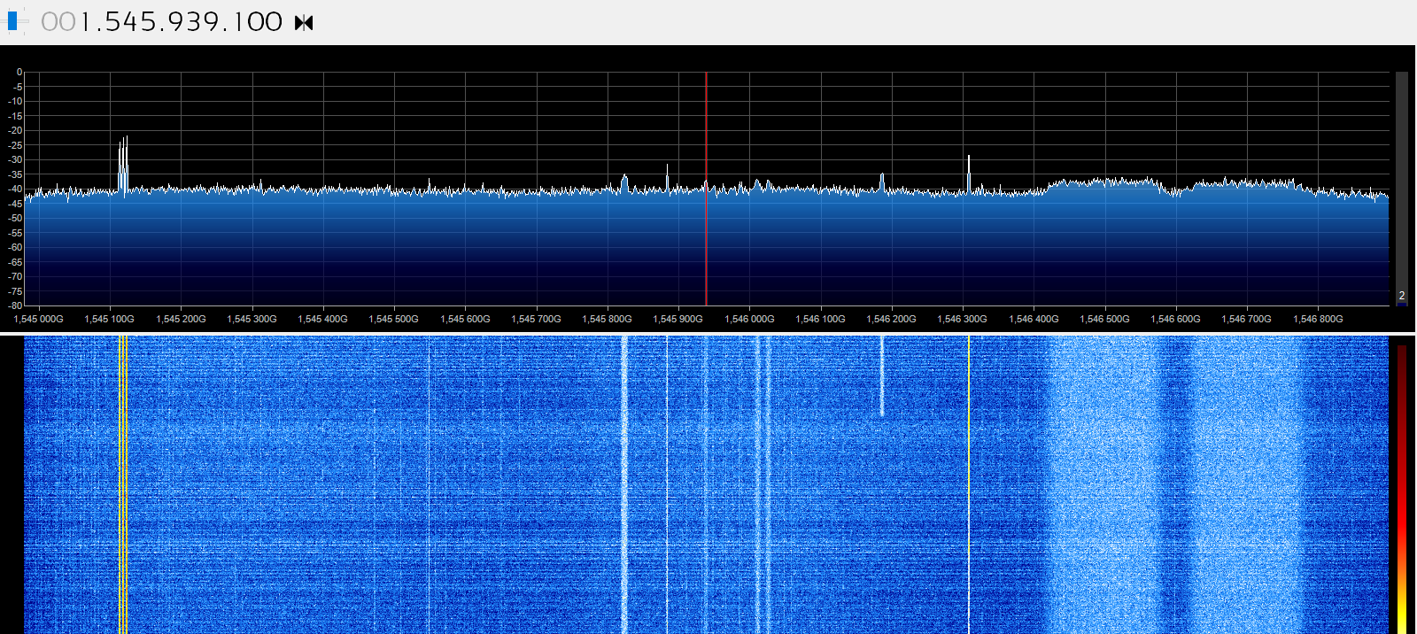

So this is the spectrum now
