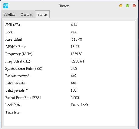

Found an old Pharos PX003 active GPS ceramic patch antenna, from the iPaq days, in the junkbox, so thought to try it out on Outernet. Opened the case, removed the 1575MHz filter, bridged the trace, shortened the cable length by half, installed a SMA connector, put it all back together, connected directly to RTL-SDR, and it seems to work pretty well sitting on top of the plastic box, in the window.

It matters a lot if you don’t want to waste the preamp gain. The dongles usually come with several feet of cable. In this case, it was about 10 feet. That is over 3.5dB loss at 1539MHz, and a little more with the connector. That is a loss of over half the available signal after the preamp. Considering that this ceramic patch has little if any gain at all, any preamplification gain needs to be preserved for reliable decoding. As you can see with the RSSI at 117dB with the shortened lead, there is little room let over to play.

Compared to the Outernet patch and LNA combo, it is within a dB or so RSSI. There are a couple of points to consider here:
  1. I removed any filtering the GPS antenna has. That makes it susceptible to more interference
  2. The GPS patch works best when positioned slightly above a metal backplane.
  3. The GPS patch is “aimed” in the general direction of the satellite. It did not work well just sitting there horizontally.
Still, a good start for some experimentation. For example, what happens if the GPS patch is integrated into a small package with a tuned reflector behind it?
