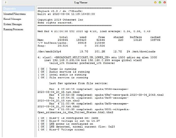

Maybe I can help out - - in your LogViewer
are you showing Bias-T on as in the bottom of the pic?

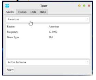

In the Tuner Icon, then Americas comes up as the default satellite
and finally did you selected the correct type LNB type?
and if you made any changes, did you back to the Satellite tab and click APPLY? Ken

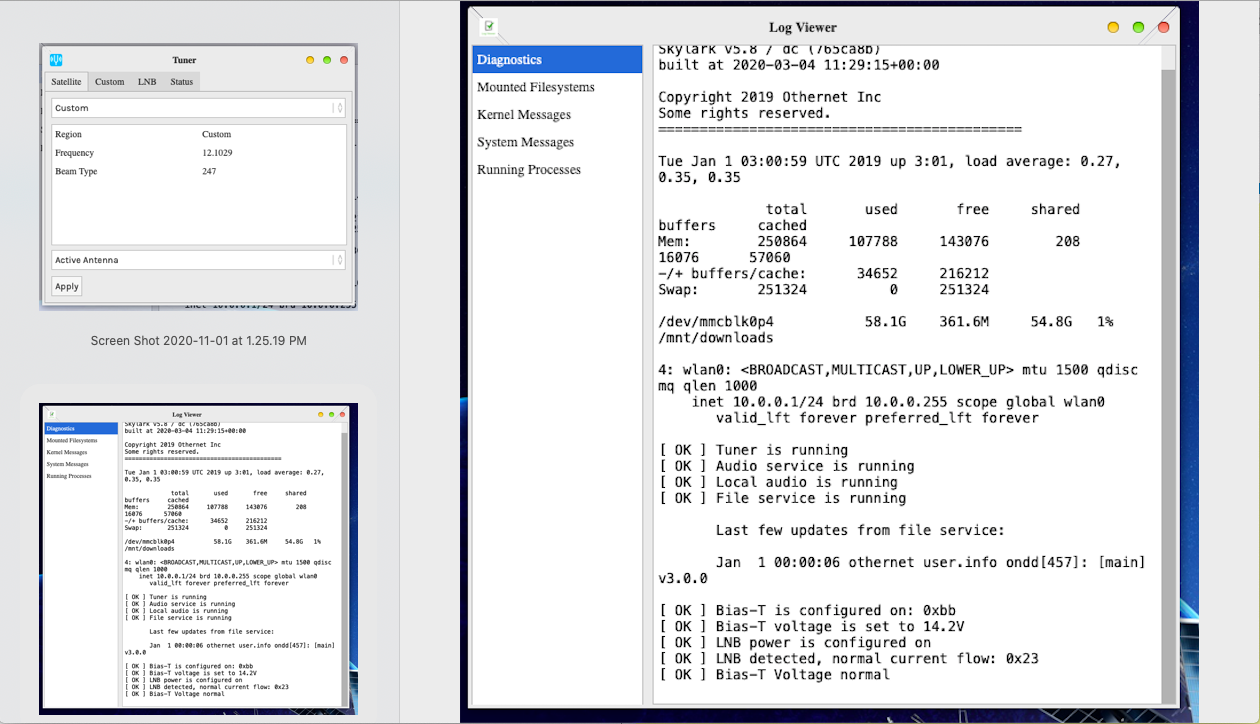

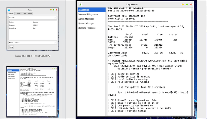

I did change the frequency to 12.1029 as was recommended in one of the articles.
Please see attached screen shots for settings details

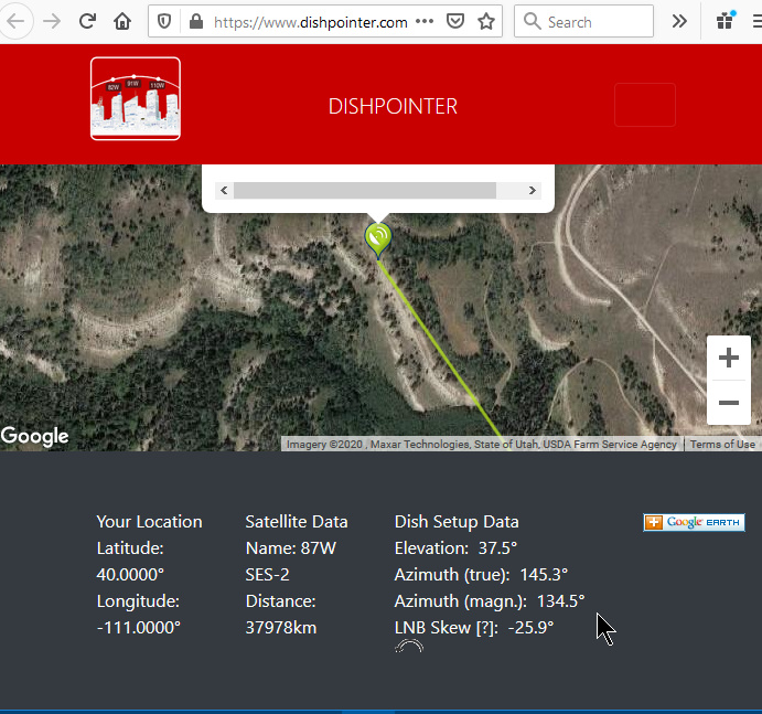

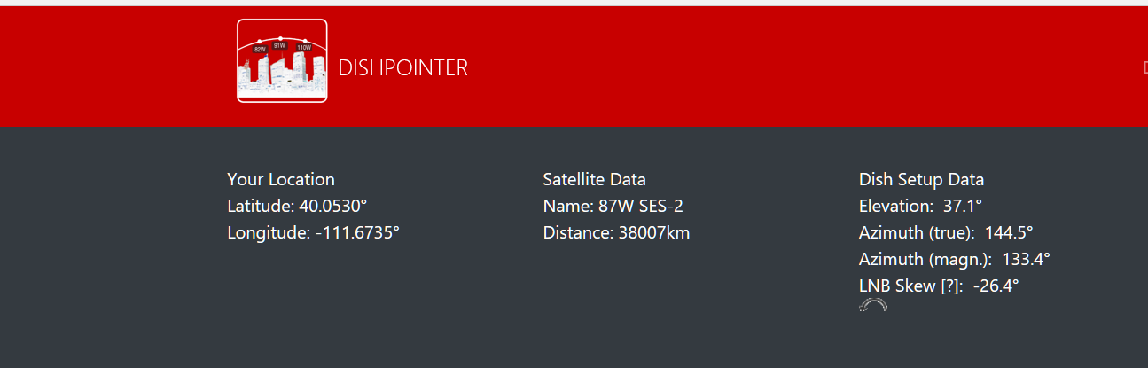

There’s a great visual pointing aid at https://www.dishpointer.com/ - you can see on the map whether your marker ist placed right. When i input your data (Long west is negative…) i roughly get the same numbers that you got as a result. Polarizsation is important as thats the amount of degrees you have to twist the LNB in the bracket from vertical alignment.
This what Dishpointer.com says about your location. If you were pointing to 284, you won’t get anything. Ken

Interesting how this can change from day to day. I entered “Salem, UT, USA” for location.
The best method is if you know your exact Lat/Long and use that as opposed to a general location as I did.
@Kyle_Roberts Kyle, also I would recommend to leave the frequency at 121032 until you have acquired the sat. At my location I had to modify it to get SNR better with my particular rig. However, I do have another Dreamcatcher that is set up portable that is spot on 121032, and modifying it either up or down actually degrades performance.
Just to add one more bit of info, magnetic declination for UT should be -11.1, so my original figures from Dishpointer were off there, also.
