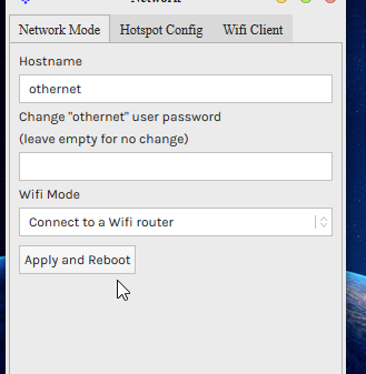

Hi Guys, I’m another newbie. Othernet is a really great concept that has been very well executed. I hope it continues to grow, as it has loads of potential. @kenbarbi the guide makes it a breeze to set up, I had it working including a lock on Astra 3B in about 15 mins.
My 3.05 receiver is running v5.8. I need to run it in ‘Connect to a WiFi router’ mode and it works fine using the supplied EDUP wifi dongle. Ken has kindly told us we can use a TL-UE300 ethernet adapter instead of Wifi. I need to operate like this because the Wifi it too patchy between the receiver and my router (long distance with obstacles).
Am I correct in thinking that with the UE300 I simply plug it in to the 3.05, connect to my router, then switch the 3.05 to ‘Connect to a Wifi Router’ mode? The Ethernet light flashes as normal on the router and UL-300 adapter, but the 3.05 receiver does not appear as a client on my DHCP client list (it does when I switch to wifi instead of ethernet).
I am probably missing something obvious, but it would be great if you can confirm which mode the 3.05 receiver should be in, to work with the UE300 adapter over ethernet into a router. Thanks for reading!
Welcome Richard to Othernet with all of us HAMS and hackers. With the ethernet adapter plugged in, and your Dreamcatcher connected to your appropriate network, the Dreamcatcher should get assigned an IP address by your router.
But after re reading your post, it looks to me that you may not have clicked APPLY AND REBOOT when going from the Othernet WiFi hotspot to "Connect to a WiFi Router. If your router doesn’t show the Dreamcatcher (it should) IP, then I suspect you might not have initiated the connection.

Hi Ken and Richard, I would say that you are spot on as it stands, let’s see if that takes care of it. The Connect with a Wifi router is the only choice that would support the UE-300 if I remember right. If that isn’t working, Richard, please post again and I will get out my second unit and see what gives. I do have a UE-300 that works, but I don’t remember having to change anything to get the connection, maybe it just needs the Apply and Reboot as Ken said.
Hi Ken and Jerry, thanks for the reply. I’ve tried just about every combination I can think of, including the one you kindly suggest. I’m in the satellite and IT sectors, so have a reasonable understanding of the kit.
Here’s a good example. With the EDUP wifi dongle plugged in: 1) enter wifi client details, 2) set network mode to ‘connect to a router’, 3) ‘apply and reboot’. It then connects via wifi to the router and I can access it over the LAN. 4) Turn off receiver with power button, unplug the wifi dongle and plug-in UE-300 ethernet adapter, 5) switch receiver on - it fails to connect to the router. If I switch back to the wifi dongle, it then connects fine, so it hasn’t lost the connect to router setting.
I’ve tried with and without data entered into the ‘wifi client field’, in case it was trying to log-on to the router when of course being ethernet it doesn’t need to. I’ve tried hot-swapping the EDUP dongle for the ethernet dongle.

I had a few minutes and went ahead to set it up. When I booted the Dreamcatcher, it had been previously set up as a hot spot. I only changed out the Edup for the UE-300. However, it connected immediately to the router and was accessible using a browser once I went into the router and obtained the url. So perhaps it needs to be set up as a hot spot first? I know that it worked right off, so perhaps this is the solution. Got to get moving now, will check back later if there are questions. Jerry
Hi Jerry, you are spot-on. With the receiver already running as a ‘wifi hotspot’, if you cycle it off, switch over to the ethernet dongle and power on; then voila it’s a client on the router’s LAN.
It looks like I was overthinking it, by trying to make it connect using the ‘connect to a router’ set-up. Plugging the ethernet dongle in somehow forced the hotspot mode to work as an ethernet client.
