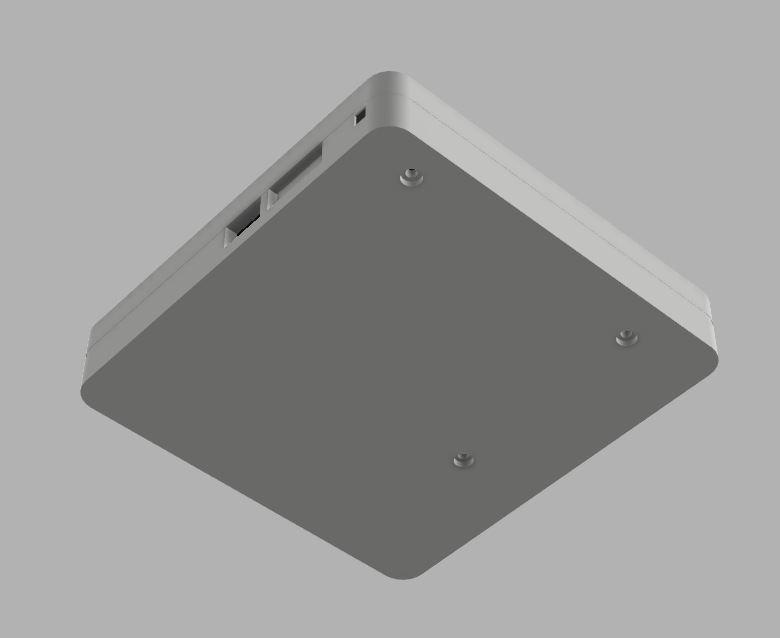

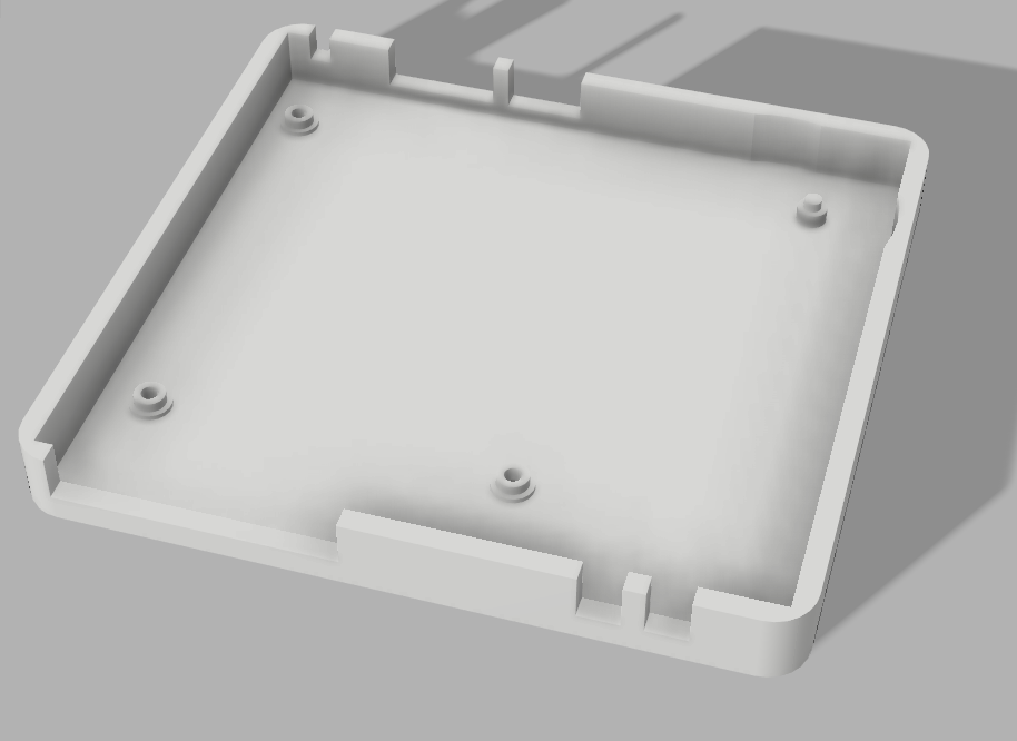

i designed a 3D printable Case for the new Dreamcatcher 3 as i wrote in another thread already.
I would like to use that thread to share some more information as well as the stl files and to get some feedback on the case and tipps on how to improve it.
The Case is 138mm high, 132mm wide and 23,5mm thick. It houses the Dreamcatcher as well as the Display and Speaker. It is made out of two pieces and is held together by three M3 bolts / screws. The Speaker needs to be glued in with Hotglue for example.
I don’t have the Hardware on hand, som i was not able to make precise cutouts for all ports. Because of that i left some more room so that it fits the DC3 but it doesen’t look as good as it could.

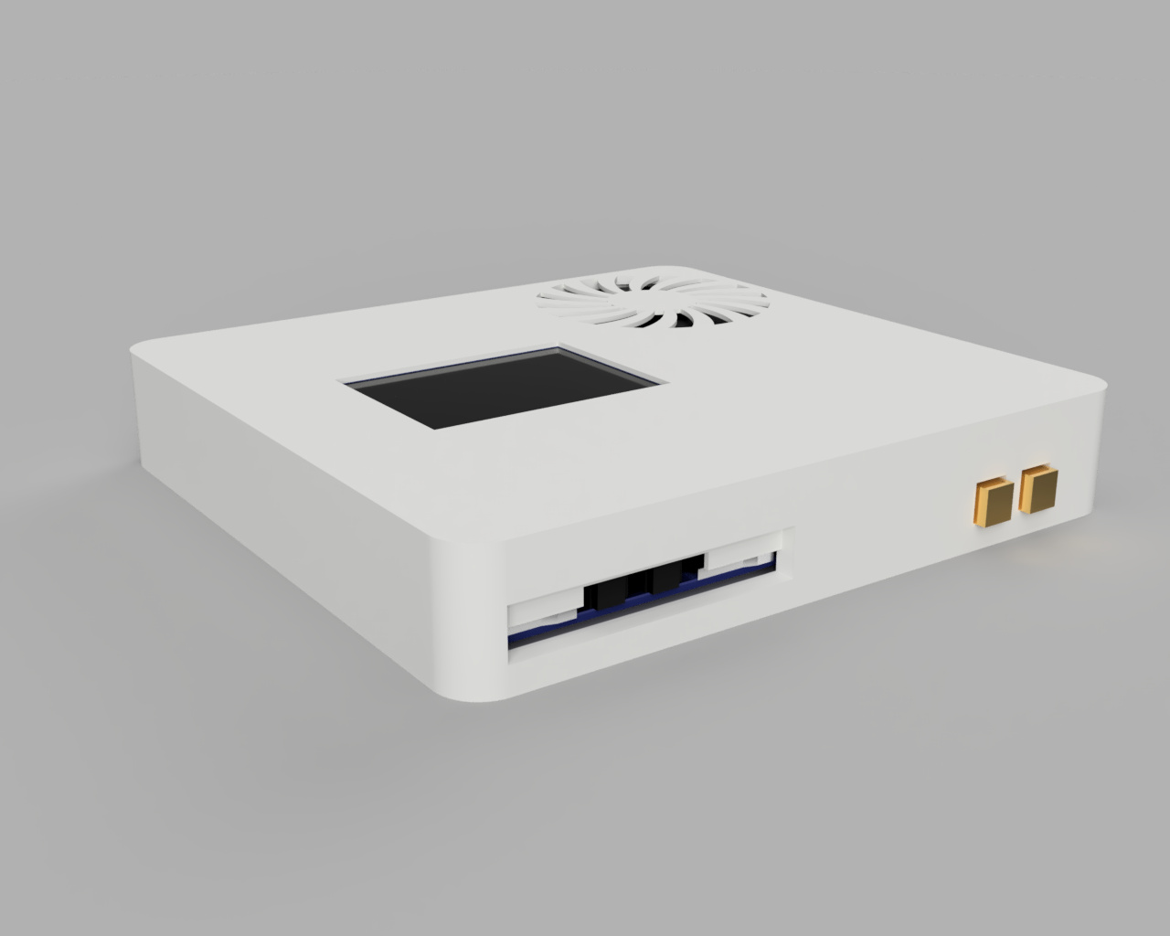

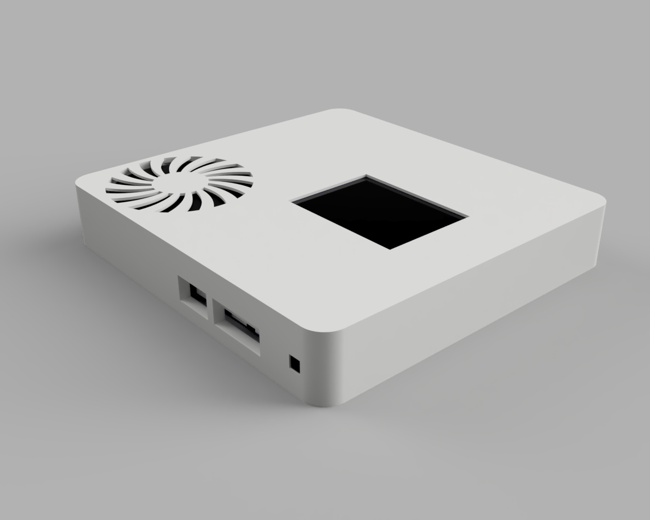

Here are some Renders:
I hope that i can help some of you that have a DC3 and a 3D Printer, so here are the STL files:

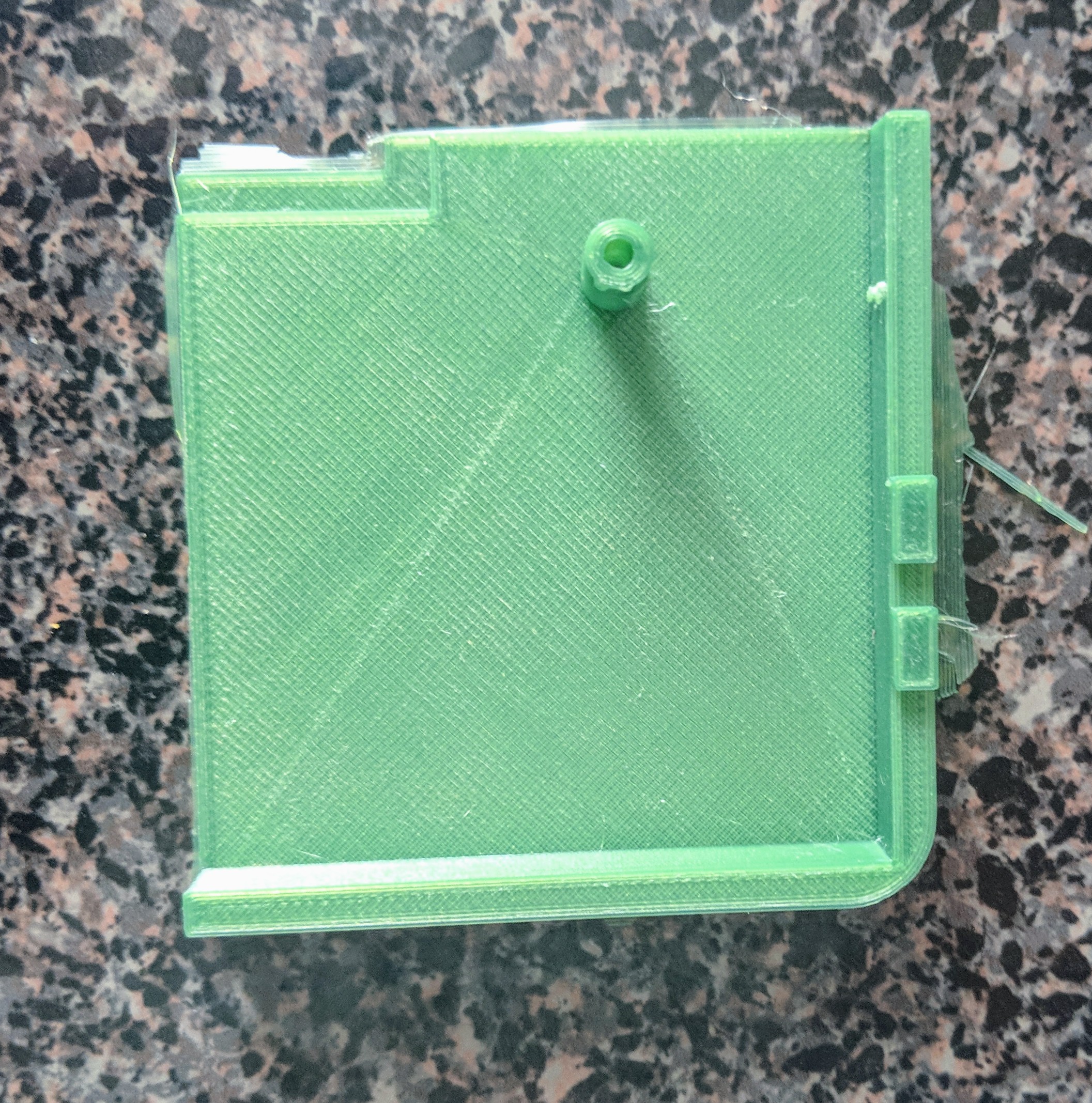

here are my split up stl files DC3_beta_case_split 8x parts

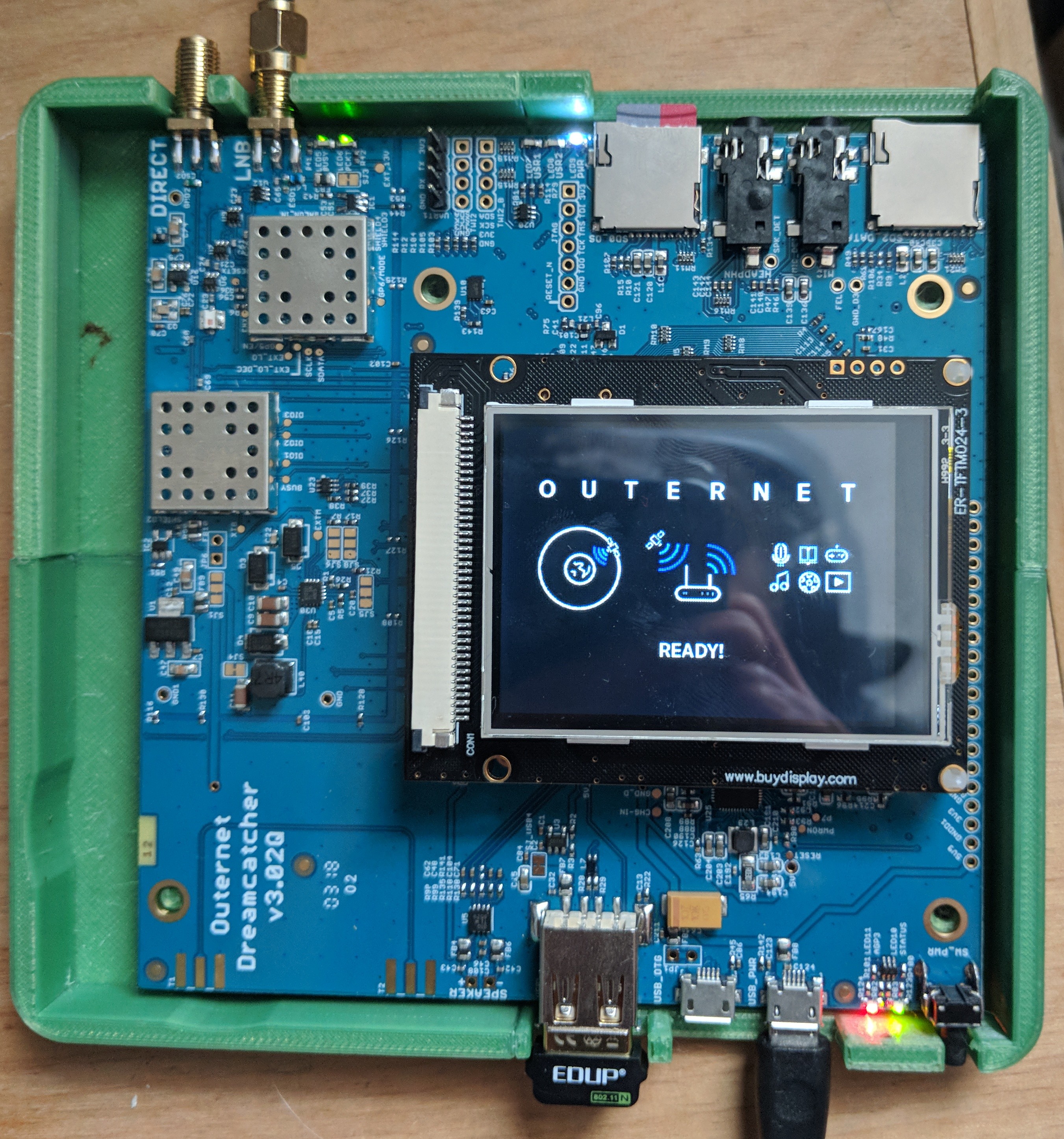

ok here is a picture of my bottom half printed with the outernet board in it

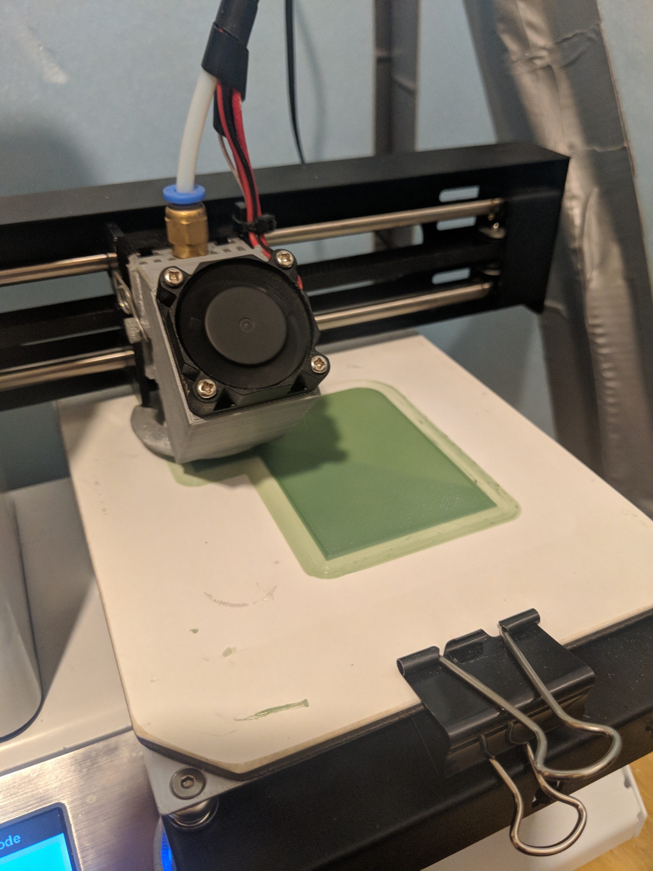

picture below is a part in production
and below this is a part that i still need to clean up for gluing
also all parts are printed in PETG
Nice! Looks like my Case fits the DC3 quite well. Awesome!

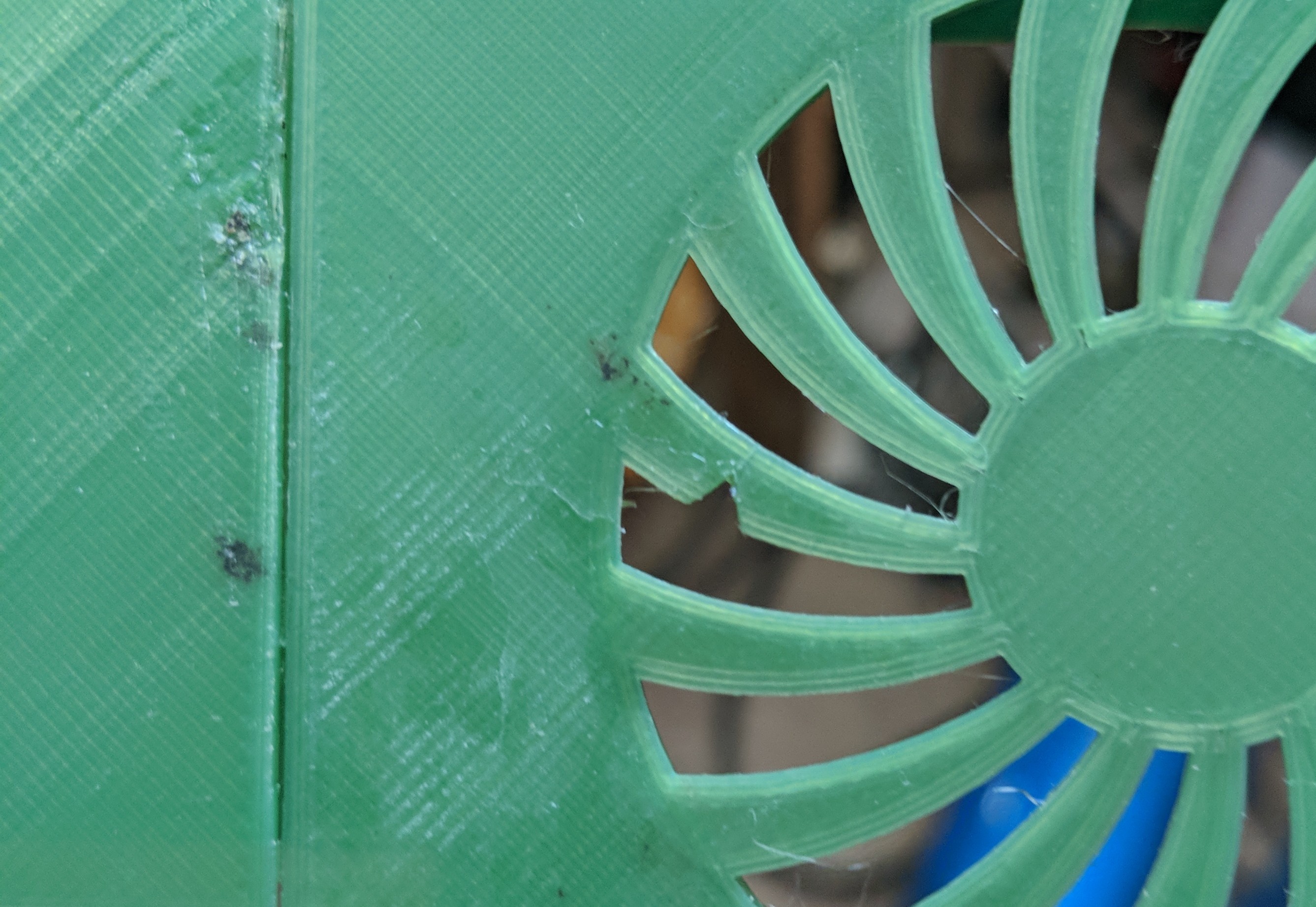

yes there are a few pain in the but parts to print also i would thicken the speaker area that cracked really easily but thats due to where i spit the part but the speaker area is the evil area
okay, could you be a bit more specific what parts where hard to print?
Did the speaker vent / Opening crack or what part of it?
speaker vent the fins holding in the vent cover started to crack one broke off and i had to glue it
mmm…i could make it a little bit thicker or change the pattern of the speaker vent in the future. Thanks for the feedback!
But i think that it will be more stable when it is printed in one piece.
the entire speaker vent was printed as one peace if you look how i spliced it
okay, can you send me a image with the cracking point marked?
sure here it is its not marked but its clearly visible
Oh okay, thanks for the image. i will change the vent in the next version so that they are wider and stronger.
