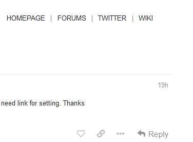

Hi Roman - - go to the WIKI on the Forum page for information about setting up your Dreamcatcher. Ken

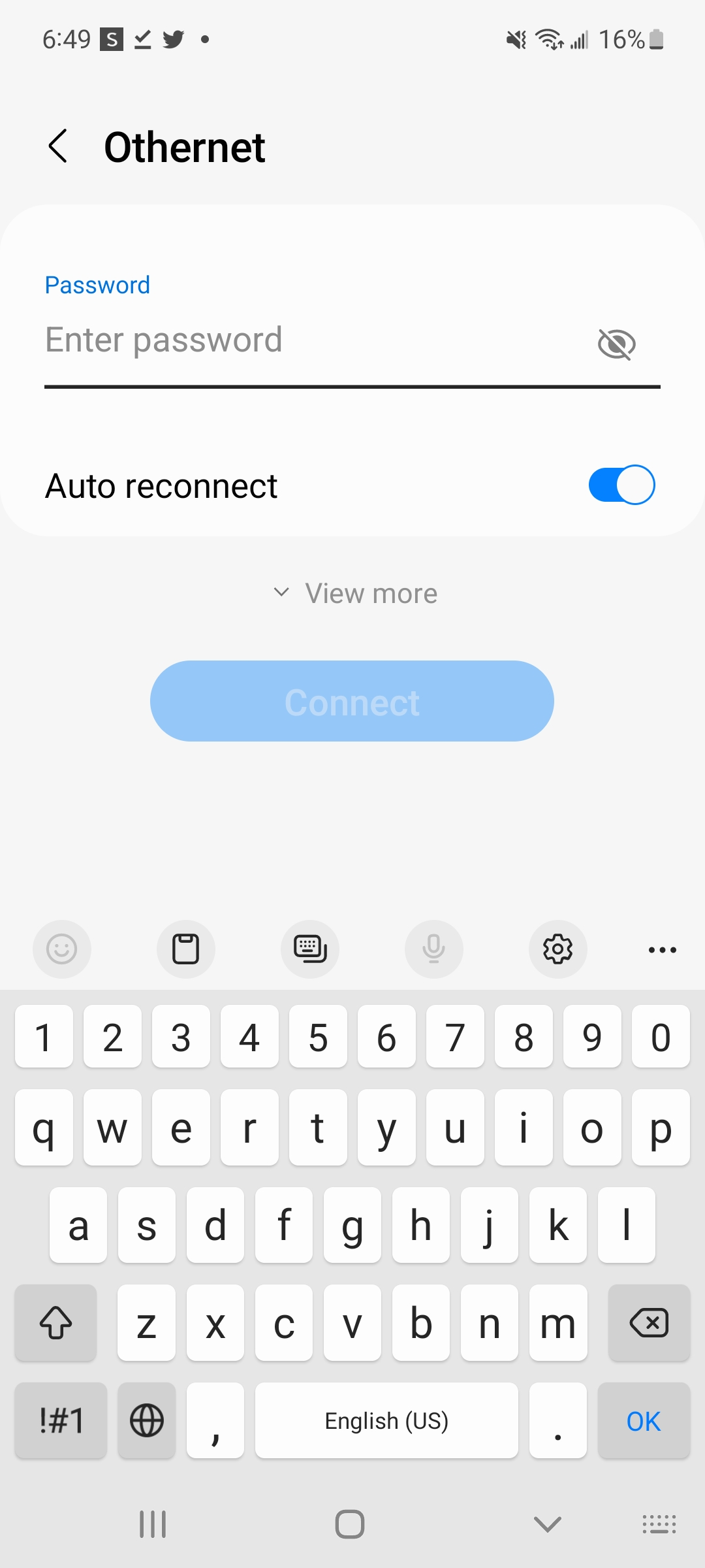

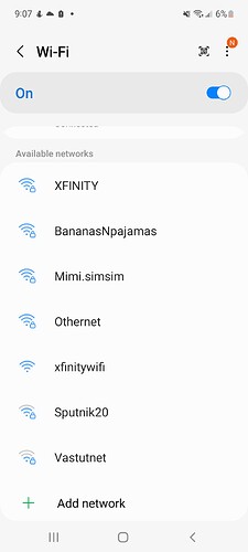

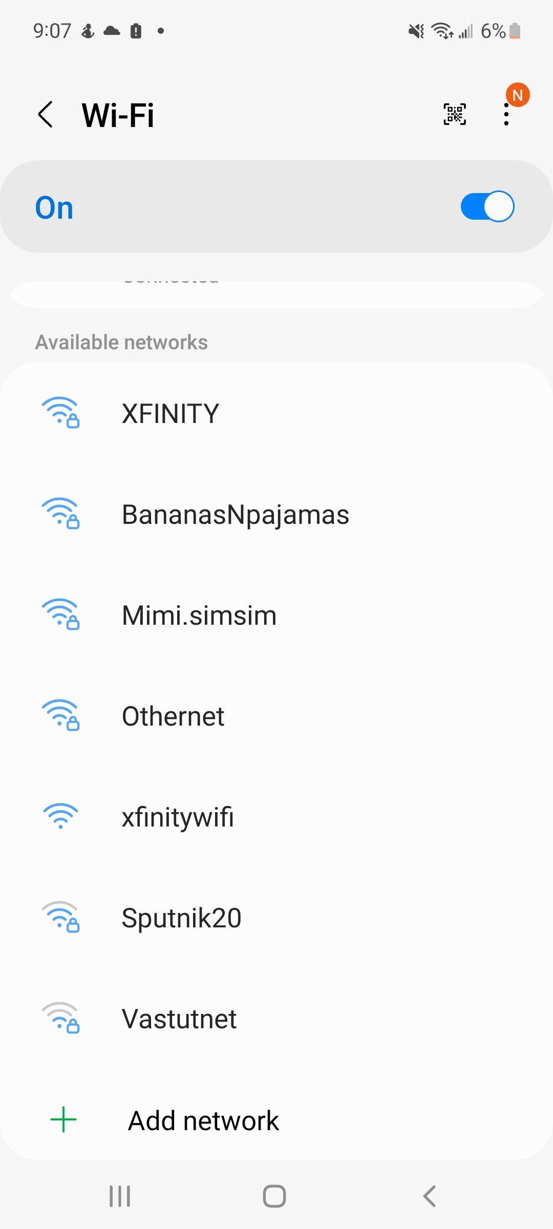

Select Othernet and log in as you started above, using othernet as your password. (Type in the word othernet on the line where it says Enter Password).
Password?
192.168.4.1

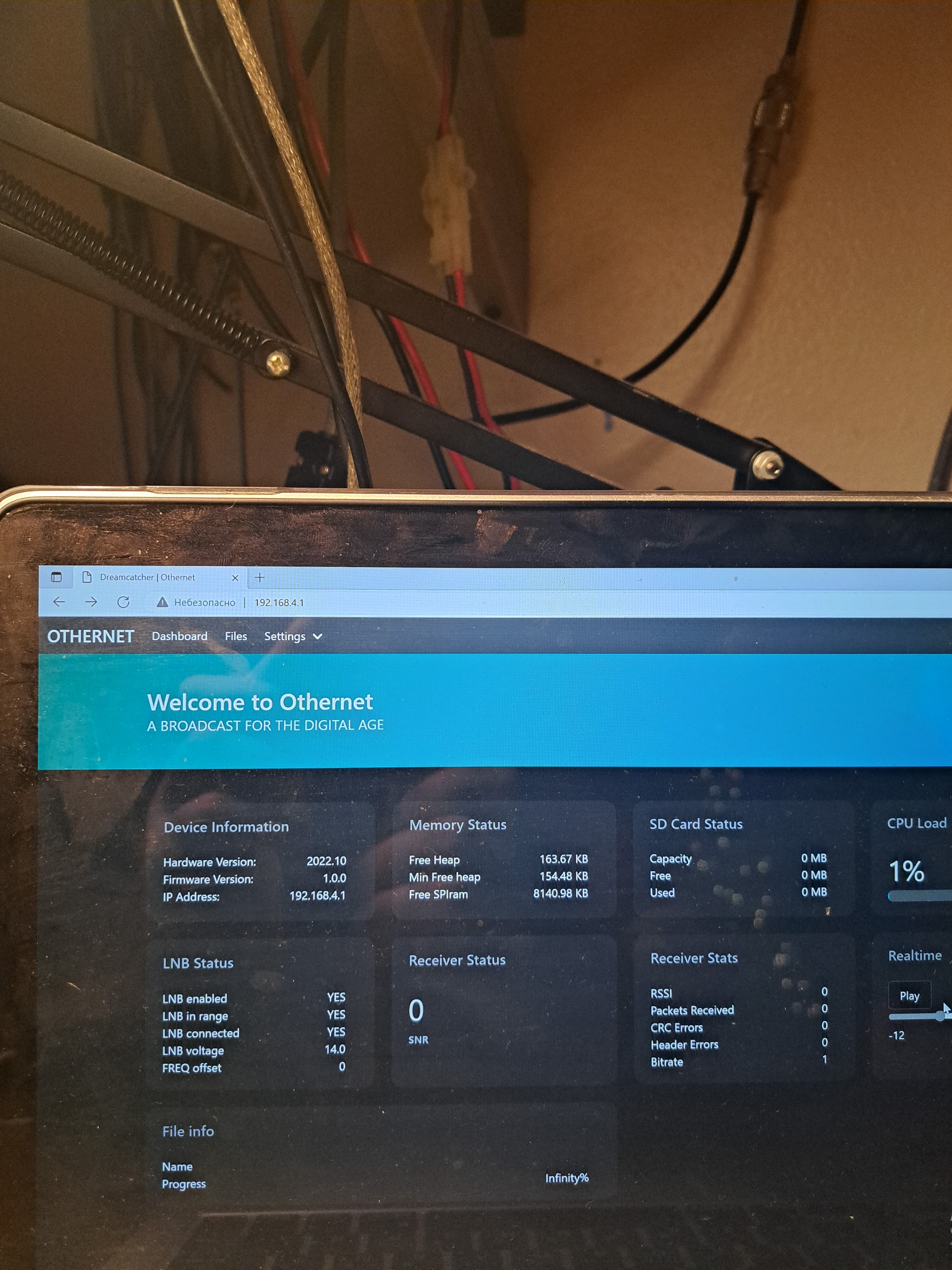

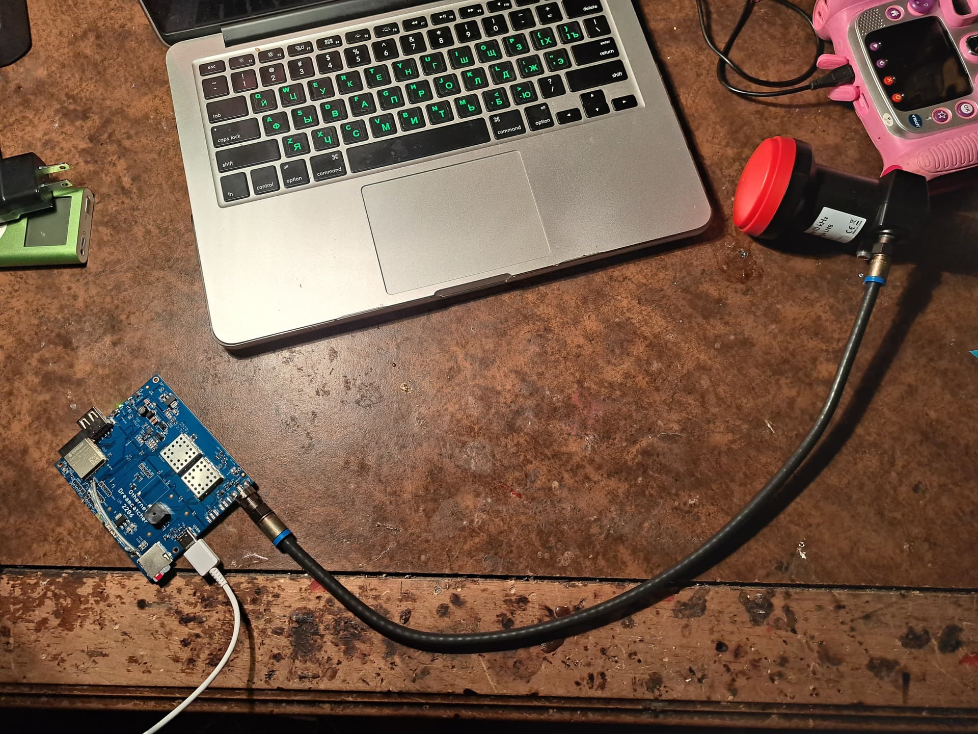

It looks like you have successfully connected to the UI. I think now you’ll need to point the LNB.

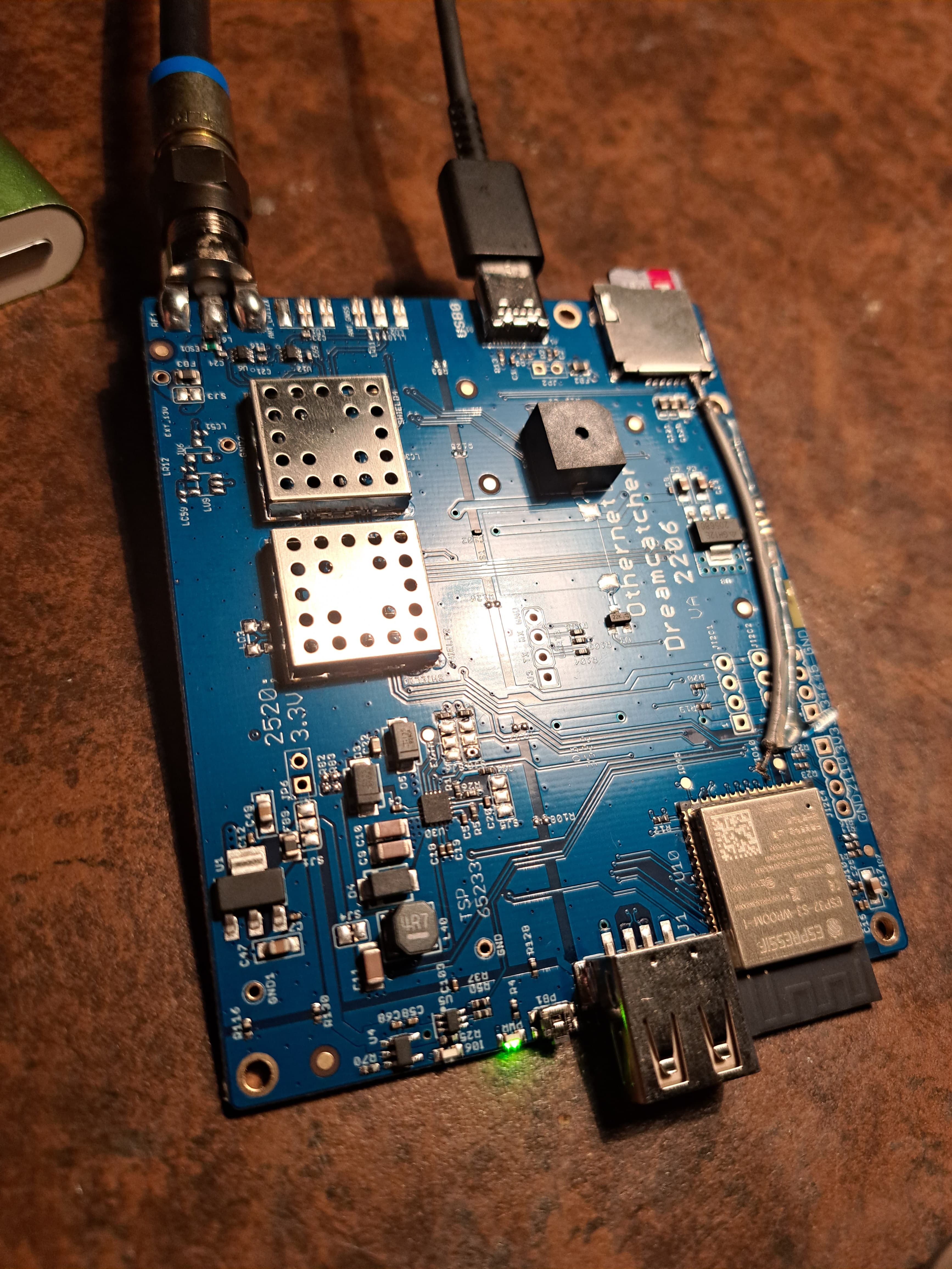

you hav e a 2206 board… look:Dreamcatcher $99 - #47 by Syed
are you try to use skylark image with this board? for this board there is a github repository…above link.

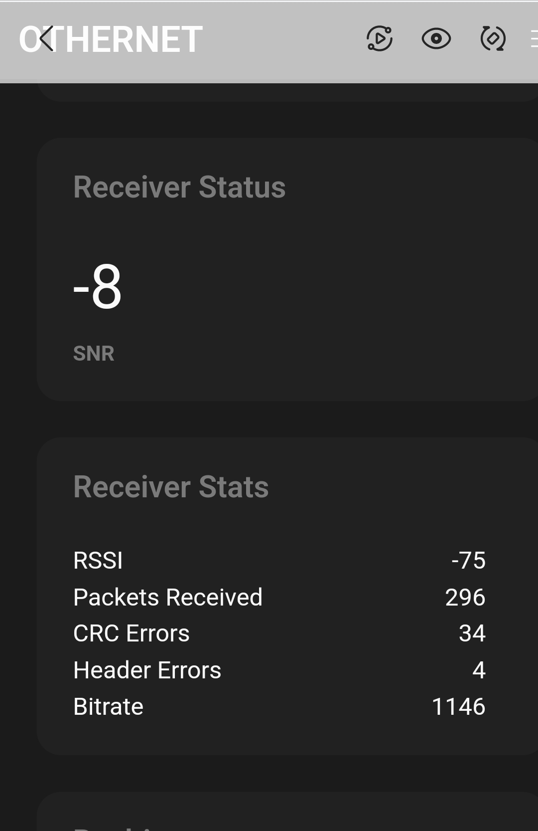

good enough I am at -7 and don’t have any packet loss and that’s what you are trying to avoid which is packet loss. Cant remember what the min signal strength number required for it to receive data successfully.
how long does it take to fully accept at least some file? 5 minutes, 2 hours? radio files will receive? aprs?
