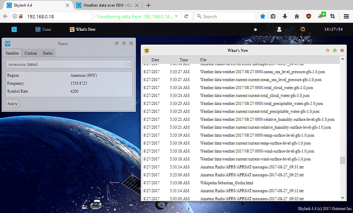

Hello, in the last 2 days I noticed that the data downloads are stuck for hours usually at night (my time zone is -4 utc) then it fixes itself and downloads data but those that correspond to the weather are not being updated. …the last prediction was for yesterday 23-08 … something is happening … since I have noticed in my 3 stations (RPI, DC and CHIP).
Can you please show me the output of:
ls -lR /mnt/Downloads/Weather

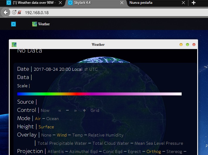

(or screenshots from the file manager showing the contents of the Weather folder and its subfolders.

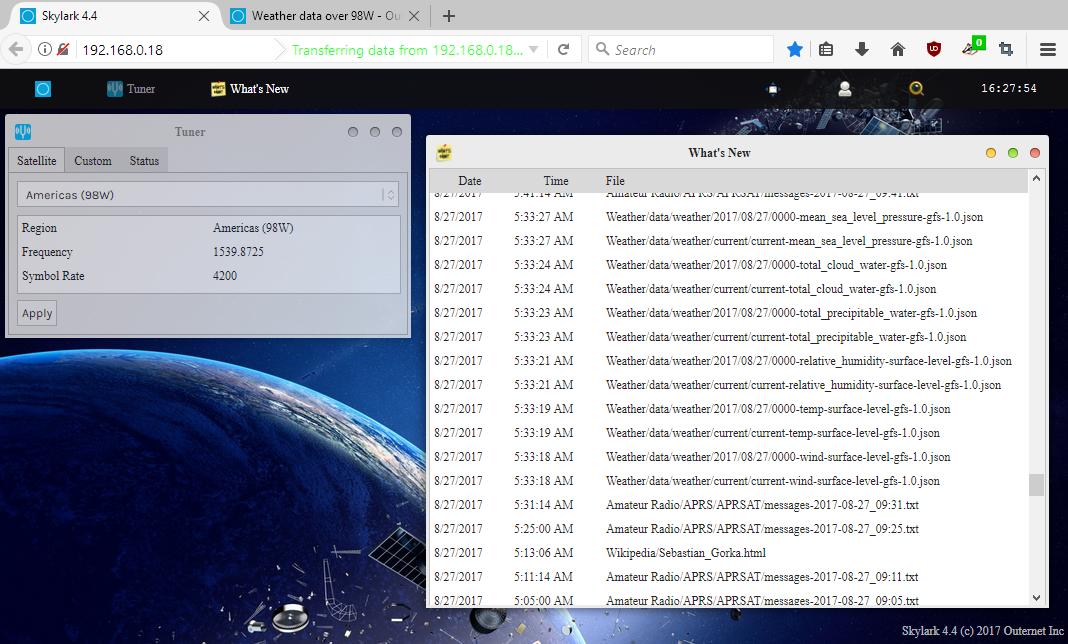

Also, the “System Messages” log in Log Viewer contains info about files that were successfully downloaded. That would help.

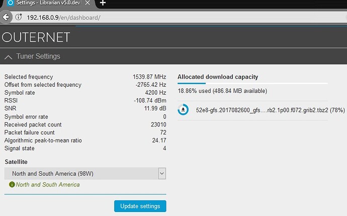

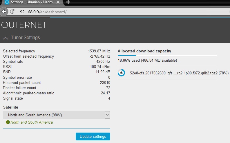

When it looks like its ‘stuck’, are packets being received correctly, at full rate? Does the SNR drop around that time?
The weather files are the largest files that go out, normally. If there is a signal issue (low snr or less than 100% frame lock), then there is a chance the files will not complete.

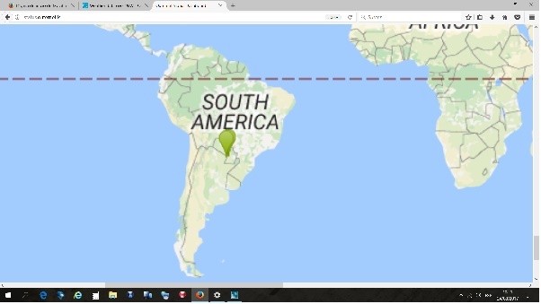

Could you try and spot your receiver on status.outernet.is and see if it reports 100% frame lock at the time when downloads appear stuck?
Hi, when I return home I will control and post the result of: ls -lR / mnt / Downloads / Weather, but anyway what if I can confirm is that there are no SNR problems, as for my status you can see 2 or 3 green globes in Paraguay in South America
, that’s me.
thanks for the support

drwxr-xr-x 12 outernet outernet 880 Aug 24 07:52 grib2
/mnt/downloads/Weather/data:
total 0
drwxrwxr-x 2 outernet outernet 336 Aug 23 01:14 oscar
drwxr-xr-x 4 outernet outernet 288 Aug 14 01:48 weather
/mnt/downloads/Weather/data/oscar:
total 5220
-rw-rw-r-- 1 outernet outernet 53 Aug 23 01:14 catalog.json
-rw-rw-r-- 1 outernet outernet 5341126 Aug 23 01:14 oscar_vel9082-surface-c urrents-oscar-0.33.json
/mnt/downloads/Weather/data/weather:
total 0
drwxr-xr-x 3 outernet outernet 224 Aug 14 01:48 2017
drwxr-xr-x 2 outernet outernet 768 Aug 21 07:50 current
/mnt/downloads/Weather/data/weather/2017:
total 0
drwxr-xr-x 14 outernet outernet 928 Aug 24 07:51 08
/mnt/downloads/Weather/data/weather/2017/08:
total 0
drwxr-xr-x 2 outernet outernet 768 Aug 14 01:49 14
drwxr-xr-x 2 outernet outernet 768 Aug 15 22:46 15
drwxr-xr-x 2 outernet outernet 768 Aug 15 21:23 16
drwxr-xr-x 2 outernet outernet 768 Aug 18 07:49 18
drwxr-xr-x 2 outernet outernet 768 Aug 18 05:23 19
drwxr-xr-x 2 outernet outernet 768 Aug 18 06:23 20
drwxr-xr-x 2 outernet outernet 768 Aug 18 08:49 21
drwxr-xr-x 2 outernet outernet 768 Aug 19 07:52 22
drwxr-xr-x 2 outernet outernet 768 Aug 20 08:22 23
drwxr-xr-x 2 outernet outernet 768 Aug 21 16:27 24
drwxr-xr-x 2 outernet outernet 768 Aug 23 11:46 26
drwxr-xr-x 2 outernet outernet 768 Aug 24 07:52 27
/mnt/downloads/Weather/data/weather/2017/08/14:
total 2688
-rw-r–r-- 1 outernet outernet 469200 Aug 14 01:49 0000-mean_sea_level_pre ssure-gfs-1.0.json
-rw-r–r-- 1 outernet outernet 189943 Aug 14 01:48 0000-relative_humidity- surface-level-gfs-1.0.json
-rw-r–r-- 1 outernet outernet 523109 Aug 14 01:48 0000-temp-surface-level -gfs-1.0.json
-rw-r–r-- 1 outernet outernet 177876 Aug 14 01:49 0000-total_cloud_water- gfs-1.0.json
-rw-r–r-- 1 outernet outernet 297725 Aug 14 01:49 0000-total_precipitable _water-gfs-1.0.json
-rw-r–r-- 1 outernet outernet 1082049 Aug 14 01:48 0000-wind-surface-level -gfs-1.0.json
/mnt/downloads/Weather/data/weather/2017/08/15:
total 2624
-rw-r–r-- 1 outernet outernet 469605 Aug 15 22:46 0000-mean_sea_level_pre ssure-gfs-1.0.json
-rw-r–r-- 1 outernet outernet 189546 Aug 15 22:46 0000-relative_humidity- surface-level-gfs-1.0.json
-rw-r–r-- 1 outernet outernet 457948 Aug 15 22:46 0000-temp-surface-level -gfs-1.0.json
-rw-r–r-- 1 outernet outernet 238516 Aug 15 22:46 0000-total_cloud_water- gfs-1.0.json
-rw-r–r-- 1 outernet outernet 296687 Aug 15 22:46 0000-total_precipitable _water-gfs-1.0.json
-rw-r–r-- 1 outernet outernet 1023594 Aug 15 22:46 0000-wind-surface-level -gfs-1.0.json
/mnt/downloads/Weather/data/weather/2017/08/16:
total 2736
-rw-r–r-- 1 outernet outernet 463947 Aug 15 21:23 0000-mean_sea_level_pre ssure-gfs-1.0.json
-rw-r–r-- 1 outernet outernet 189269 Aug 15 21:23 0000-relative_humidity- surface-level-gfs-1.0.json
-rw-r–r-- 1 outernet outernet 523109 Aug 15 21:23 0000-temp-surface-level -gfs-1.0.json
-rw-r–r-- 1 outernet outernet 243738 Aug 15 21:23 0000-total_cloud_water- gfs-1.0.json
-rw-r–r-- 1 outernet outernet 297348 Aug 15 21:23 0000-total_precipitable _water-gfs-1.0.json
-rw-r–r-- 1 outernet outernet 1071705 Aug 15 21:23 0000-wind-surface-level -gfs-1.0.json
/mnt/downloads/Weather/data/weather/2017/08/18:
total 3120
-rw-r–r-- 1 outernet outernet 465089 Aug 18 07:49 0000-mean_sea_level_pre ssure-gfs-1.0.json
-rw-r–r-- 1 outernet outernet 523121 Aug 18 07:49 0000-relative_humidity- surface-level-gfs-1.0.json
-rw-r–r-- 1 outernet outernet 523108 Aug 18 07:49 0000-temp-surface-level -gfs-1.0.json
-rw-r–r-- 1 outernet outernet 241673 Aug 18 07:49 0000-total_cloud_water- gfs-1.0.json
-rw-r–r-- 1 outernet outernet 298007 Aug 18 07:49 0000-total_precipitable _water-gfs-1.0.json
-rw-r–r-- 1 outernet outernet 1130735 Aug 18 07:49 0000-wind-surface-level -gfs-1.0.json
/mnt/downloads/Weather/data/weather/2017/08/19:
total 2600
-rw-r–r-- 1 outernet outernet 463300 Aug 19 08:55 0000-mean_sea_level_pre ssure-gfs-1.0.json
-rw-r–r-- 1 outernet outernet 188938 Aug 19 08:55 0000-relative_humidity- surface-level-gfs-1.0.json
-rw-r–r-- 1 outernet outernet 379434 Aug 19 08:55 0000-temp-surface-level -gfs-1.0.json
-rw-r–r-- 1 outernet outernet 236531 Aug 19 08:55 0000-total_cloud_water- gfs-1.0.json
-rw-r–r-- 1 outernet outernet 298234 Aug 19 08:55 0000-total_precipitable _water-gfs-1.0.json
-rw-r–r-- 1 outernet outernet 1083532 Aug 19 08:55 0000-wind-surface-level -gfs-1.0.json
/mnt/downloads/Weather/data/weather/2017/08/20:
total 2784
-rw-r–r-- 1 outernet outernet 465966 Aug 20 13:49 0000-mean_sea_level_pre ssure-gfs-1.0.json
-rw-r–r-- 1 outernet outernet 188940 Aug 20 13:49 0000-relative_humidity- surface-level-gfs-1.0.json
-rw-r–r-- 1 outernet outernet 523108 Aug 20 13:49 0000-temp-surface-level -gfs-1.0.json
-rw-r–r-- 1 outernet outernet 234633 Aug 20 13:49 0000-total_cloud_water- gfs-1.0.json
-rw-r–r-- 1 outernet outernet 297814 Aug 20 13:49 0000-total_precipitable _water-gfs-1.0.json
-rw-r–r-- 1 outernet outernet 1127756 Aug 20 13:49 0000-wind-surface-level -gfs-1.0.json
/mnt/downloads/Weather/data/weather/2017/08/21:
total 2788
-rw-r–r-- 1 outernet outernet 465902 Aug 21 07:50 0000-mean_sea_level_pre ssure-gfs-1.0.json
-rw-r–r-- 1 outernet outernet 188759 Aug 21 07:50 0000-relative_humidity- surface-level-gfs-1.0.json
-rw-r–r-- 1 outernet outernet 523108 Aug 21 07:50 0000-temp-surface-level -gfs-1.0.json
-rw-r–r-- 1 outernet outernet 237803 Aug 21 07:50 0000-total_cloud_water- gfs-1.0.json
-rw-r–r-- 1 outernet outernet 296463 Aug 21 07:50 0000-total_precipitable _water-gfs-1.0.json
-rw-r–r-- 1 outernet outernet 1129533 Aug 21 07:50 0000-wind-surface-level -gfs-1.0.json
/mnt/downloads/Weather/data/weather/2017/08/22:
total 2668
-rw-r–r-- 1 outernet outernet 464112 Aug 22 01:48 0000-mean_sea_level_pre ssure-gfs-1.0.json
-rw-r–r-- 1 outernet outernet 189052 Aug 22 01:48 0000-relative_humidity- surface-level-gfs-1.0.json
-rw-r–r-- 1 outernet outernet 523109 Aug 22 01:48 0000-temp-surface-level -gfs-1.0.json
-rw-r–r-- 1 outernet outernet 175668 Aug 22 01:48 0000-total_cloud_water- gfs-1.0.json
-rw-r–r-- 1 outernet outernet 297307 Aug 22 01:48 0000-total_precipitable _water-gfs-1.0.json
-rw-r–r-- 1 outernet outernet 1071404 Aug 22 01:48 0000-wind-surface-level -gfs-1.0.json
/mnt/downloads/Weather/data/weather/2017/08/23:
total 2724
-rw-r–r-- 1 outernet outernet 468512 Aug 21 17:40 0000-mean_sea_level_pre ssure-gfs-1.0.json
-rw-r–r-- 1 outernet outernet 188905 Aug 21 17:39 0000-relative_humidity- surface-level-gfs-1.0.json
-rw-r–r-- 1 outernet outernet 523109 Aug 21 17:39 0000-temp-surface-level -gfs-1.0.json
-rw-r–r-- 1 outernet outernet 174629 Aug 21 17:40 0000-total_cloud_water- gfs-1.0.json
-rw-r–r-- 1 outernet outernet 297302 Aug 21 17:39 0000-total_precipitable _water-gfs-1.0.json
-rw-r–r-- 1 outernet outernet 1122755 Aug 21 17:39 0000-wind-surface-level -gfs-1.0.json
/mnt/downloads/Weather/data/weather/2017/08/24:
total 2728
-rw-r–r-- 1 outernet outernet 467973 Aug 23 07:55 0000-mean_sea_level_pre ssure-gfs-1.0.json
-rw-r–r-- 1 outernet outernet 188557 Aug 23 07:55 0000-relative_humidity- surface-level-gfs-1.0.json
-rw-r–r-- 1 outernet outernet 523109 Aug 23 07:55 0000-temp-surface-level -gfs-1.0.json
-rw-r–r-- 1 outernet outernet 174752 Aug 23 07:55 0000-total_cloud_water- gfs-1.0.json
-rw-r–r-- 1 outernet outernet 297236 Aug 23 07:55 0000-total_precipitable _water-gfs-1.0.json
-rw-r–r-- 1 outernet outernet 1130132 Aug 23 07:55 0000-wind-surface-level -gfs-1.0.json
/mnt/downloads/Weather/data/weather/2017/08/26:
total 2724
-rw-r–r-- 1 outernet outernet 465537 Aug 23 11:46 0000-mean_sea_level_pre ssure-gfs-1.0.json
-rw-r–r-- 1 outernet outernet 188837 Aug 23 11:46 0000-relative_humidity- surface-level-gfs-1.0.json
-rw-r–r-- 1 outernet outernet 523109 Aug 23 11:46 0000-temp-surface-level -gfs-1.0.json
-rw-r–r-- 1 outernet outernet 174800 Aug 23 11:46 0000-total_cloud_water- gfs-1.0.json
-rw-r–r-- 1 outernet outernet 296369 Aug 23 11:46 0000-total_precipitable _water-gfs-1.0.json
-rw-r–r-- 1 outernet outernet 1129861 Aug 23 11:46 0000-wind-surface-level -gfs-1.0.json
/mnt/downloads/Weather/data/weather/2017/08/27:
total 2656
-rw-r–r-- 1 outernet outernet 467065 Aug 24 07:52 0000-mean_sea_level_pre ssure-gfs-1.0.json
-rw-r–r-- 1 outernet outernet 188609 Aug 24 07:52 0000-relative_humidity- surface-level-gfs-1.0.json
-rw-r–r-- 1 outernet outernet 457949 Aug 24 07:52 0000-temp-surface-level -gfs-1.0.json
-rw-r–r-- 1 outernet outernet 173732 Aug 24 07:52 0000-total_cloud_water- gfs-1.0.json
-rw-r–r-- 1 outernet outernet 296531 Aug 24 07:52 0000-total_precipitable _water-gfs-1.0.json
-rw-r–r-- 1 outernet outernet 1121460 Aug 24 07:52 0000-wind-surface-level -gfs-1.0.json
/mnt/downloads/Weather/data/weather/current:
total 2788
-rw-r–r-- 1 outernet outernet 465902 Aug 21 07:50 current-mean_sea_level_ pressure-gfs-1.0.json
-rw-r–r-- 1 outernet outernet 188759 Aug 21 07:50 current-relative_humidi ty-surface-level-gfs-1.0.json
-rw-r–r-- 1 outernet outernet 523108 Aug 21 07:50 current-temp-surface-le vel-gfs-1.0.json
-rw-r–r-- 1 outernet outernet 237803 Aug 21 07:50 current-total_cloud_wat er-gfs-1.0.json
-rw-r–r-- 1 outernet outernet 296463 Aug 21 07:50 current-total_precipita ble_water-gfs-1.0.json
-rw-r–r-- 1 outernet outernet 1129533 Aug 21 07:50 current-wind-surface-le vel-gfs-1.0.json
/mnt/downloads/Weather/grib2:
total 0
drwxr-xr-x 2 outernet outernet 248 Aug 14 01:49 gfs.2017081300
drwxr-xr-x 2 outernet outernet 336 Aug 15 22:46 gfs.2017081500
drwxr-xr-x 2 outernet outernet 336 Aug 18 06:23 gfs.2017081700
drwxr-xr-x 2 outernet outernet 512 Aug 18 10:24 gfs.2017081800
drwxr-xr-x 2 outernet outernet 424 Aug 19 09:47 gfs.2017081900
drwxr-xr-x 2 outernet outernet 512 Aug 20 20:23 gfs.2017082000
drwxr-xr-x 2 outernet outernet 512 Aug 22 01:48 gfs.2017082100
drwxr-xr-x 2 outernet outernet 248 Aug 22 08:42 gfs.2017082200
drwxr-xr-x 2 outernet outernet 336 Aug 23 11:46 gfs.2017082300
drwxr-xr-x 2 outernet outernet 248 Aug 24 07:52 gfs.2017082400
/mnt/downloads/Weather/grib2/gfs.2017081300:
total 320
-rw-rw-r-- 1 outernet outernet 325065 Aug 14 01:13 gfs.t00z.pgrb2.1p00.f02 4.grib2
/mnt/downloads/Weather/grib2/gfs.2017081500:
total 672
-rw-rw-r-- 1 outernet outernet 337261 Aug 15 07:13 gfs.t00z.pgrb2.1p00.f00 0.grib2
-rw-rw-r-- 1 outernet outernet 344111 Aug 15 07:13 gfs.t00z.pgrb2.1p00.f02 4.grib2
/mnt/downloads/Weather/grib2/gfs.2017081700:
total 680
-rw-rw-r-- 1 outernet outernet 347483 Aug 17 07:13 gfs.t00z.pgrb2.1p00.f04 8.grib2
-rw-rw-r-- 1 outernet outernet 347975 Aug 17 07:14 gfs.t00z.pgrb2.1p00.f07 2.grib2
/mnt/downloads/Weather/grib2/gfs.2017081800:
total 1356
-rw-rw-r-- 1 outernet outernet 335931 Aug 18 07:13 gfs.t00z.pgrb2.1p00.f00 0.grib2
-rw-rw-r-- 1 outernet outernet 346532 Aug 18 07:13 gfs.t00z.pgrb2.1p00.f02 4.grib2
-rw-rw-r-- 1 outernet outernet 345732 Aug 18 07:13 gfs.t00z.pgrb2.1p00.f04 8.grib2
-rw-rw-r-- 1 outernet outernet 348379 Aug 18 07:13 gfs.t00z.pgrb2.1p00.f07 2.grib2
/mnt/downloads/Weather/grib2/gfs.2017081900:
total 1008
-rw-rw-r-- 1 outernet outernet 334073 Aug 19 07:13 gfs.t00z.pgrb2.1p00.f00 0.grib2
-rw-rw-r-- 1 outernet outernet 347683 Aug 19 07:13 gfs.t00z.pgrb2.1p00.f04 8.grib2
-rw-rw-r-- 1 outernet outernet 347118 Aug 19 07:13 gfs.t00z.pgrb2.1p00.f07 2.grib2
/mnt/downloads/Weather/grib2/gfs.2017082000:
total 1332
-rw-rw-r-- 1 outernet outernet 336146 Aug 20 13:13 gfs.t00z.pgrb2.1p00.f00 0.grib2
-rw-rw-r-- 1 outernet outernet 324991 Aug 20 13:13 gfs.t00z.pgrb2.1p00.f02 4.grib2
-rw-rw-r-- 1 outernet outernet 346260 Aug 20 13:13 gfs.t00z.pgrb2.1p00.f04 8.grib2
-rw-rw-r-- 1 outernet outernet 344750 Aug 20 07:14 gfs.t00z.pgrb2.1p00.f07 2.grib2
/mnt/downloads/Weather/grib2/gfs.2017082100:
total 1316
-rw-rw-r-- 1 outernet outernet 340122 Aug 21 07:13 gfs.t00z.pgrb2.1p00.f00 0.grib2
-rw-rw-r-- 1 outernet outernet 325929 Aug 22 01:13 gfs.t00z.pgrb2.1p00.f02 4.grib2
-rw-rw-r-- 1 outernet outernet 324800 Aug 21 07:14 gfs.t00z.pgrb2.1p00.f04 8.grib2
-rw-rw-r-- 1 outernet outernet 344079 Aug 21 07:14 gfs.t00z.pgrb2.1p00.f07 2.grib2
/mnt/downloads/Weather/grib2/gfs.2017082200:
total 316
-rw-rw-r-- 1 outernet outernet 321806 Aug 22 07:13 gfs.t00z.pgrb2.1p00.f04 8.grib2
/mnt/downloads/Weather/grib2/gfs.2017082300:
total 636
-rw-rw-r-- 1 outernet outernet 321498 Aug 23 07:13 gfs.t00z.pgrb2.1p00.f02 4.grib2
-rw-rw-r-- 1 outernet outernet 325328 Aug 23 07:13 gfs.t00z.pgrb2.1p00.f07 2.grib2
/mnt/downloads/Weather/grib2/gfs.2017082400:
total 320
-rw-rw-r-- 1 outernet outernet 324494 Aug 24 07:14 gfs.t00z.pgrb2.1p00.f07 2.grib2

Hi, I posted the output of my 3 outernet stations, in the same situation, not showing the weather prediction for today 24-08-2017 and the nex days …
You do have most of the files. So I am not sure why you aren’t seeing the predictions. Still thinking…
I noticed that there are more holes amongst the recent files. Lets wait and watch a couple days.
Yes, it’s strange…but I will be the only one?:laughing: Will have to see if other users who are connected to the 98W comment if it happens to them the same …
Thats a good question. Lets see if others report problems. As far as I can see the backend looks fine.

Well, after controlling I can conclude that something is not working well, is the third time in the week that I see files that are being downloaded and locked there for hours, yesterday this file
was like this for 10 hours or more, and again I have Prediction of the climate only until today 27-08, is there anyone who can give feedback on it?

your packet count is low - are you keeping the receiver up 24x7?
if you reboot frequently, files (esp the larger weather files) can fail to complete.
You see few packages because I just had to restart to see if it was fixed … but not.
As I said from the beginning, this is happening with my 3 stations, all different, CHIP, Dreamcatcher and Raspberry PI, will I be bewitched?:laughing:
