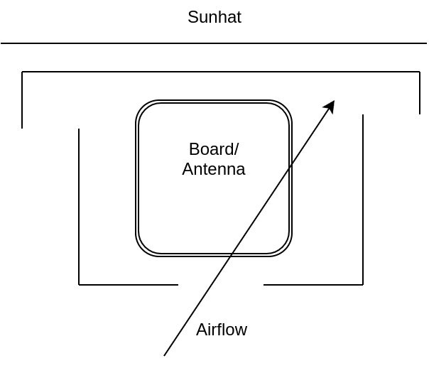

Thinking about it I wonder if it should be designed for passive ventilation/ sun protection?
Rough sketch below
I don’t think that would help that much, but some vents in the bottom would be more than enough.
In my Design the Hardware is protected against the sun by the Patch Antenna and the front of the case.
As mentioned before, i had no heat issues so far.
