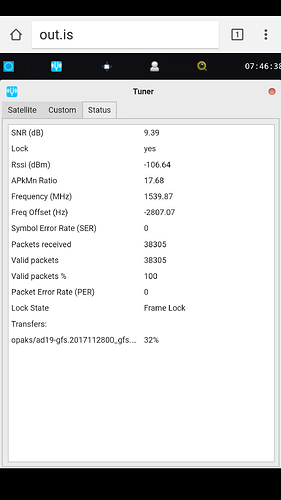

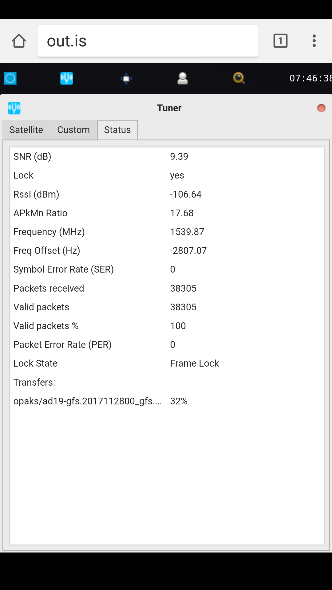

Hi Andrey,
which component in “the package” you got from Syed fixed your problem? Or did you replace the whole system?
I really like to understand what made the difference
thanx
luigi
I got replacement new LNA
