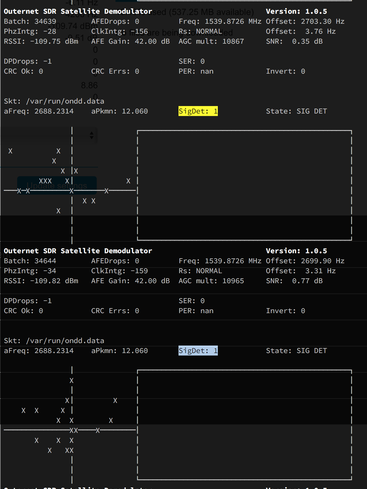

Here’s what I am seeing:
Most batches are failing to see a signal and State stays as SEARCH. But early on In some batches I get a SigDet and State goes to SIGDET. SNR hits over 1dB. So unless those are false detections it seems like it is finding something, however very weak.
What can I do?
Your signal is definitely too low, and sig det only means something that looks like a PSK signal was detected.

At that signal, first step would be to experiment with changing locations, playing around with the antenna direction. Until the signal strength is atleast ~2dB stable, the software isn’t going to be able to lock on.
