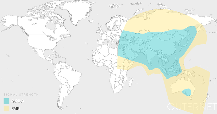

@sun1 Are you able to see the Outernet radio channel when you do a blind scan with a normal FTA receiver? You can find the transponder settings here: https://wiki.outernet.is/wiki/Coverage_and_transponder_settings#AsiaSat_5
AsiaSat 5
Position 100.5°E
Coverage Middle East, Asia, Australia
Band C
Frequency 3,960 MHz
Symbol Rate 30,000 kbaud
Polarization Horizontal
Delivery DVB-S
Modulation QPSK
