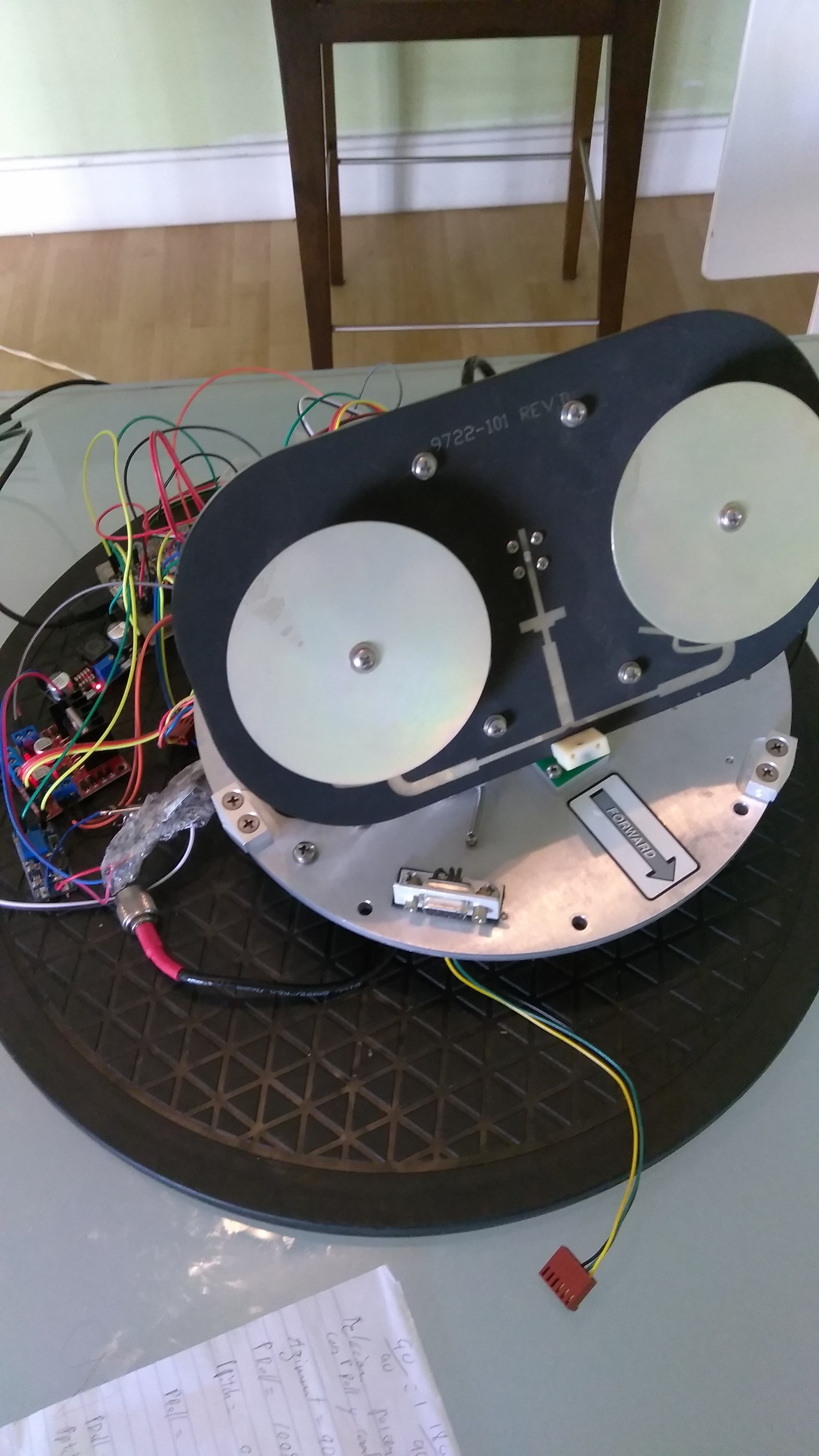

I luckly bought a kvh 25 for 40$ and changed the circuit to convert it to an internet antenna… Those where designed for L band… so in theory it should work nicely…
Any luck as a Outernet antenna?
Right now it stabilizes correctly, the only issue is finding the north, but if its oriented manually… keeps the orientation no matter what you do. So in theory good enough. I’ll make a webpage with the materials and code when it’s finished.
