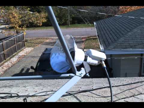

And here are a few pictures of some other homemade 12 GHz antennas.

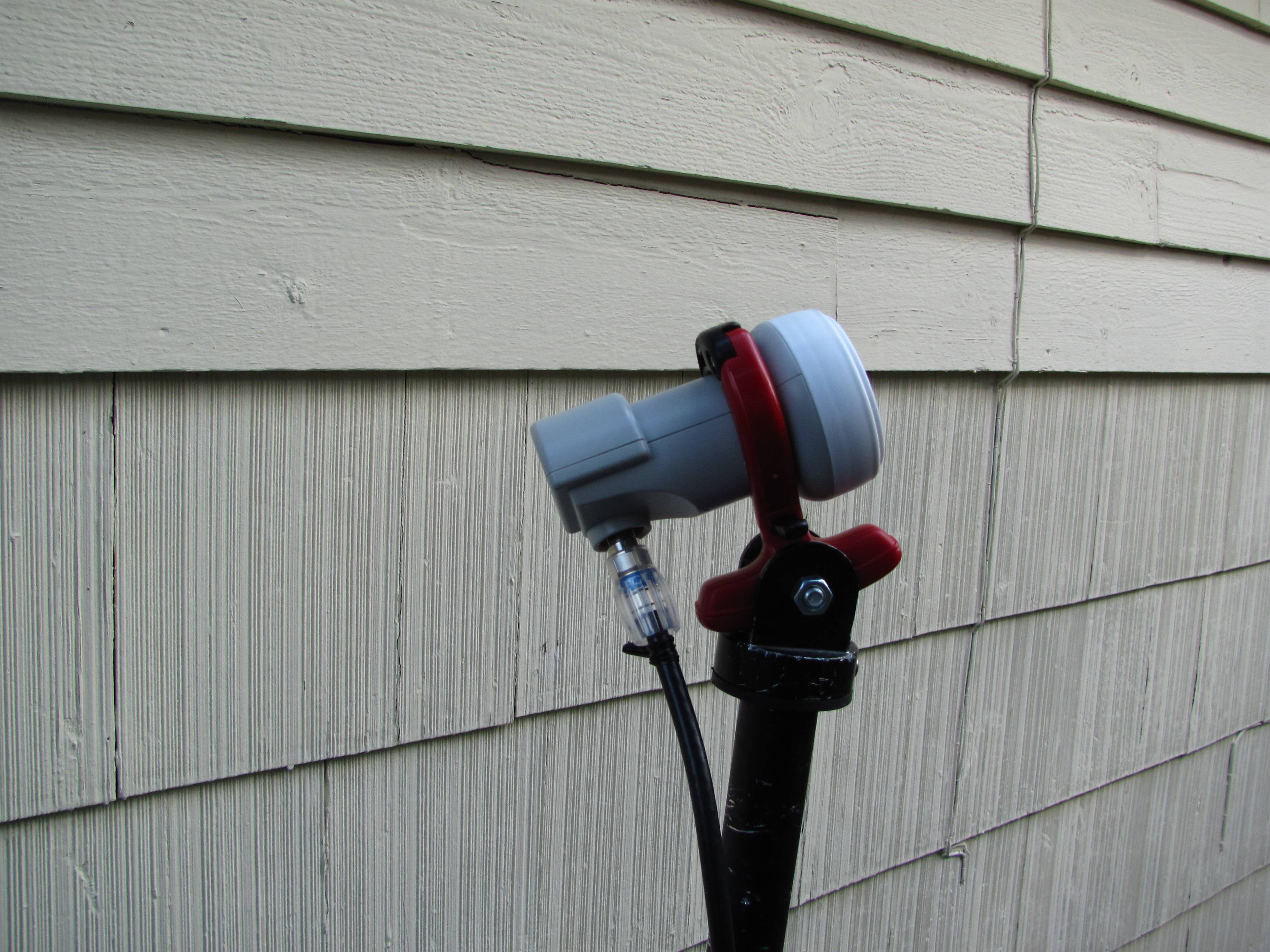

Just eyeballing - - and I had a shape I could wrap around. In was looking at the cone as a noise shield, but the wave guide idea is interesting. Ken
If you pointed the cone-less antenna at the edge of reception–at a place you are getting -20 dB SNR, what impact does the cone have?
Interesting question with unusual results. My edge of reception has an SNR of -14 dB with my lock coming and going. When I put the cone on the LNB at that point and aim it along the LNB’s direct axis to the sky, I get no change in SNR or Lock/Unlock status. But if I turn the cone in the direction of the satellite in the sky without moving the LNB, I get constant Lock and my SNR shoots up to - 9.5 to -10 dB.
I also got the same results today with the LNB pointed correctly. Without the cone, my SNRs were in -12 dB range with constant lock. With the cone over the LNB, pointing to the satellite, my SNRs went up to the -8.5 to - 9.5 dB range. What I did notice today (which I wasn’t looking for in my first test), was with correct LNB orientation, I could get the SNR to go into the -7.5 dB range by just sweeping the cone a bit in the general direction of the satellite.
Are we talking wave guide here, or still noise reduction? Ken

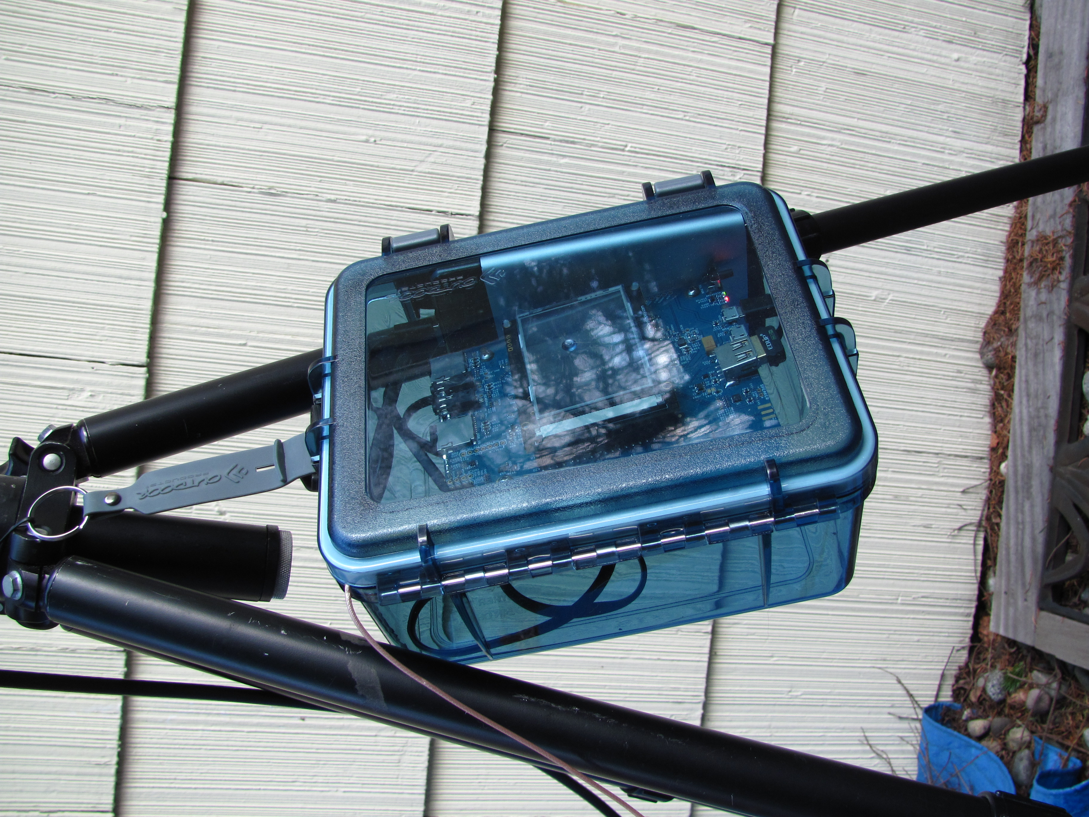

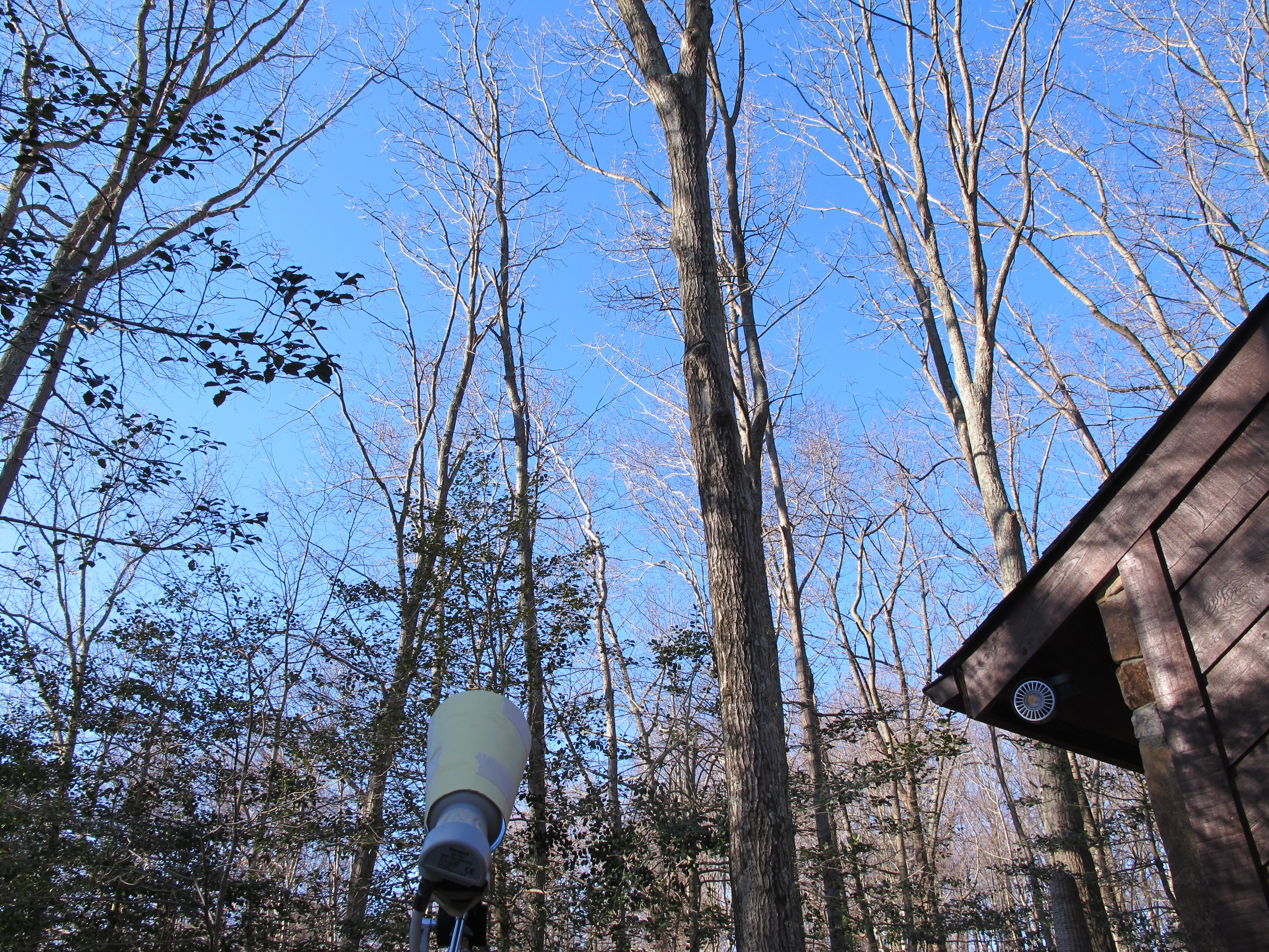

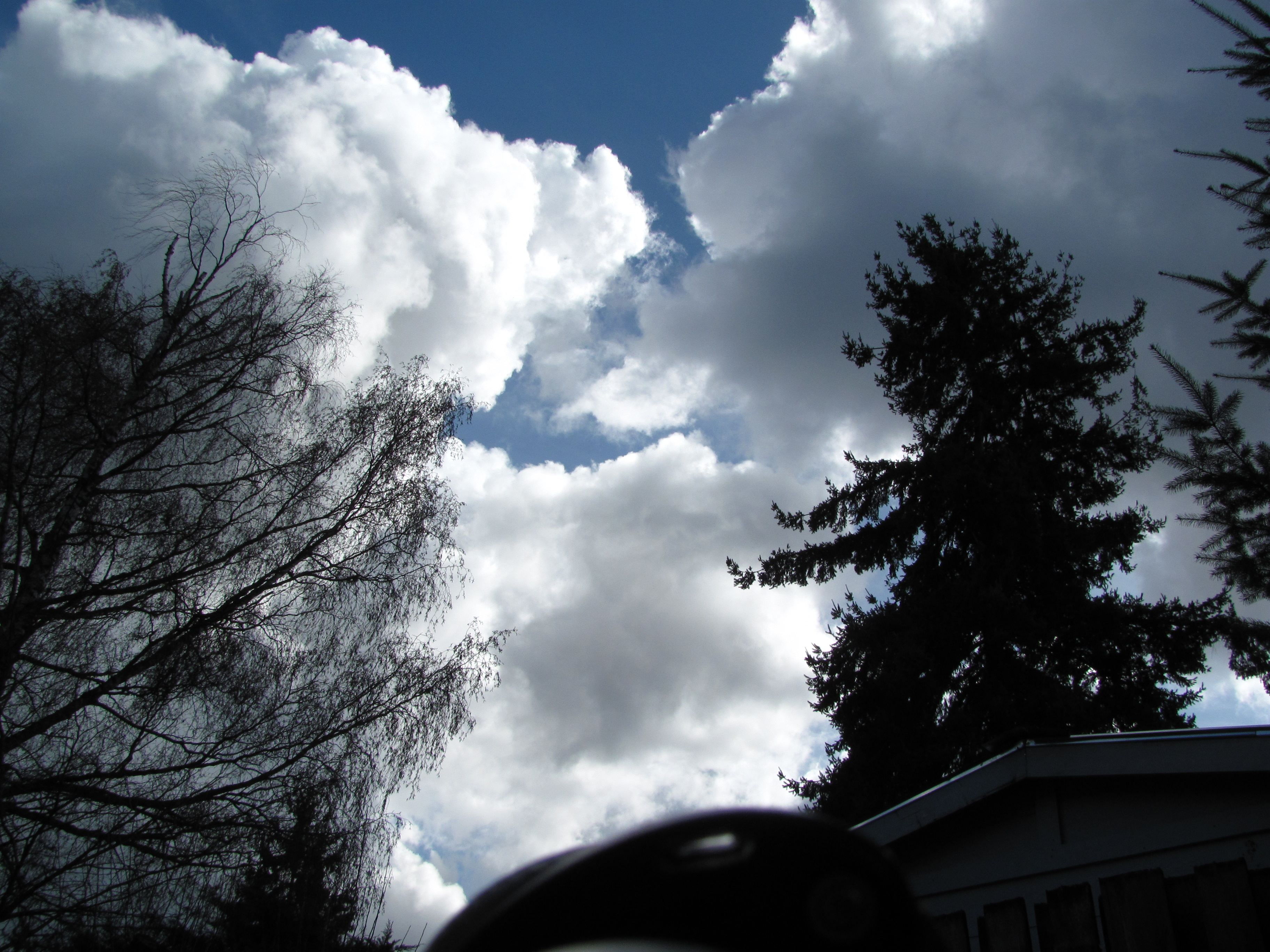

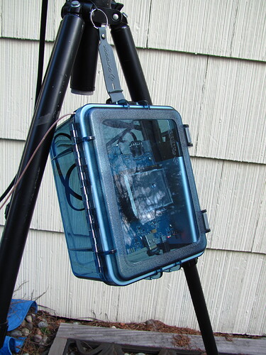

Here are some photos of my setup…
I found a particular spot where I can ā€œseeā€ SES-2 through the trees
My DreamCatcher is in a waterproof box with a LiPo battery in it. (Sorry the photo is sideways)
I’m almost done with getting my DreamCatcher powered over Ethernet. The TP-link Ethernet dongle works in place of the Wi-Fi dongle. I have some construction to do for running the Ethernet and coax through the plastic box and installing the PoE hardware. It should be up later during the week.

Update on Aluminum Cone
With aluminum cone installed, I can now operate close to my house with a partially obstructed view of SES-2 thru the trees;
Good SNRs with signal lock and downloads occurring - -
