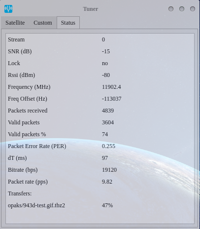

It looks like I got a lock at the parking garage. Here’s the best screen shot that I could take one-handed (The other hand was holding the LNB):
I also found a spot next to the house that might be a good candidate for a more permanent location. I was not able to get a lock there, but probably could if I fiddled with it some.
I hope this will help with the LNB frequency correction.

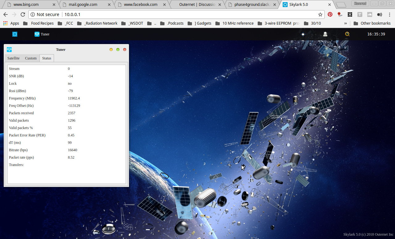

looks like im also still figting a snr ratio bug which is making me drop lock at random
For reliably receiving all files - including the fast-flux ones like the messages, your balloon on the status map should show green on the second map (Frame Lock).
That’s my issue I drop lock alot
whats your bitrate?
anything below 16000 is too low.
looks like i need to go and work on my mount then…

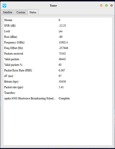

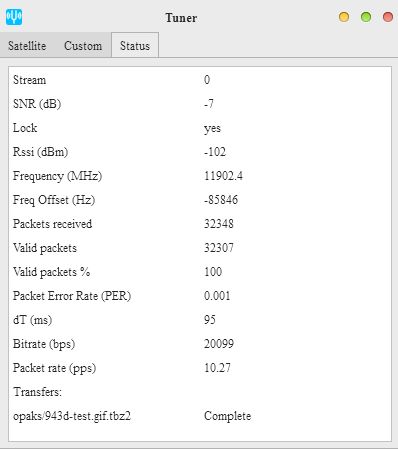

Hey, @Abhishek, @Syed after i changed out my short RG-6 (15") for the 20’, I am unable to get snr under 14. I have re-aimed the LNB numerous times trying to find a better position, and it has a clear shot at the sky. I would also mention that 11000 is about the top bitrate I have observed at any time. Are we going to be bound to keep the LNB close to the DC3 by short cabling? I know the rf loss is high on any coax at these frequencies, but I did use the best I could find, and it is rated for 3 Ghz.
I’m using a free-to-air (FTA) LNB/80 cm dish - - so maybe I’m cheating to get good service.

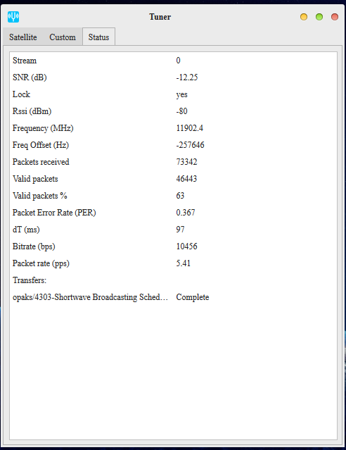

That said, my always locked signal looks like this:
I have set up the Maverick near my FTA antenna and also get good (but not as good) service - - so your comment is very significant and disturbing. Ken
Those are some really cool stats. I am interested in knowing if the coax is the factor affecting it. Mine look better tonight than they did all day, and the bitrate is up some also now. Nothing has been changed. So where does one see one of these FTA antennae? (I’m pretty ignorant along those lines just yet).
