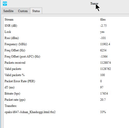

Are you seeing any files complete? What were the last few files that were successfully downloaded?
My test receivers are working fine, with all latest files downloading normally.
Edit: I guessed from the telemetry log that the receiver still reporting “adnan khashoggi” file as being the currently downloading one is yours (adnan khashoggi file went off the carousel two days back). You seem to be receiving packets but somehow the downloads are not progressing. Your rssi is also about 20db lower than normal. Try rebooting the rx. Is audio playing for you?

I am now getting good SNR, Rssi, and showing downloads of files/audio after I rebooted my Dreamctcher at 0849 EDT Oct 18. Prior to this reboot, my latest news was from Oct 12 on all RSS feeds. Ken

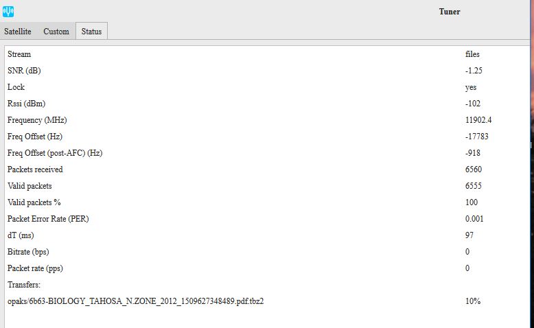

My Rssi always runs in the -100s due to my LNB being 500 feet away in my antenna farm. At the base of the antenna, I get Rssis in the - 70s. Ken

I have noted since Syed’s modem replacement, SNRs running between -2 and 0 this week. This is about 6 to 9 dB better than before. Have you noticed that in your gear? Ken

Ken, yes sir. I now see peaks of +7 SNR. And RSSI arround -68. The new modem now is the way to go.
