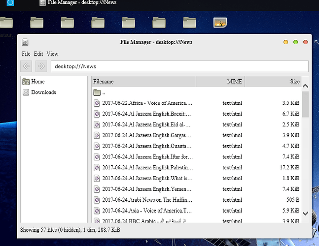

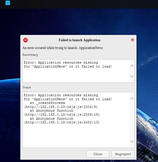

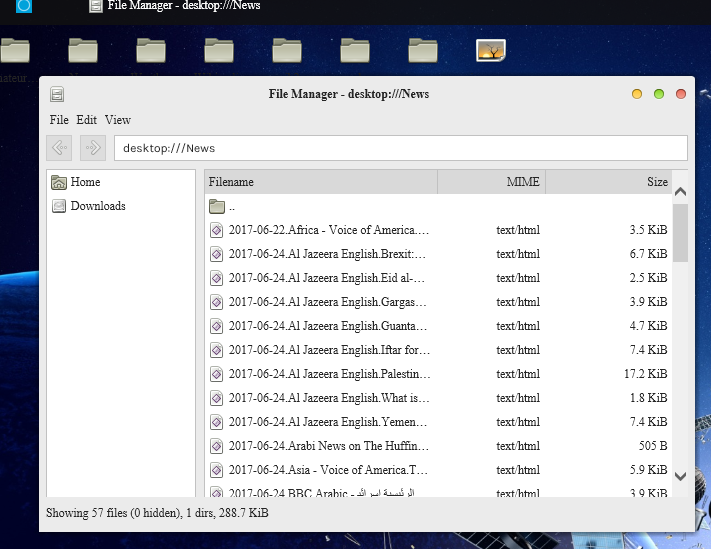

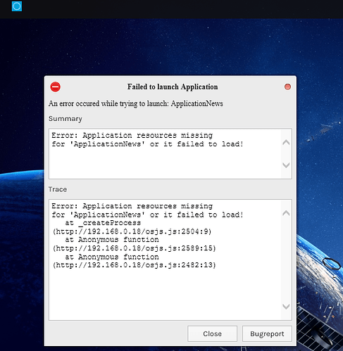

Skylark running on Dreamcatcher - opening News App Icon
Stuff is in the news folder – just can’t see it

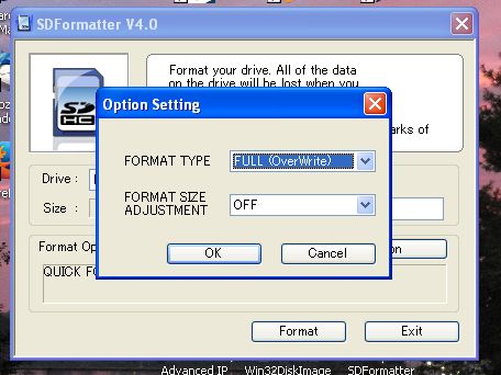

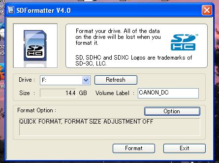

I used SD Formatter Version 4.0 from SD Memory Card Formatter for Windows Download | SD Association
I run it on my Windows XP or Windows 10 computer. After plugging in an SD card to my computer, I see (for this example) an F drive size 14.4 GB called CANON_DC"
In Format Option, I select FULL (OverWrite) and leave FORMAT SIZE ADJUSTMENT OFF
It takes awhile on a large SD card, but it worked fine for me yesterday.

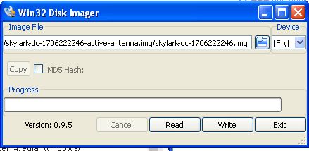

Then I used _Win32 Disk Imager f_rom Win32 Disk Imager download | SourceForge.net to write the Skylark image.
I hope this helps. Ken
