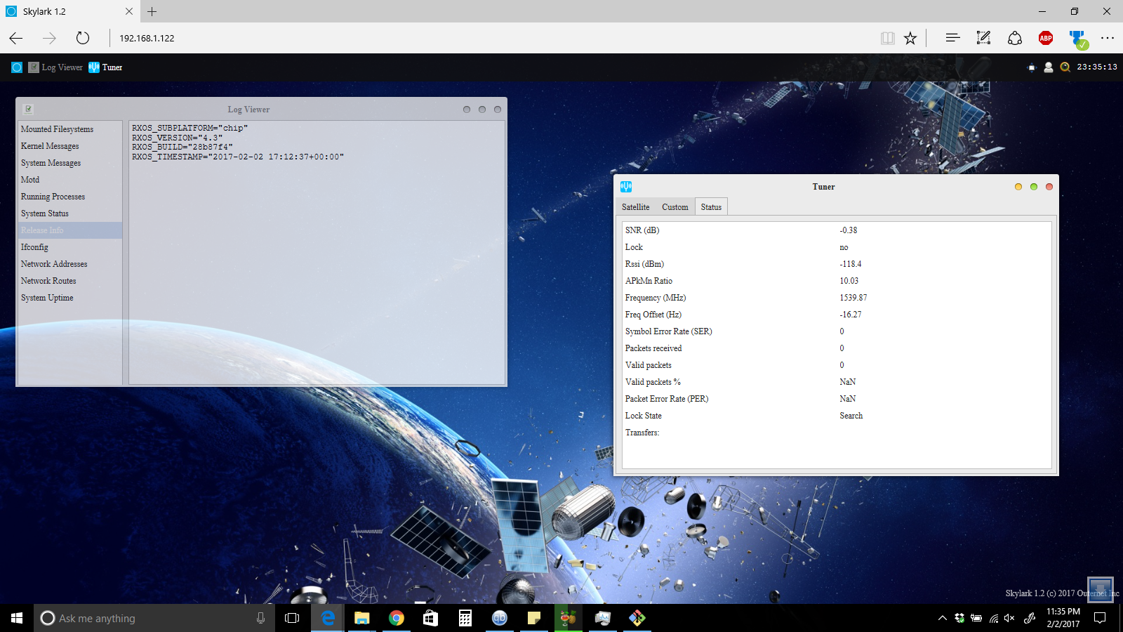

Also I have noticed that the âTunerâ app doesnât appear to be working properly. I canât see the status info.

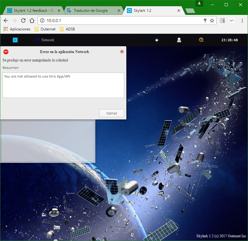

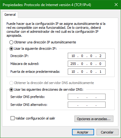

He descargado el archivo, y lo he actualizado desde el ordenador, actualizĂł bien, me creĂł el punto de acceso wifi, pero el ordenador no se asocia correctamente, no recibe ip, lo he solucionado poniendo a mano la ip.
Al iniciar el icono del wifi me da un error, y no me reinicia ni me guarda la configuraciĂłn de red que le pongo.

I downloaded the file, and I updated it from the computer, updated well, I created the wifi access point, but the computer is not associated correctly, does not receive ip, I have solved putting the hand by ip.

You may have logged in as guest? Try logging in again as outernet like before.
Seguro que es eso, lo pruebo ahora.
Sure is that, I prove it now.
I canât think of anything else right now, may as well try neilâs procedure.
Arreglado, era eso, accedĂ como administrador y todo perfecto, ya estĂĄ funcionando, conectado al router y descargando archivos de Alphasat sin problemas por ahora.
Translation:
Fixed, that was, I agreed as administrator and everything perfect, is already working, connected to the router and downloading Alphasat files without problems for now.
Went static on wlan outernet and applied. Looks okay now.

After waiting couple days I updated my using file manager. CHIP refreshed automatically after few minutes. I was able to connect to chip wifi no issues, but turner apps I donât see signal level any more.
