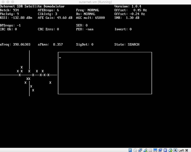

Hi guys! I can not receive a signal with alpasat I’m in Moscow. can you tell something

Yes, I know about the frequency change alphasat, but the signal on the new frequencies also does not. I’m using the virtual box with the ubuntu guest system. at the moment I’m doing the code under python and docker so it’s more convenient (imho)

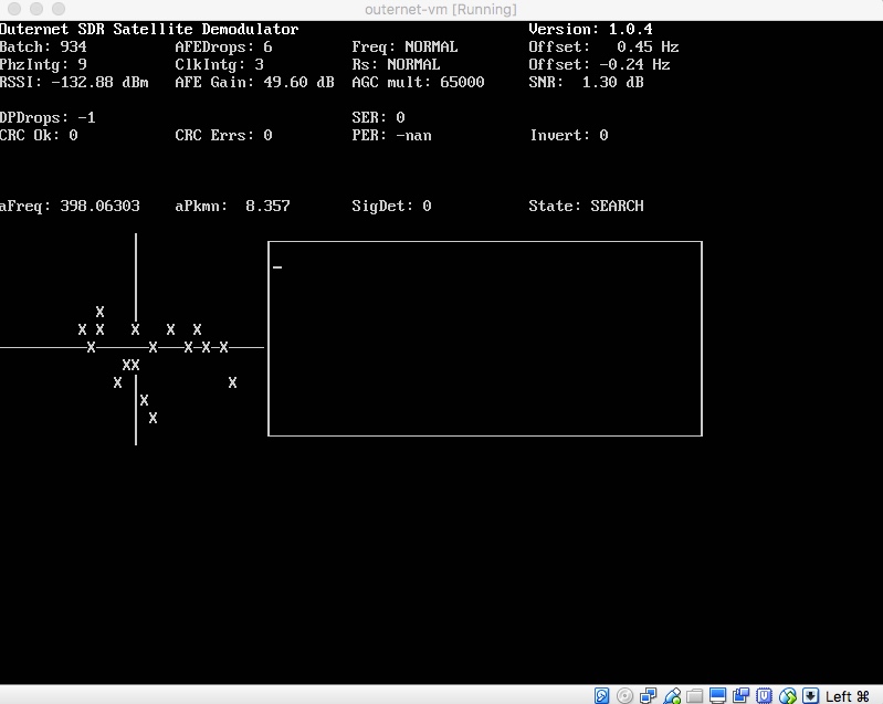

I’m 99% sure that you LNA is down… -132 dBm RSSI is only RTL-SDR internal noise, no signal from LNA. You might forgotten turning on the bias tee in your RTL-SDR:

No! You should have signal there… If your LNA works absolutely sure then you have a disconnected (open circuit) RF path somewhere. Again, as mentioned the -132 dBm RSSI means absolutely no RF energy gets into your RTL-SDR (not even the self noise of LNA without antenna).
You might not using your RTL-SDR in quadrature mode so listening the wrong ADC channel… or you have HW problems as descirbed above, those are my last guesses.

Hello! I’ve still checked and I’m not sure that the RSSI is the raw rf signal level
I can not change mode sdr -rtl for quadrature demodulation.
all actions for signal reception and demodulation make sdr100 binary.
what comes inside the sdr100 secret because there is no source code.
sdr100 does not have any documentation and the sdr100 -help command does not give all the values accepted by the program. example:

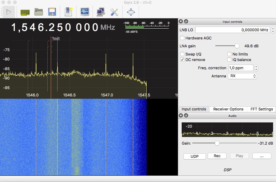

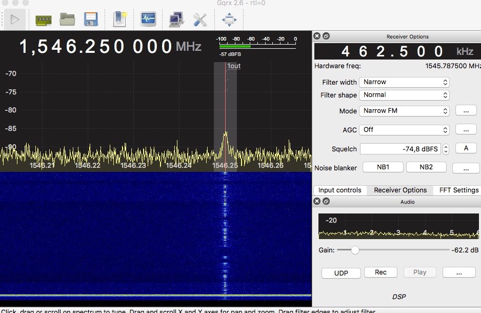

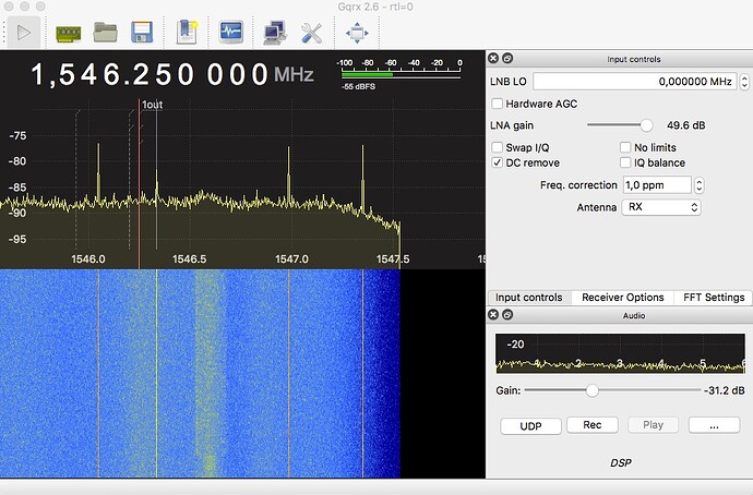

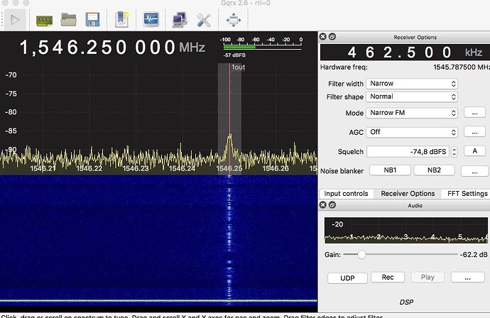

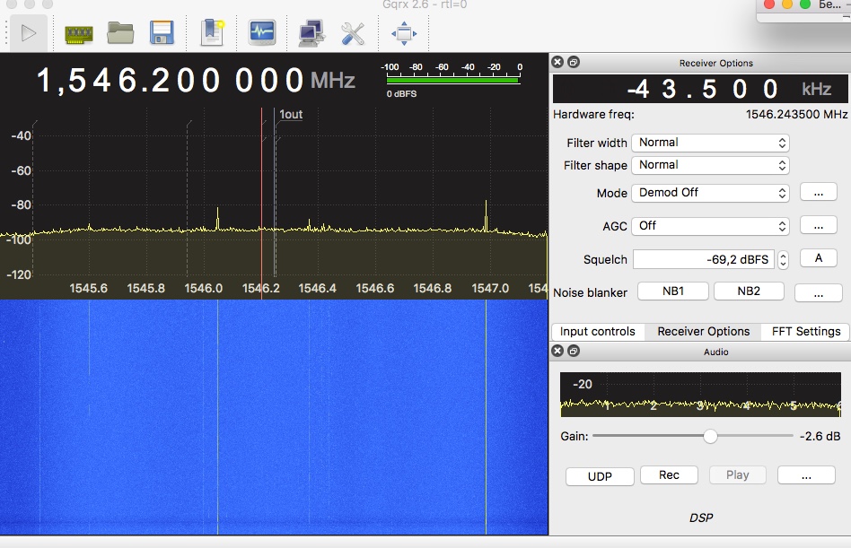

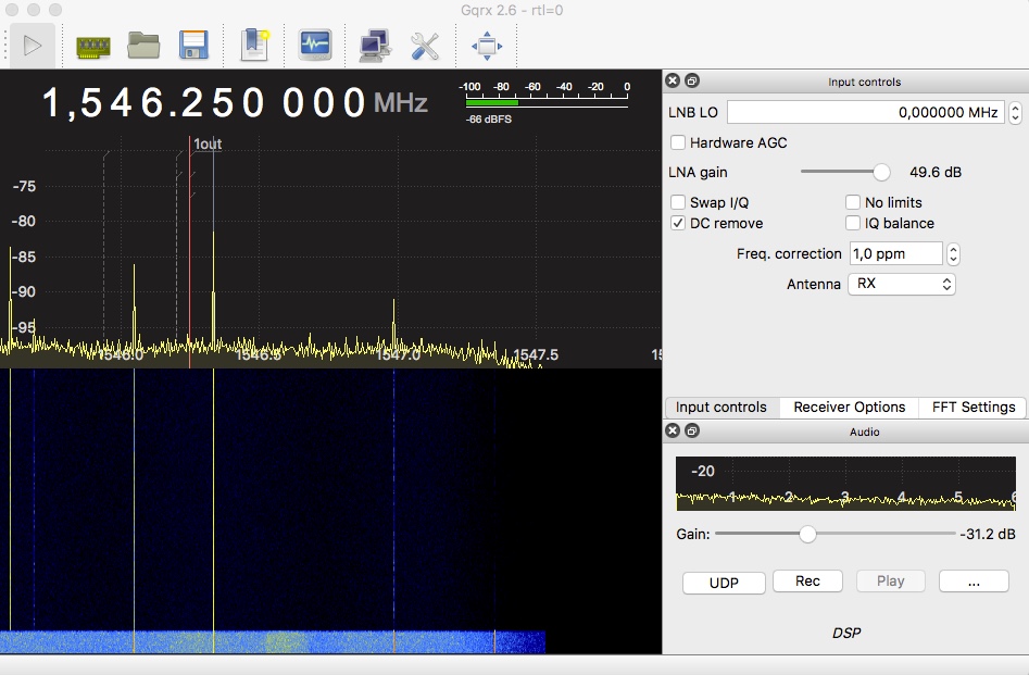

I’ll attach 2 more screenshots from gqrx with lna turned on and off
as seen in the screenshot with the included lna a very weak signal at at 1546.25mhz is there but it does not match the declared width of 4khz
LNA UP:
LNA DOWN:

Could it be that you are using a wide band RF amp and the signal is lost in all the noise?
you can tell what that narrowly directed lna, max12000 in my country can not find
try to get this, it has a SAW filter inside:
Any narroband GPS LNA would do the job too. BTW I don’t see real signals on your spectrum plot but strong noise etc. only… Does your antenna oriented well? Is it on the roof etc?

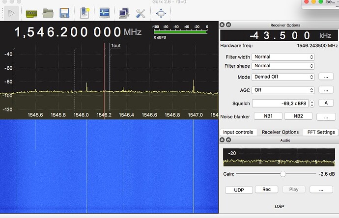

hello, I listened to your advice and ordered lna nooelec. while I’m waiting for the delivery, I rebuilt the helical antenna with an approximate gain of 16dbi and connected it to homemade lna based on upc8211 and that’s what happened
The demodulator still does not see the signal and shows rssi -130
hmmm… interesting this still looks like some internal noise of your SDR it’s not a sat signal…
if you have access to a VNA try to analyze your antenna. Also check your coax cables against open circuit faliure.
