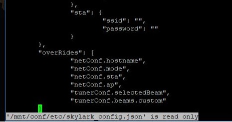

Hi zolt,
Was able to edit the file but after :wq, the file is READ ONLY!
Also I have ERRORS during boot.
Please let me know how to fix all this error.
Thanks and BR.
Joey
make sure you are SUDO… so use "sudo vi … "
also the ondd error is benign. you can ignore that…

sudo vi /mnt/conf/etc/skylark_config.json
when asked for a password, use the password for the “outernet” user.

hi nbkhwjm,
now is ok, was able to edit and saved the file. will try to set the antenna and hope to get a good reception.
