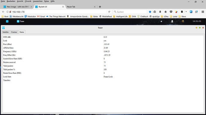

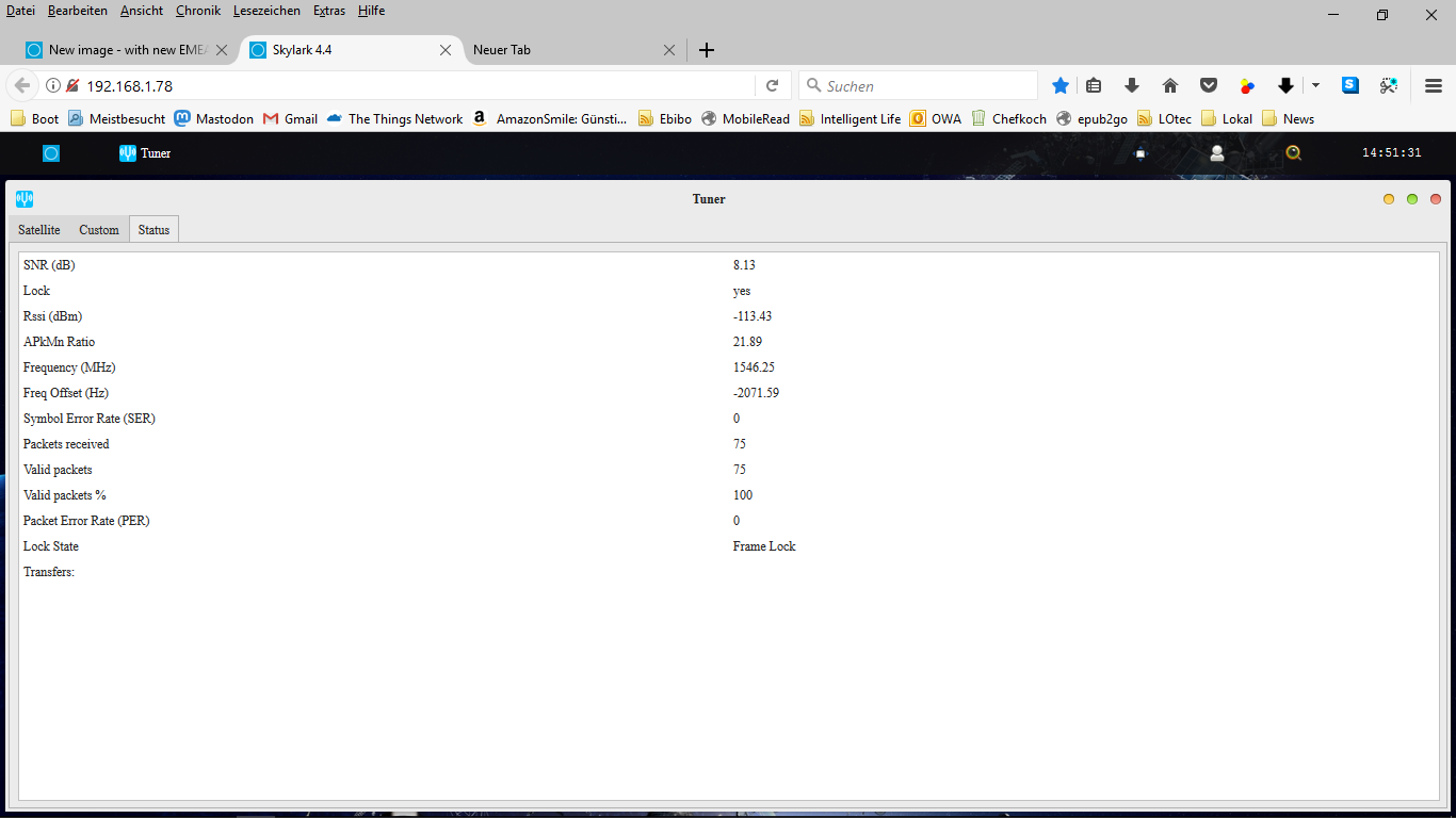

Changed frequency in the /etc/skylark_config.json and applied the satellite setting in the webinterface after that.
Got a few packets decoded already, but I need to readjust my Antenna to get a good Signal when i’m back from work.

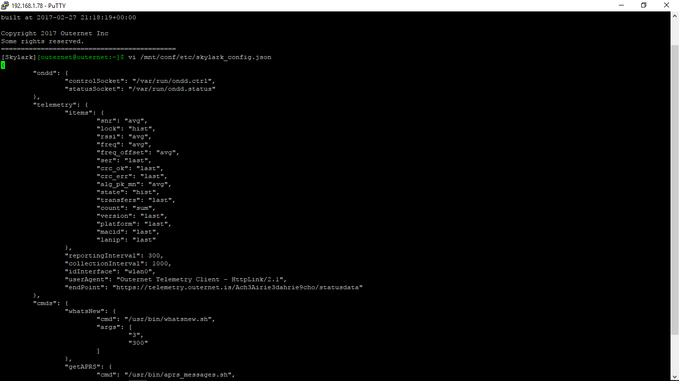

Proper workaround for changing Skylark frequency:
  1. connect by terminal to your Dreamcatcher
  2. open this config file with VI editor:
    vi /mnt/conf/etc/skylark_config.json
  3. Edit only the custom frequency and symbol rate setting (every other will change back on reboot)
                                "label": "Custom",
                                "value": "custom",
                                "freq": "1546.25",
                                "symbolrate": "4200"
4. Select "custom frequency" in tuner GUI in Skylark and click apply.

Hi Zoltan,
thank you for the quick answer. But I am using a CHIP -the config.json is looking somewhat different and I guess the frequency has to be changed somewhere else.
it should be the same, you just need to scroll down a lot, it’s settings is almost at the end
you can search in VI with this command:
/string search forward for occurrence of string in text
https://www.cs.colostate.edu/helpdocs/vi.html
but @Abhishek might advise on CHIP workaround

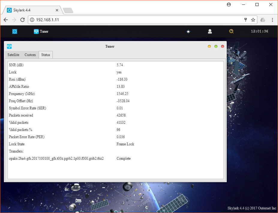

thank you, Zoltan, getting packets now:
Good reception in Belgium after changing the frequency, better SNR than before on the array antenna (7 dB SNR)
yeah, interestingly my SNR is increased to compared to the previous freq…
