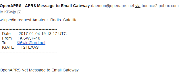

You can request a wikipedia page today via APRS using the email gateway to send an email request to request@outernet.is.
Send an APRS message to “EMAIL” with the recipient’s email address as the first “word” of the message. You may only send one line messages (67 total characters maximum).
An example is:
KI6WJP-10>APRS::EMAIL :request@outernet.is wikipedia request Amteur_Radio_Satellite
The request mailbox will receive an email that looks like:
The people handling the request email inbox will not be able to reply, They just need to add the requested wikipedia article to the carousel.
