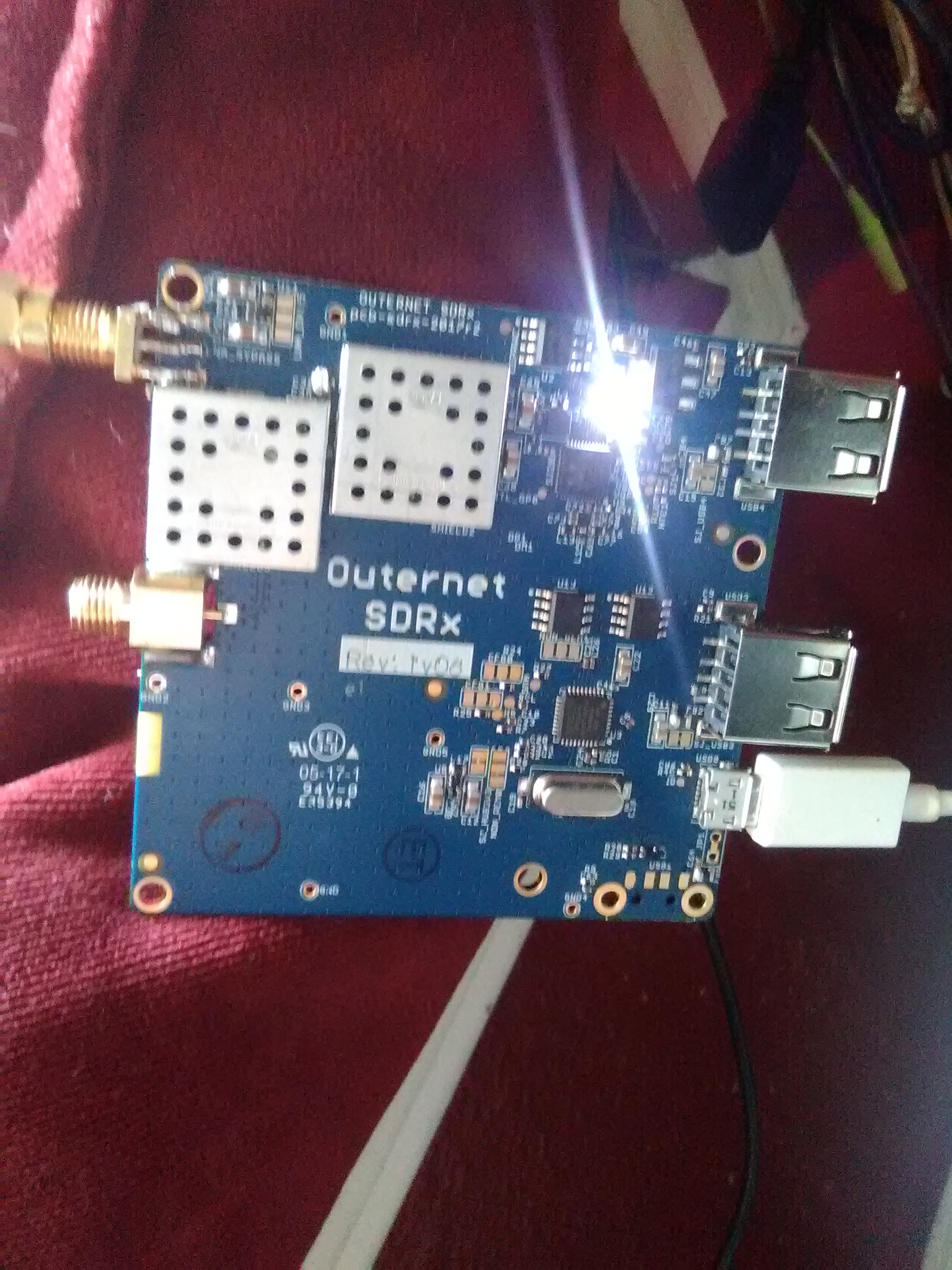

Guessing 1.07 based on another picture in that thread, but it may not matter if you find the same components in the same locations. @zoltan Can you comment on the lna bypass for the SDRx, those notes you have in the above link, does the hw version matter or still same procedure?
Right on… well im half way thu it. pop the sma. and getting ready to test it.

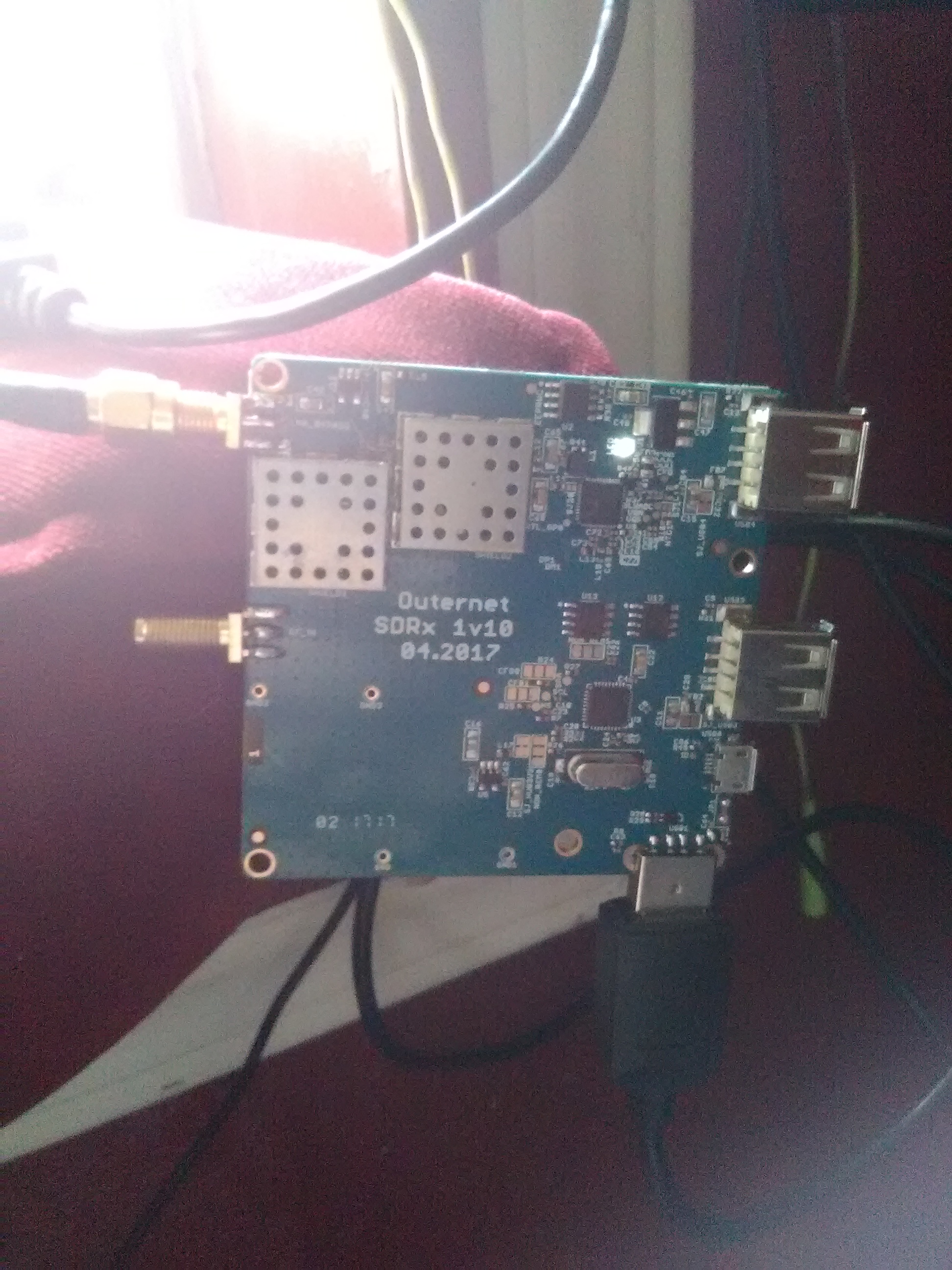

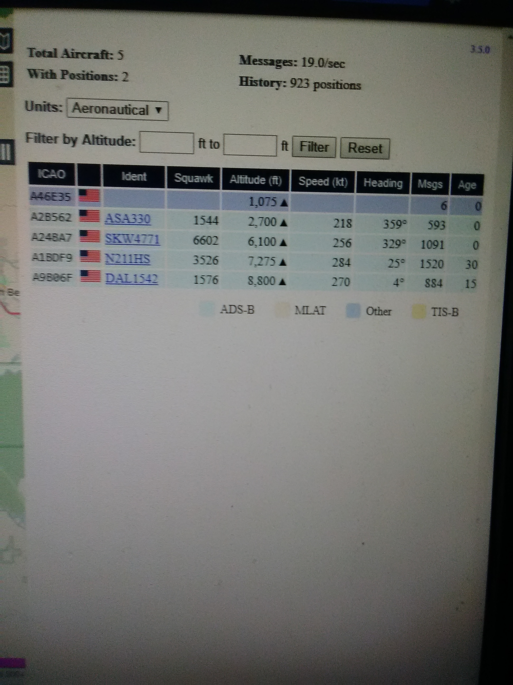

This is my results. Done on sdrx 1.10.

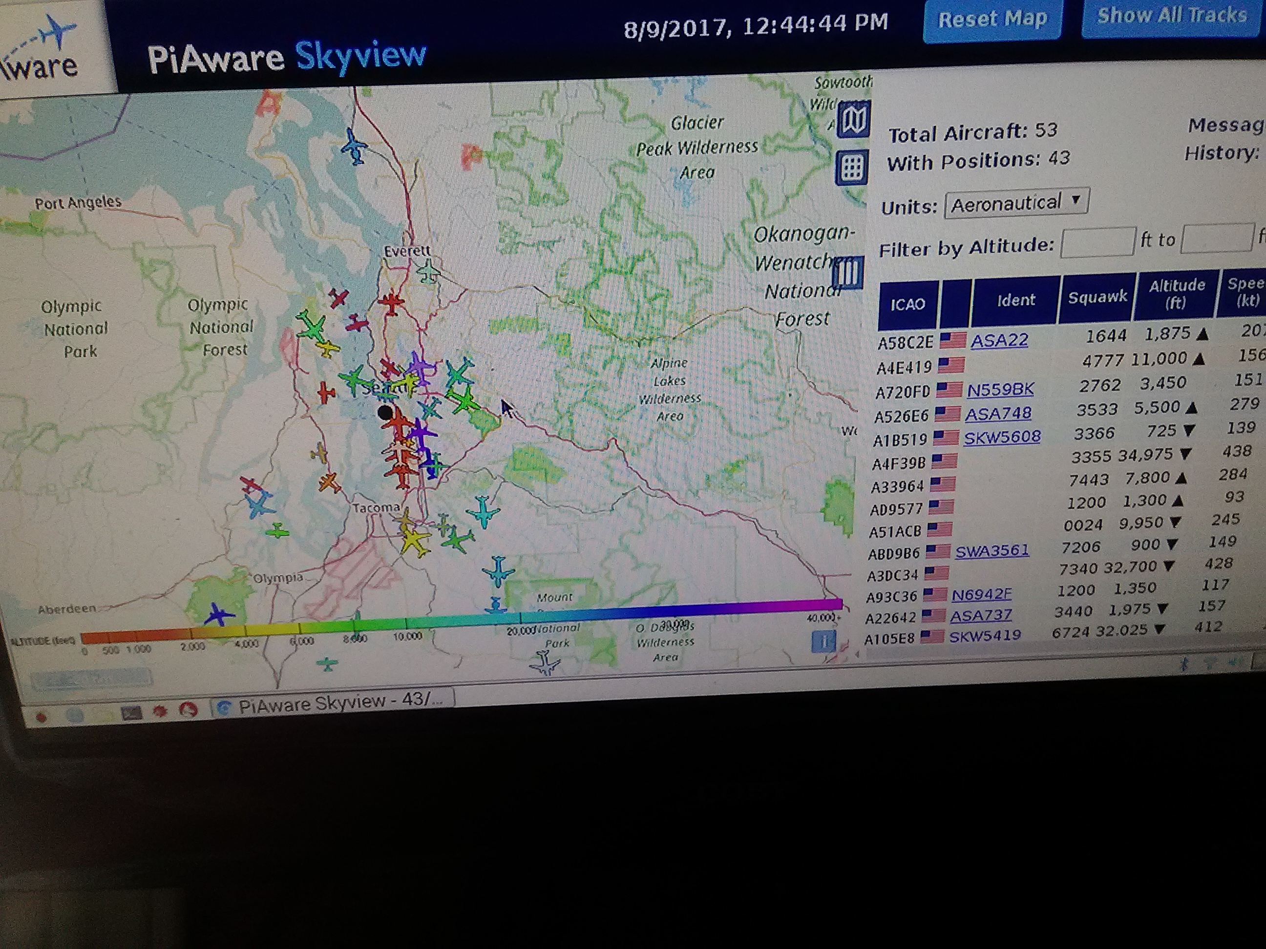

With a normal rtl-sdr I pick up about 45 aircraft. This is with the filters under shield still in tac. Next is to remove the filters I think and give it a try…
the later SDRx -es has non-removable shield which is a pain if you want to remove the capacitor from inside… this LNA_bypass feature was an engineering option for our own development not a users friendly mod so not so easy to do DIY style.
yeah the shield was a Mofo… going to test it today(v1.10)

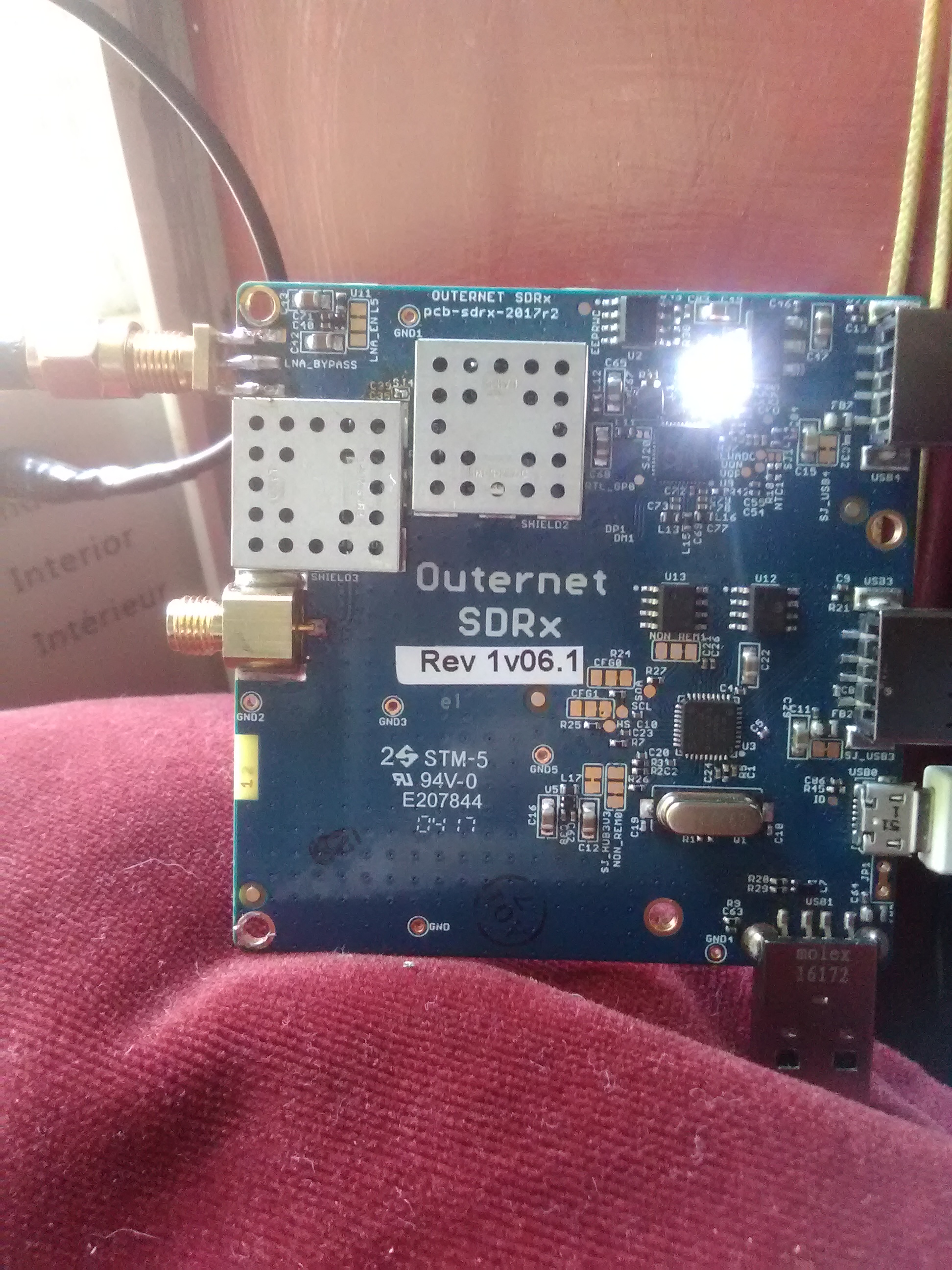

Here is the v1.06 and I must say… It’s reading 1090 better than my rtl-sdr.com SDR.

V1.10- fail not the best results. But it works. (Non removable shield) desolder a pain in the but for little results)

V1.06.1 works great. (Removable shield)
V1.06 works freaking great.(removable shield).

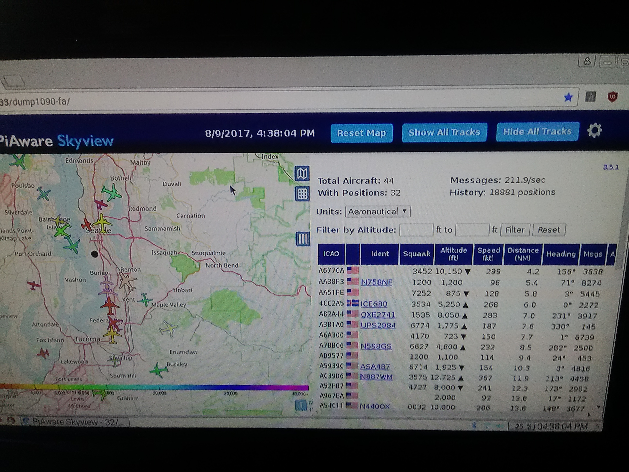

Well i been Running v1.06 for 5 Days Straight 24hrs a day.
Rpi3 - with Piaware - with SDRx on 1090Mhz - Max Range: over 300nms
Rpi3 - with Piaware - with RTL-SDR.com on 1090Mhz - Max Range: Just over 150nms
