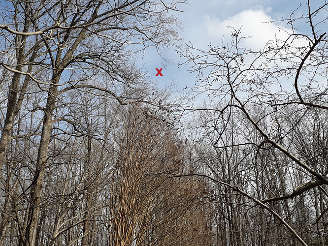

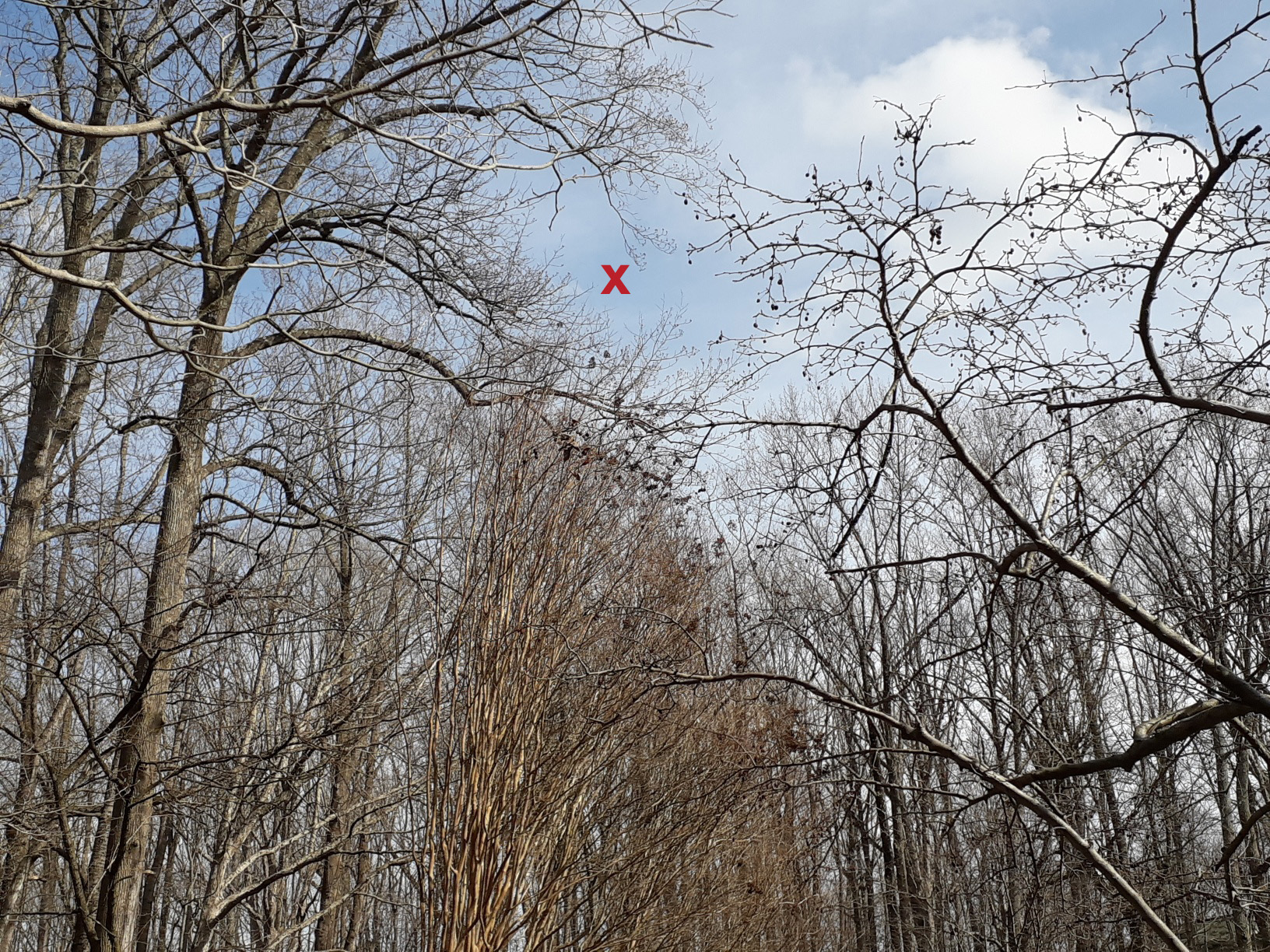

In any event, I have an obstructed view from my offset 80 cm dish, and will check it anyway - -
but I should be able to carry my portable out to a clear sky viewing area. My Elevation would be 18.6 deg, Azimuth (mag) 125.3, skew -45.1. Ken

Tested with offset 80 cm dish and I have no reception from SES-4. What are other test point results?
Will move to clear area tomorrow with portable unit. Ken

I did that, and did not see any FTA or encrypted signals either. Again, my view is obstructed and low like yours.
Tomorrow, I’m going to a clear area to see what I see. When I was in Hawaii last year, I had a very low look angel, but a clear sky view and saw SES-2 very well. Ken
