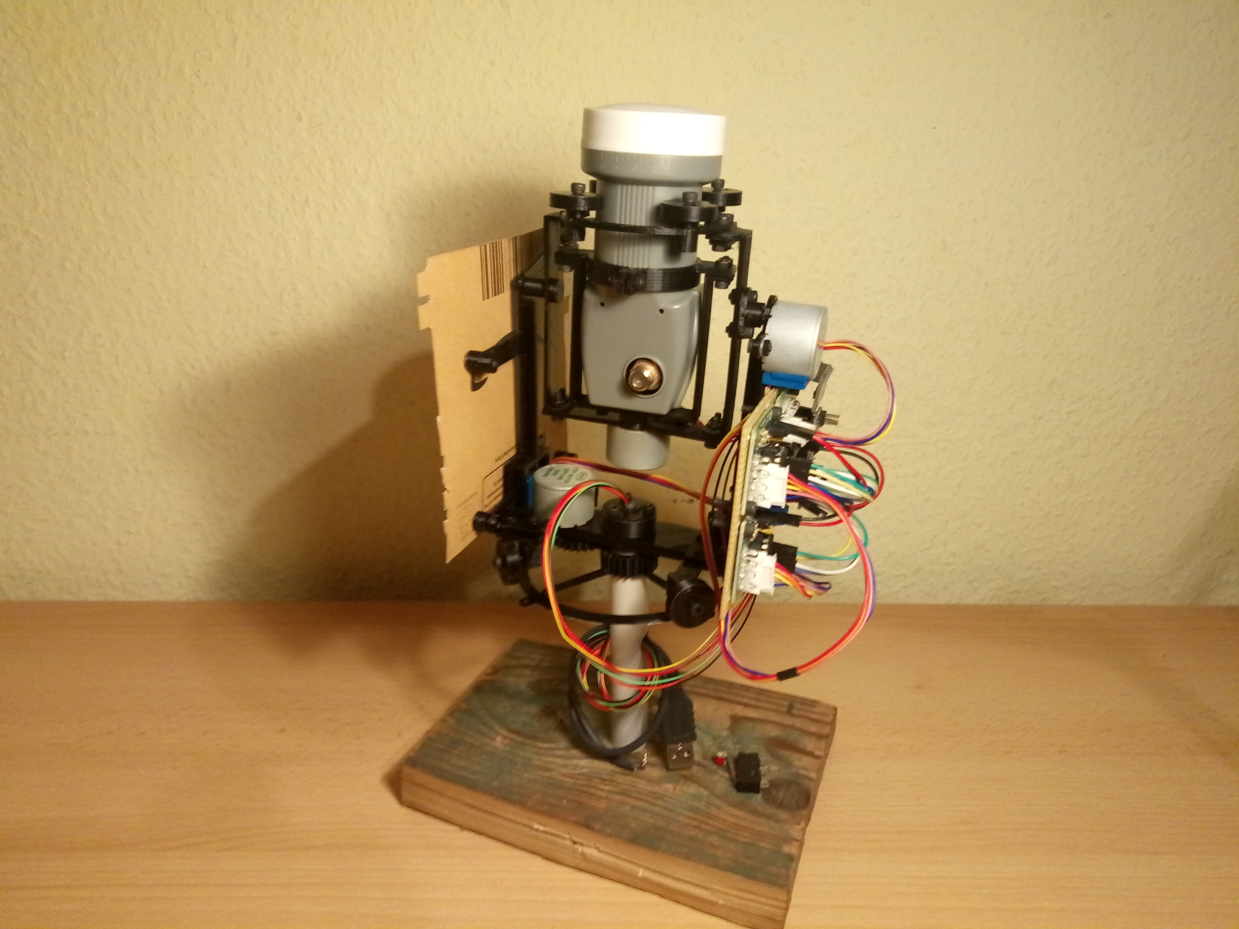

I recently found some time to think about it again. Here is a prototype I made: https://youtu.be/v-XJv–BX4Y It is a bit too slow to be mounted on a boat yet. But I think I am going to make a new one with some nema 17 motors. I have to say that I don’t know much about antennas or all the technical stuff around it. So your opinion about it and if you think this concept could work would be highly appreciated. Can I stack a dreamcatcher on top of the existing board? And will the motors or any of the electronics interfere with the antenna? @Syed can you already tell us the dimensions of the new product and when it will be available? And do you think I can mount the whole thing on an device based on this to point it to the closest satellite? And how are the chances I can use this to recieve actual grib files on my boat here in europe this year? Maybe when there would be a cheap antenna for boats and the possibility to get free weather forecasts it could be possible to get some help with the funding. e.g. the two big german boating associations pay a contribution in order for all pleasure craft to use the locks on the waterways for free.

Thanks a lot! And sorry, I am not that good in english ;-). I meant I would like to make a base for the new hardware that would point the whole thing in direction of the closest satellite. So actually a bigger version of this one which holds the new product instead of the LNB. But when you say it is a dome, does it mean, I will still have to point it towards a satellite or will it have some sort of omni-directional antenna inside? (just guessing by the dome shape).
And the skew adjustment should be easy to compensate by adding another stepper to turn the LNB. I will include one in my next design.
What i was still concerned about is the accuracy of the alignment. Do I have a margin of some degrees around all axes?
As to the water resistance. I’m planning to put a dome over the whole setting. As a first quick solution he lower ring on the device is supposed to hold the lit of a small bucket facing upward to put the bucket just on top of everything. But it should be possible to find a better solution for a weather-proof enclosure in later versions.

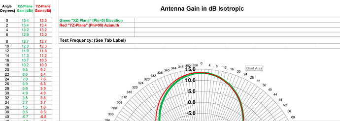

There is significant margin for error with the LNB. The horn on the LNB is the antenna, which has 13 dBi of gain and over 30-degrees of -3 dB beam width.
Probably the most sensitive axis is skew, but even that can be eyeballed.

I don’t have much time at the moment, but I am still working on my project and I will try to take it with me when I will be back on the boat at the end of march to test it. I added a new axis for the skew now as well as a mount for the dreamcatcher (a cardboard template so far). This week it will get its water proof housing. I kept the smaller motors because I think I will be able to still increase its speed by changing the code. And I already have azimut and elevation set for SES 4.

I did some work on my code and it seems to be ready now for testing it with the Dreamcatcher. Here is the current version in action: https://youtu.be/_3eXvr6Db7w

Thank you very much! The setup is running on 5 V from a small porwerbank. And I measured 0,5 A during operation using a USB monitor.
The elecronic parts are around 24 € + the board + wires + 3D printed parts + any bucket with a lit as the enclosure. So I guess the whole thing would be around 30 - 40 €.
A 360 or a course change would not require any user intervention. The unit can spin around more than 360° without messing with any wires, so I could even drive in circles. But a radical course change would interrupt the signal I guess when the motors are too slow to return to the correct azimut fast enough. But it will return on its own.
I want to use the feedback from the Dreamcatcher mainly to vary all axes a bit around the pre-programmed positions to check if that would result in a better signal and then reset it to the direction with the best results.

How do you deal with the coax connected to the LNBF? It appears to me that you have a great mechanical load to overcome that isn’t yet seen or addressed in your video. Great project, keep up the good work!
Thank you very much Jerry! You are completely right about that. This will still be a big issue to solve. I thought about using a longer cable and running it in big loops towards the Dreamcatcher. That should give me some more flexibility. But I’ll have to wait for that until I can add a Dreamcatcher to my setup.

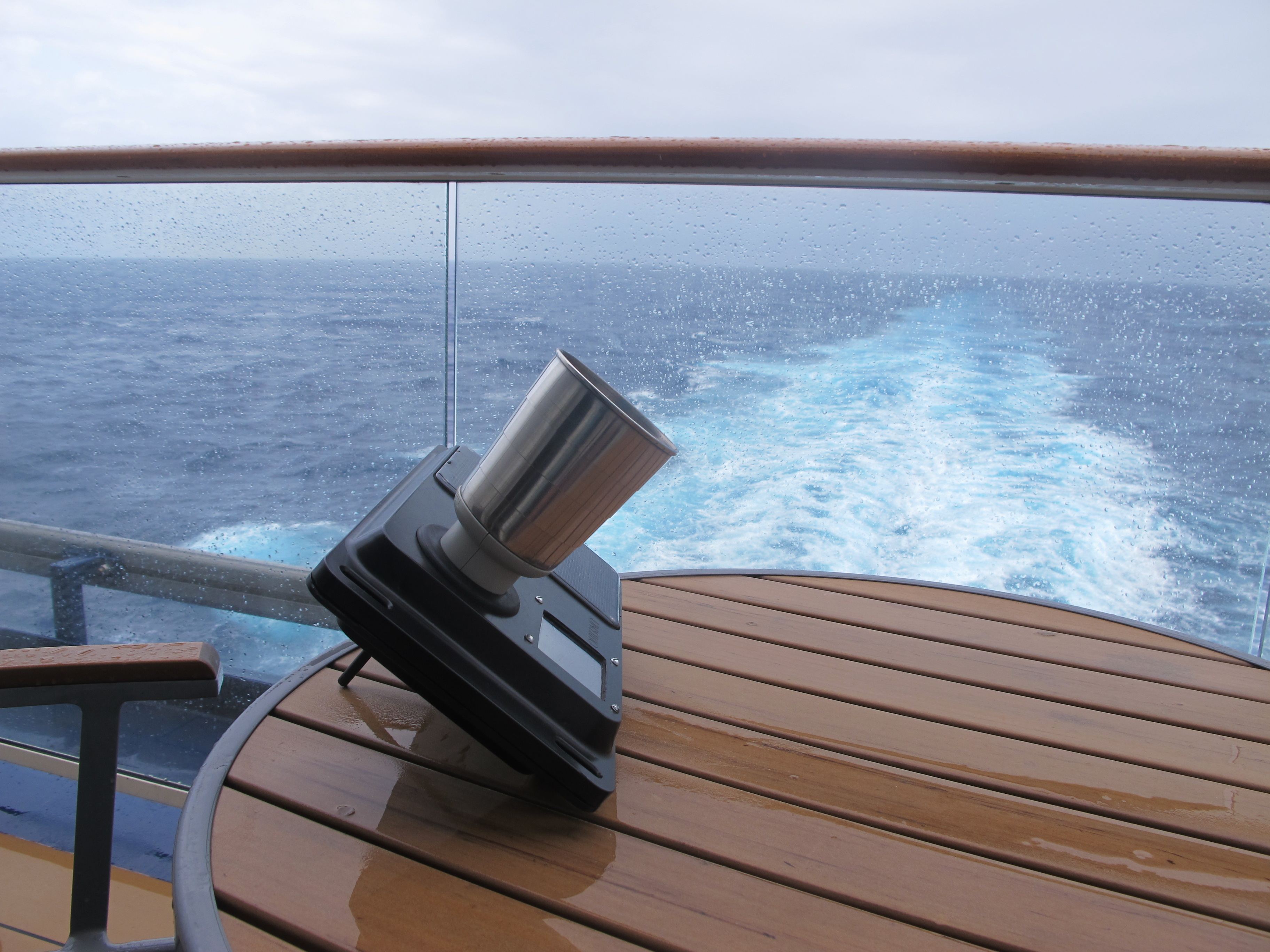

This week, I ran some tests North of Cuba in the Caribbean that provided reliable reception on the edge of SES-2’s coverage on a 126,000 ton ship. We were in 2 meter seas on a straight course.

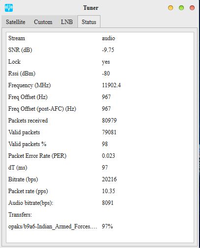

In my tests, I operated with an SNR of -9.75 dB, Rssi of -80dBm, bit rate of 20216 bps, and valid packets over 98 %. Audio worked fine. I could hold up the link for long tracks until the ship changed course by more than 30 degrees for periods of time between 4 and 6 hours.
Setting azimuth was easy using the true azimuth based on the ship’s course bearing. A course of 300 deg meant left (port side) faced 210 deg, right side (starboard) faced 30 deg, and stern faced 120 deg. That made it very easy to point to SES-2 at 220 deg.
What I found most interesting was the amount of azimuth change the LNB could tolerate - - up to 30 degrees. This test was performed closer to the equator with a higher elevation than we all normally use - – about 60 degrees which is high and may account for keeping lock with such a large azimuth change. Ken
