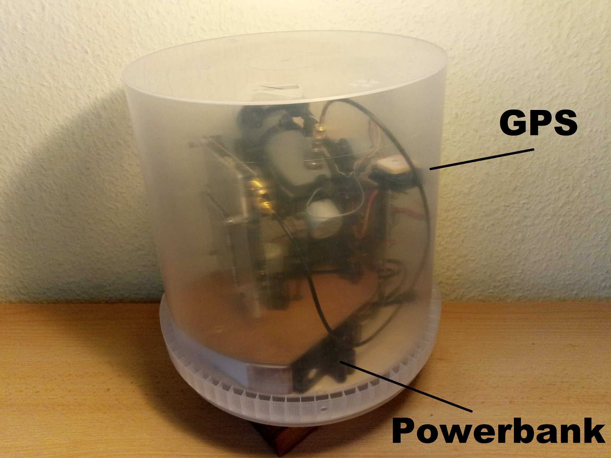

Here is my latest version. I added a second level. The tracker is sitting on the top now. On the lower level, there is a powerbank to power the tracker and the Dreamcatcher. And the tracker has a GPS now. So it can choose the closest satellite and calculate azimuth, elevation and skew for its current position. Everything still fits into my enclosure. So it is pretty much an autonomous unit now.
I am looking forward now to test it with the Othernet signal. @Syed do you already know when the european signal will be available? Is it still early September? I might be on the boat on Sept. 1st and could already do some testing then.

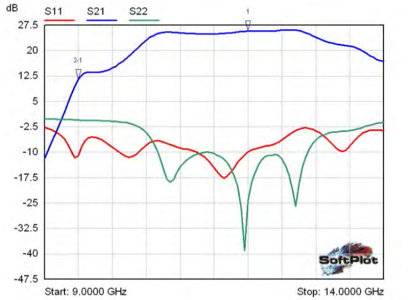

It is great to optimize for a ‘best’ frequency. This is more a topic for lnbf selection, but if the assumption of a typical global sources product for high band 10600 L.O. 11.7GHz-12.75GHz link to lnbf
The downside is the higher the frequency usually means the rf chips on the dreamcatcher will run hotter
It should be noted a vector analyzer plot usually looks something like this where there is definite “better” frequencies in performance
Would we need to put a heatsink on the rf chips? Or if the chip is in the rf sheld can add a peace of thermal compound / peace of copper to get the chip to make thermal contact with the rf sheid so that it acts as a small heat sink.
