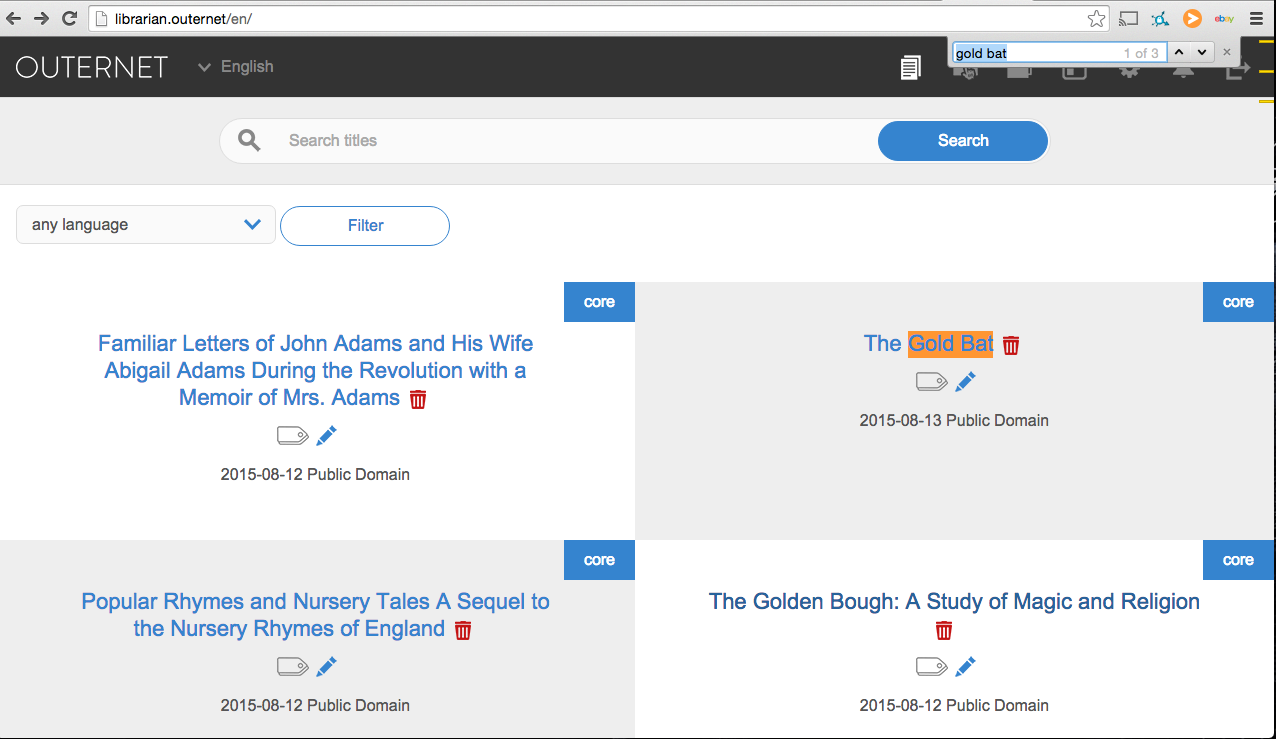

I did some further testing to make sure it wasn’t a fluke. I check what was the first article “the Gold Bat”. So i clicked load more until it reports there is no more content then did a keyword search for the first article and it found 3 copies.
