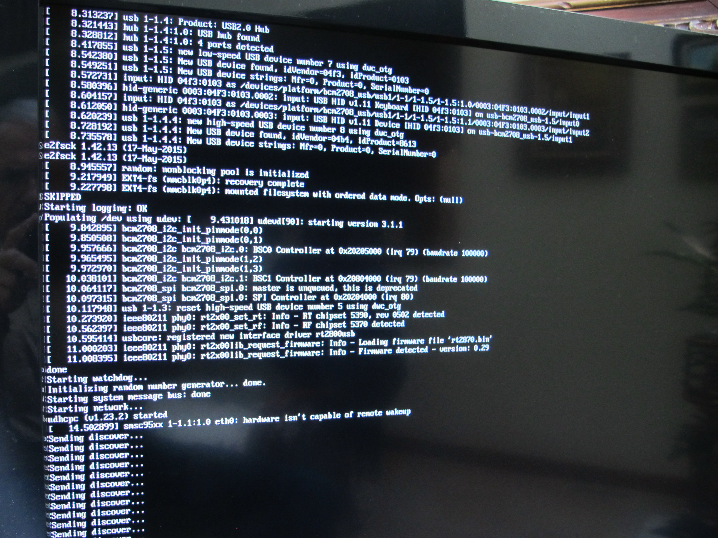

Here’s a picture from my TV monitor of the Raspberry Pi boot up:

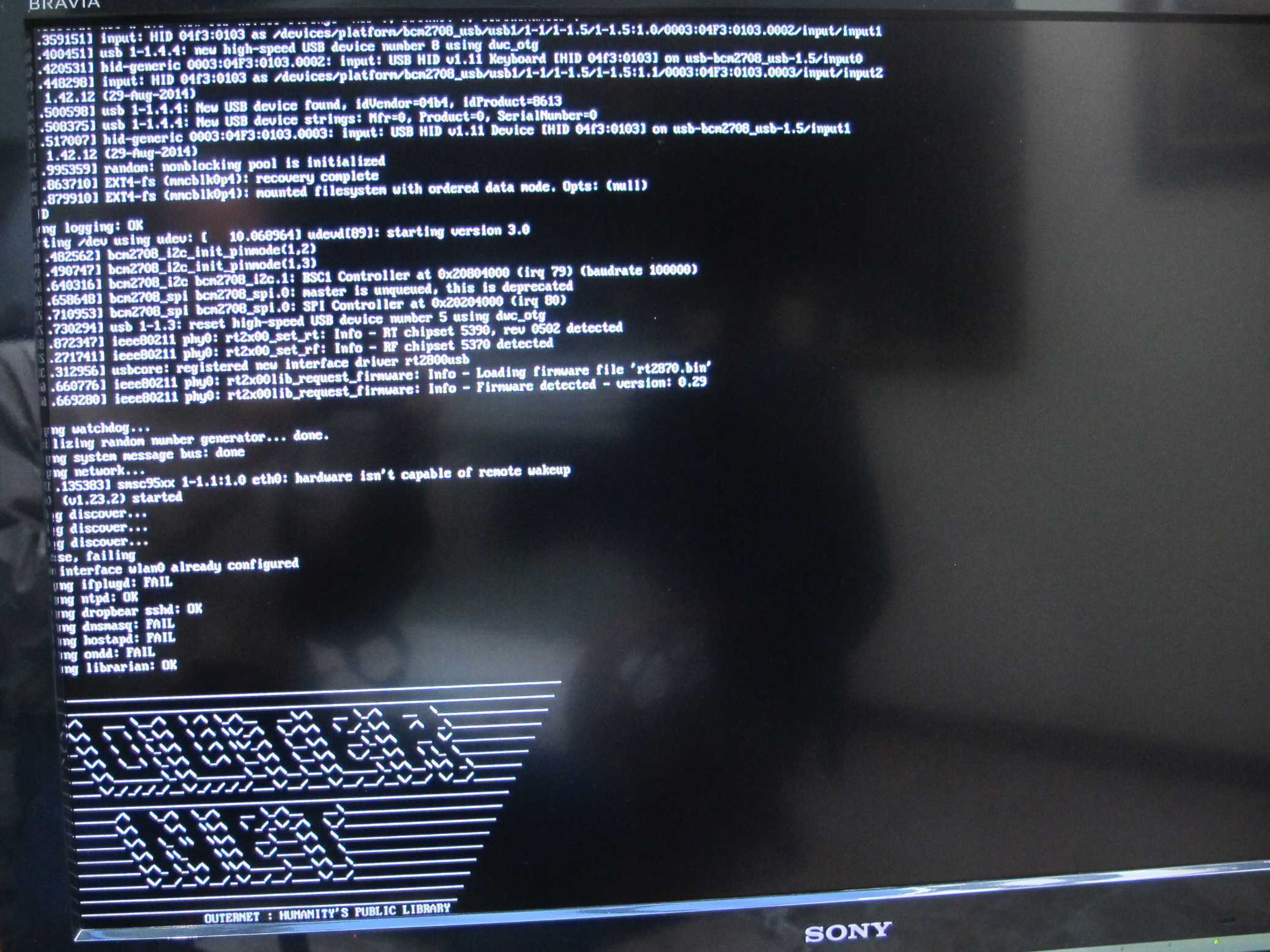

I should have said the previous screen reflects the ORxPiv0.2.4
Following is a screen picture of the ORxPiv0.2.7 boot up.
I can’t get past the last line of the boot up routine. I have made an image on an 8 Gbit and 64 Gbit SD chip and they both perform the same. Ken
It is not easy to make a remote diagnose. Without network connection you have limited possibilities to document the error messages. I propose to login on the “console”, using an usb keyboard, (login:outernet/pwd:outernet) and check the init log, it is the dmesg output. You can use the less or more command to read it page-by-page:
dmesg | less
You can try to take more attentions to the messages about the config of the wlan0 interface.

I can’t get past the last line of code on boot up " sending discover". Unable to get to the Pi’s login screen for Outernet. Ken
I see. I’ll do some testing over the weekend to see where we’re at.
Sorry it took a while. I believe the issue @kenbarbi was experiencing should be fixed in 0.2.8 hotfix. Please give it a try and let me know if it works for you.
