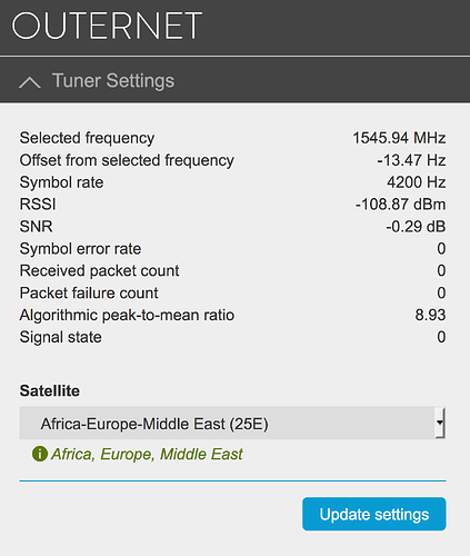

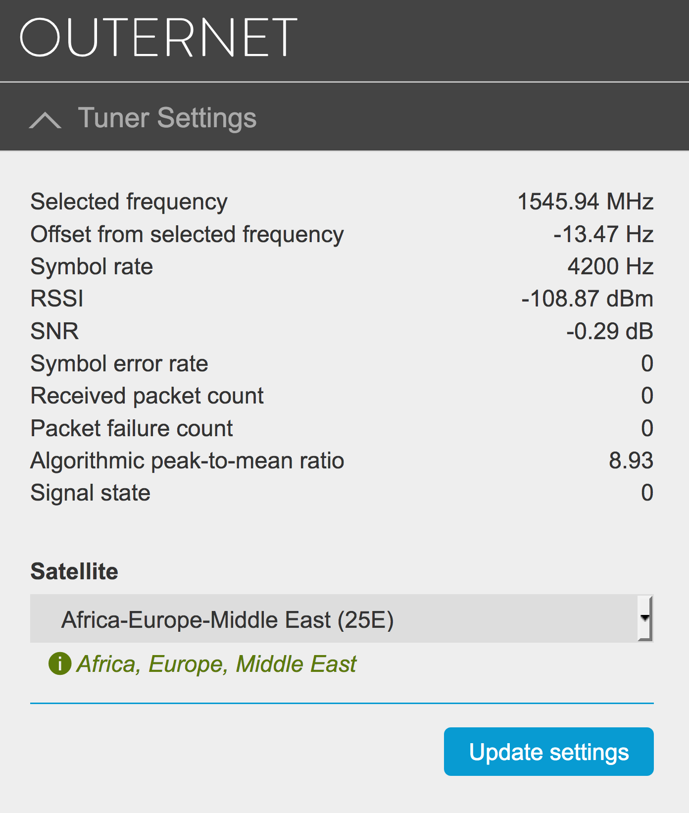

I have attached a print screen of rxos (rpi3 + RTL-SDR + Antenna with Integrated Amplifier on LNA_BYPASS → SNR = -1.5 to 0.5).
Any clue how should I approach this to find what’s going wrong?

what’s your actual RSSI value?
The one you posted looks a bit high “-108.87 dBm” perhaps you had some local interference / wrong frequency setting?
I usually get RSSI like -114 dBm

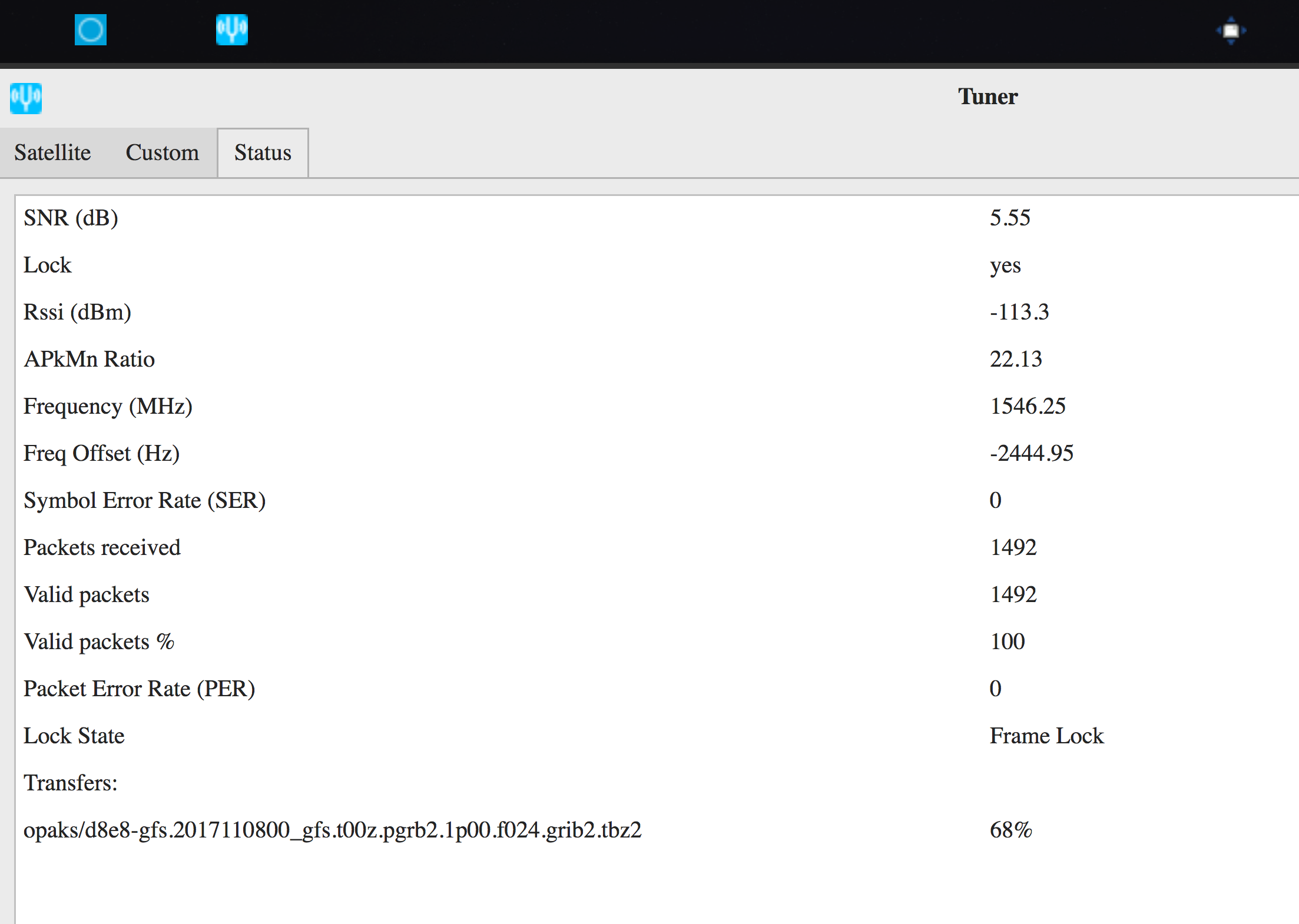

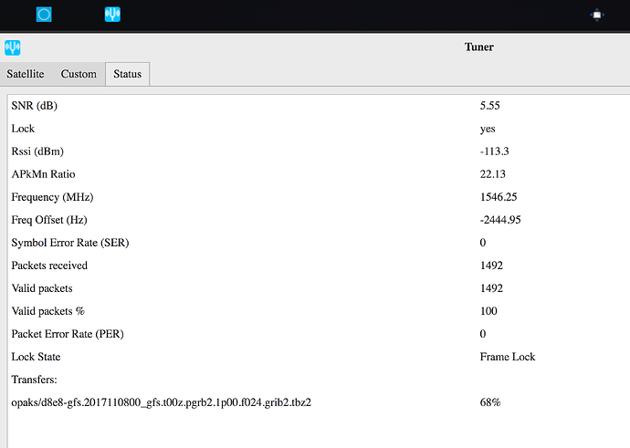

Thanks Zoltan, but as i said above it’s working now.
I think it’s because when you change the antenna setting you need to reboot after, not just apply?
Below are my readings now.
