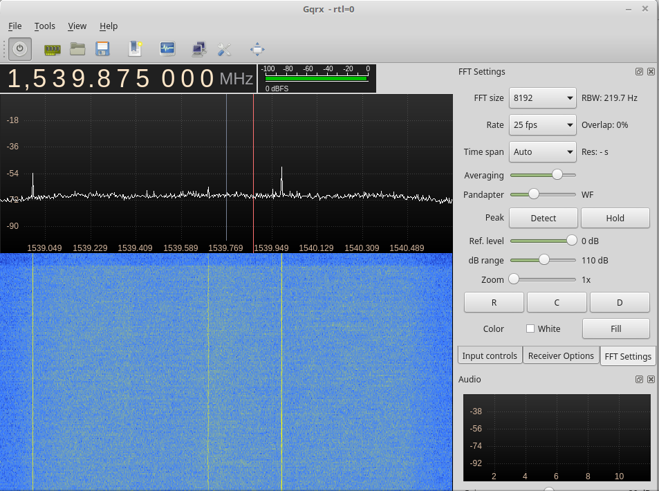

This is Gqrx running on a NooElec SDR-RTL dongle, a bias Tee, the NooElec LNA/Filter and the airgap patch antenna. Notice there’s no signal exactly on 1539.875MHz, the Outernet frequency here in the US. The actual signal is the one slightly to the right. Some programs can calibrate out that offset due to imprecise LO frequency.

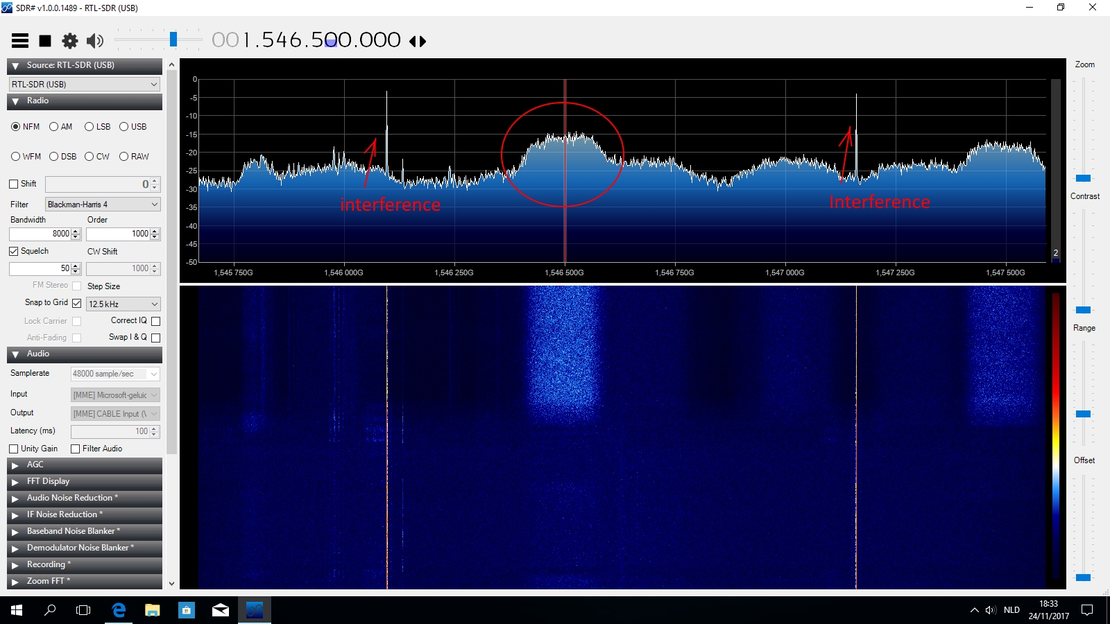

  • When I connected the SDR + antenna to my laptop with SDRsharp, I saw these 2 peaks as I mentioned before but after disconnecting my antenna from the SDR, the peaks were still there, so must be interference
  • However, now I could discriminate a strong signal at 1546,500Mhz when I pointed to the satellite → See attachment. That looks good, right?

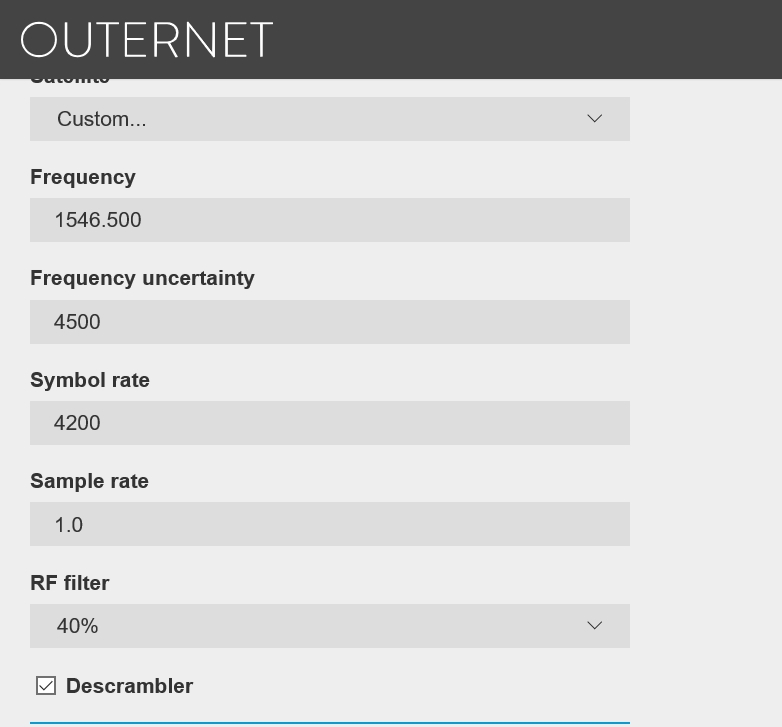

  • Could you also verifiy if all settings are OK? See included image
My settings

@Syed @Konrad_Roeder could anyone of you could please check if my settings are OK or not? I live in Europe so the Alphasat is the one that I want to tune in to. As you can see in the screenshot of sdR-sharp, it seems that I have a good signal, but my raspberry pi does not recognize a signal.

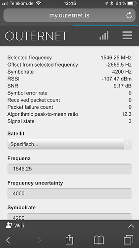

I do have the same kind of problem here in Germany and would be very grasteful for any help. I use the Outernet passive antenne, the Outernet SDR L-Band RTLSDR. Obvioulsy I do have a very good SNR (about 9 dB s. screenshot) ), but do not receive any data at all.
What am I doing wroing?
73
Willi.
Hallo Willi,
You are in Europe and are trying to tune Alphasat on 1546.25 MHz.
This is the correct frequency.
You actually have a very nice signal.
Very good SNR – greater than -110 dBm is great. (these are negative numbers)
Very good RSSI – greater than 5 dB is great.
See the Signal State? It’s not 4 for some reason.
The problem is that it’s not decoding.

Hallo Konrad,
thanks for Your reply.
I simply forgot to tick the descrambler-box and additionally to save the changed configuration.
This is one of the typical newbie-mistakes.-:]
Now it is up and running.

Yes, of course without descrambing, there won’t be any decoding. It was set in Willi’s configuration.
Incidentally, descrambling is not decrypting, but undoing randomness that was added to the signal to prevent certain sequences to be sent in the middle of the message eg. the sync pattern.
