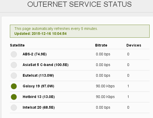

What Branko was saying was that there is a bug in the client where it will not register as receiving.
So, occasionally it is possible that 113W and ABS-2 show as receiving from time to time and it’s equally possible that the one receiver on G19 could be any one of Syed’s, Ken’s, or my receivers. Also i believe both Andrean and Branko are on HB13, so there should be two if not more there as well.

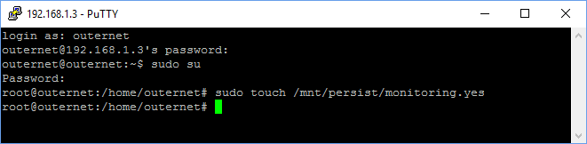

There’s a good chance the monitoring has to be activated on updated boxes. In future we’ll add a setup step / settings panel which allows you to toggle it.
Activation of monitoring has to be done like so:
sudo touch /mnt/persist/monitoring.yes
im sorry , yes i did not run the comand :smiley_cat:

I noticed the status page on 17 Dec 2015 0710 EST (1210 UTC) is not current - - I presume the time posted on the page is in UTC

Monitoring still not updated on Wiki STATUS. It is still at: 2015-12-16 10:04:54
We’ll let you know when the new server is deployed.
